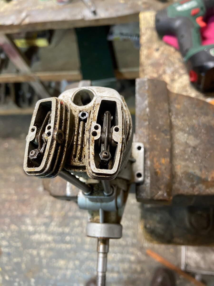

A friend has given me two ancient examples of this motor. The better one has freed up easily and I have actually got it running. Unfortunately the thread for the exhaust manifold is almost completely stripped and I can’t get it to hold in place. Thus I want to change the head to the one from the other engine.
As far as I can make out, the rockers are on a separate casting which has to be removed to give access to the head bolts. To do this the actual rockers have to be removed by taking out their pivot pins. These seem to be held in place by a grub screw which you can see next to the hole for the inner cover securing bolt
i have removed one of these but can’t seem to drift out the pin even with the use of a hammer. I have tried in both directions. Any suggestions where to go from here please?

Unfortunately I don’t have the kit to make an insert like that. However I have done the next best thing. I found some two thou shim, cut a strip, wrapped it round the manifold and screwed it in. It seems to be holding on the remains of the thread but time will tell!
I found a YouTube video showing dismantling this engine and it suggested the use of heat. I got my hot air gun out and freed those pins quite easily
