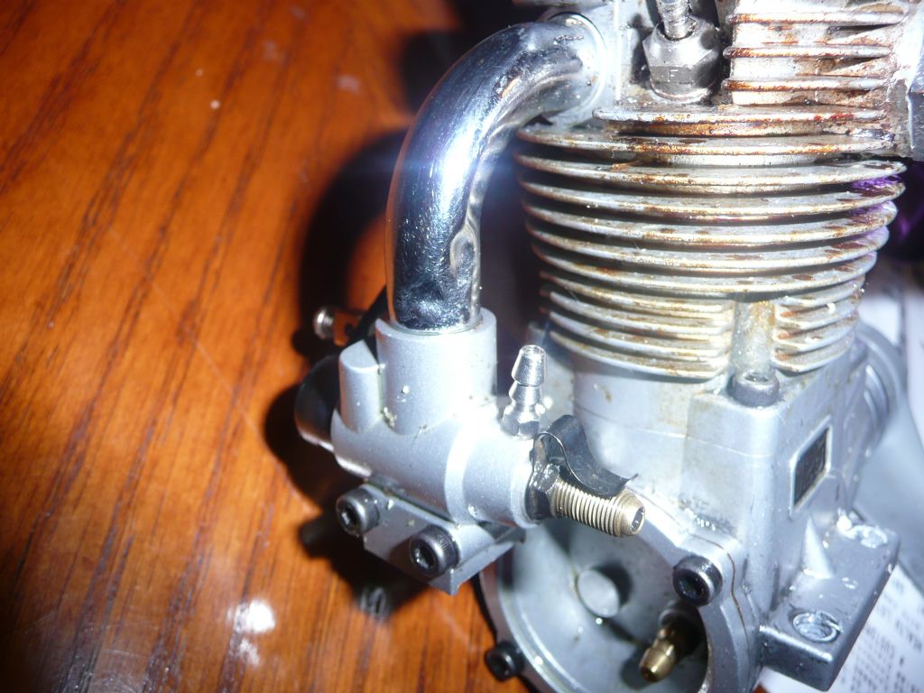

Phil 9 Posted March 19, 2012 Author Share Posted March 19, 2012 looks like the inlet manifold is dented and does not seal properly. bought it from ebay and was described as a good runner Quote Link to comment Share on other sites More sharing options...
Alan Cantwell Posted March 19, 2012 Share Posted March 19, 2012 clean it off at the joint with meths or something, anything to degrease the thing, seal it with silicone, then have another go, hope you didnt give him good feedback Quote Link to comment Share on other sites More sharing options...
Phil 9 Posted March 19, 2012 Author Share Posted March 19, 2012 Posted by Alan 4 on 19/03/2012 21:35:32: clean it off at the joint with meths or something, anything to degrease the thing, seal it with silicone, then have another go, hope you didnt give him good feedback already left feedback (what a mug) a new manifold is about £22 so I think I will get one. still a little frustrating Quote Link to comment Share on other sites More sharing options...
Alan Cantwell Posted March 19, 2012 Share Posted March 19, 2012 try sealing it first, you may be wasting money. Quote Link to comment Share on other sites More sharing options...
Phil 9 Posted March 19, 2012 Author Share Posted March 19, 2012 ok cheers Alan Quote Link to comment Share on other sites More sharing options...
Alan Cantwell Posted March 19, 2012 Share Posted March 19, 2012 the sealant is only a temp measure, also check the gasket under the join to the head, if its gone, bit of paper made into a gasket, and soaked in oil will make a good seal, while we are at it, check the tappet gap, should be .025-.1mm check this at TDC, Quote Link to comment Share on other sites More sharing options...
