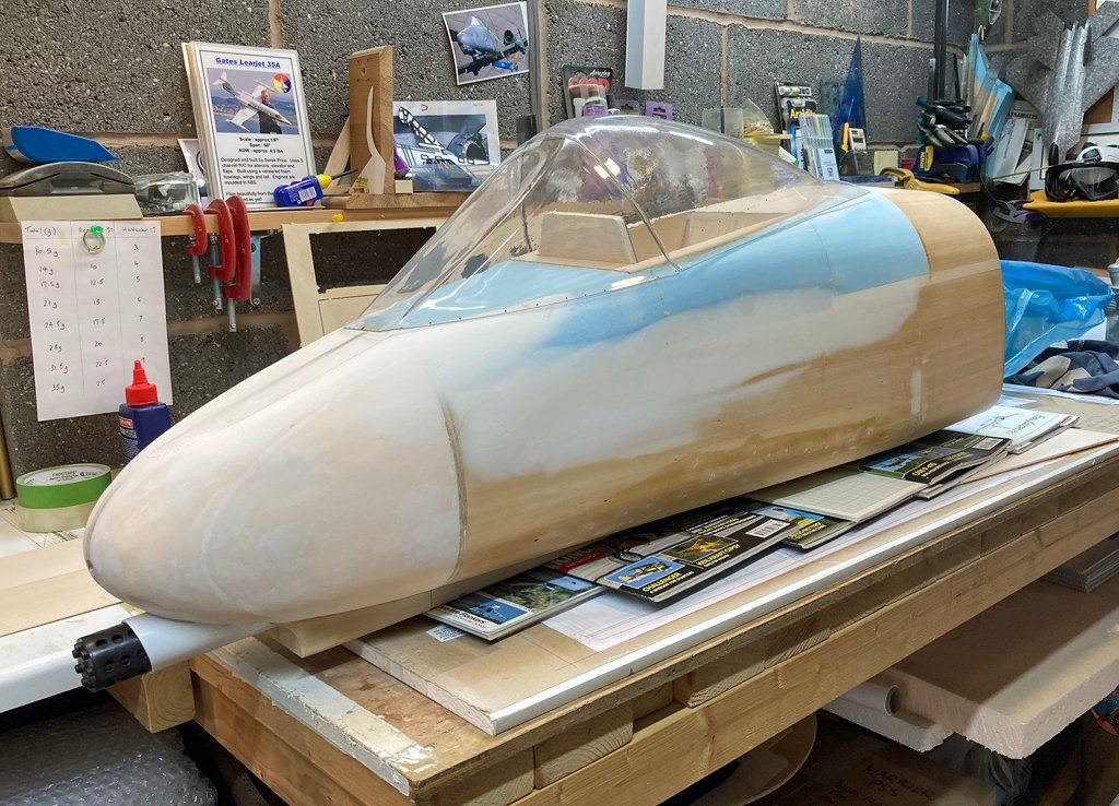

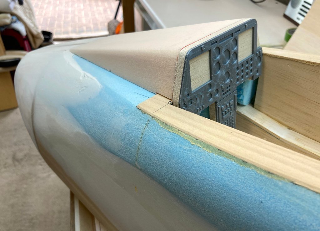

A bit more progress on the A-10 now the season PSSA flying season is over... still working in the cockpit and nose section getting it all ready for glass.
The 2 piece canopy has been better trimmed up to suite the more shapely blue foam shoulders and a console has been made up from pink foam.
It all seems line up ok - I think the seat is still a little reclined, the pilot and seat need to be a little more forward and upright for scale looking at photos of the real thing...

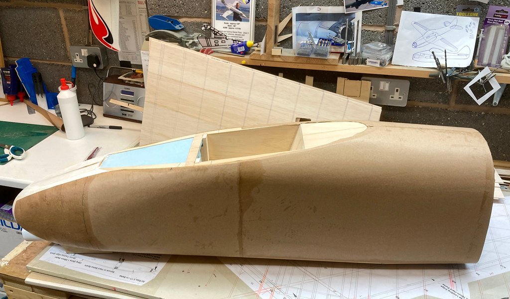

I've then covered the nose section in brown paper and PVA, sealing the exposed foam and giving a better surface onto which the glass cloth and resin will be applied.  The paper has come out pretty well, a few overlaps around the complex curved surfaces of the nose need to be sanded back before the glass gloth is added.

Yeah only the nose section requires paper as its the only part of the airframe with exposed, shaped foam.  Thats the reason I've applied it to build a beter foundation for the glass.  The rest of the airframe is all veneered so glass cloth and resin alone will suffice.

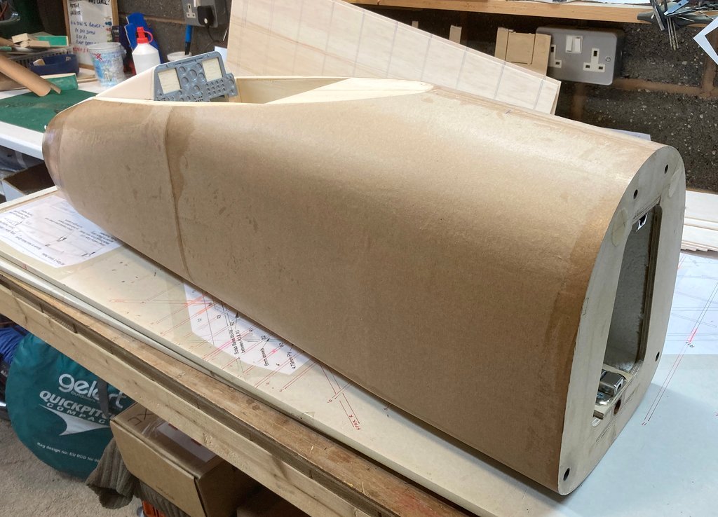

I've managed to get some A-10 glassing done over the Christmas period - the nose section is now ready for final sanding and primer as are the fins, rudders, elevators, ailerons and flaps.
Started with some fiddly glassing around the battery hatch and gun housing.
Then the underside, keeping the seams and resultant overlaps on the radiused corners.
The dark patches are where there isn't enough PVA on the surface of the brown paper and it starts to soak up some of the resin...
Top section again with the seam position marked on the tight radius for ease of blend.
The final piece!  A small foam roller was used on the bigger surface areas once the cloth was laid out with the Jenny brush - very effective and leaves a nice even resin coat.
