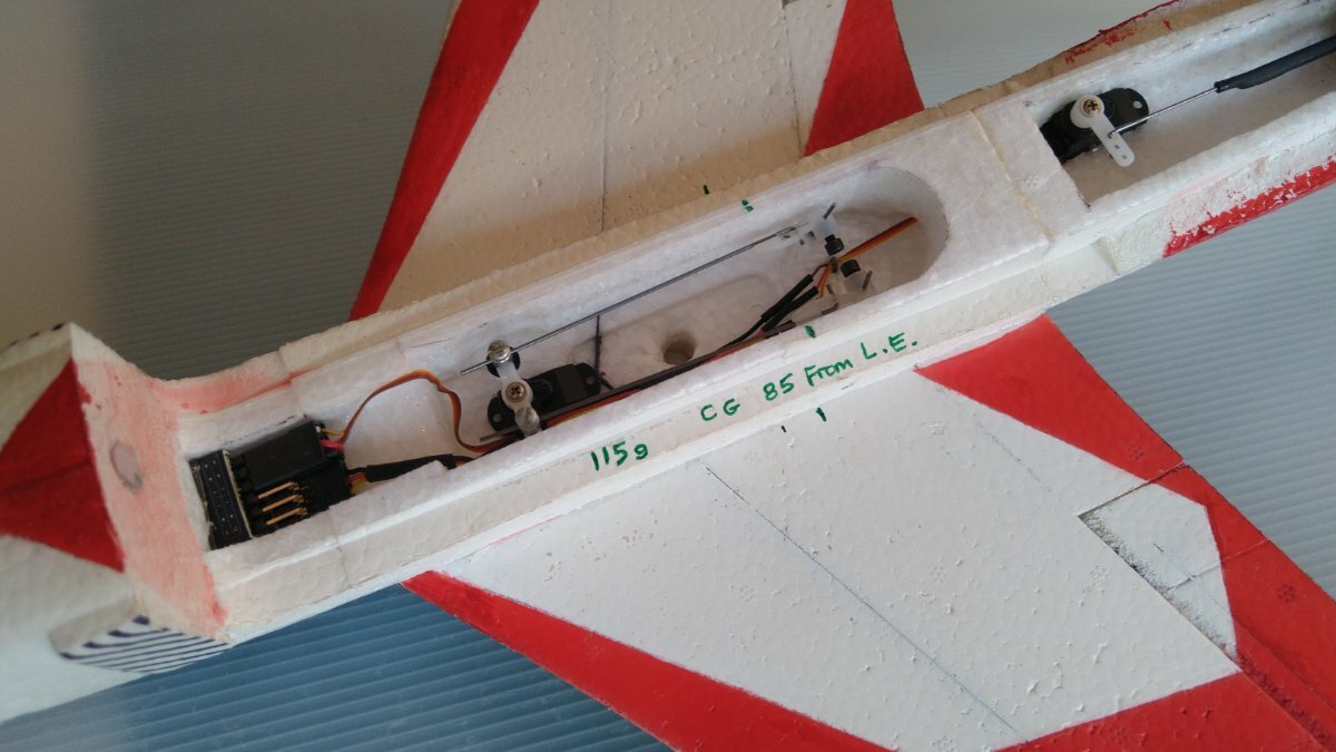

Saint 1 Posted August 13, 2022 Share Posted August 13, 2022 Well I had a great time flying my Alpha Jet at the Orme last weekend with PSSA online but I had to move my CG point back some way before I had it flying nicely. I had to dispense with the two nails and move my lipo back by 20mm to end up with CG being 85mm from the leading edge. As a bonus the AUW is now down to 115g. Can't wait for next time 🙂   1 Quote Link to comment Share on other sites More sharing options...

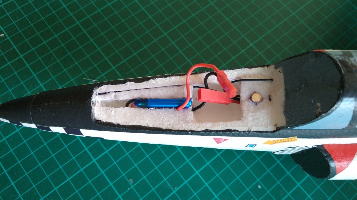

Peter Garsden Posted October 26, 2023 Share Posted October 26, 2023 I have just finished my German Oldbury Something or other version   Interesting that Phil's C of G is 85mm - mine is 78mm but I have lead in the tail to balance that and I am at 139 grams which is a bit heavier - mind you lots of paint on this one. Maybe I could have done the flashes in waterslide - could have been done. Maiden at the LMMGA Comp, hopefully, this Sunday - looks like Edge Top to me. Anyone tries these in 15mph winds, which is the forecast? 4 Quote Link to comment Share on other sites More sharing options...

Saint 1 Posted October 31, 2023 Share Posted October 31, 2023 Lovely choice of colour scheme Pete. Looking at Sunday's maiden flight I think I would look at moving the CG rearwards a little if you can, ideally without adding even more weight in the tail. Are you able to relocate any of the radio gear further back at all? Quote Link to comment Share on other sites More sharing options...
