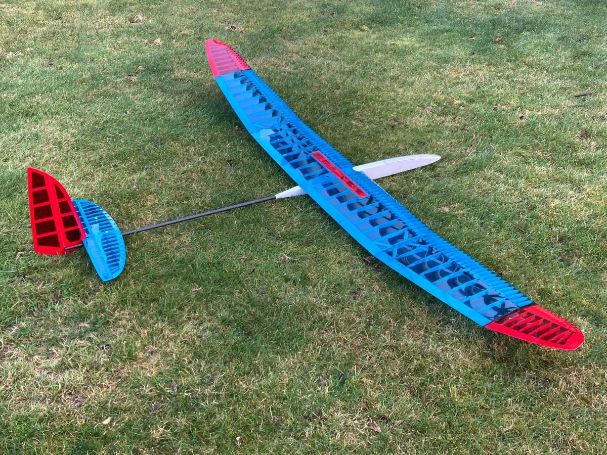

Smoggie Posted October 22 Share Posted October 22 I just built my own Slite V2, maidened it today with no drama. I wish I'd found this thread before the build as it would have saved me some head scratching over a few details, the photos in the (German) build instructions are tiny and hard to make out. Only thing i changed was I lengthened the tail boom slightly, as to my eye it looked a bit short coupled. I used a 95mm offcut of wing spar tube and a joining sleeve from some tapered carbon tube I had in my spares box. The longer boom means more tail volume so allows a more rearward CG (83mm from LE) so I dont think it needed any more weight than normal to balance. 1 Quote Link to comment Share on other sites More sharing options...
