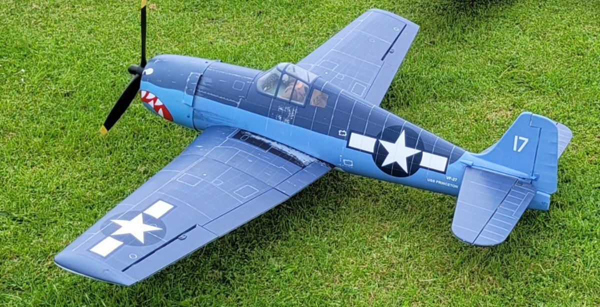

Paul Johnson 4 Posted May 20 Share Posted May 20 (edited) Gordon I have a 5050 580KV running a 16x8x3  4S 4000mAh on a 62" 11lb Hellcat and gives good scale performance for a 5 minute flight. Edited May 20 by Paul Johnson 4 Quote Link to comment Share on other sites More sharing options...

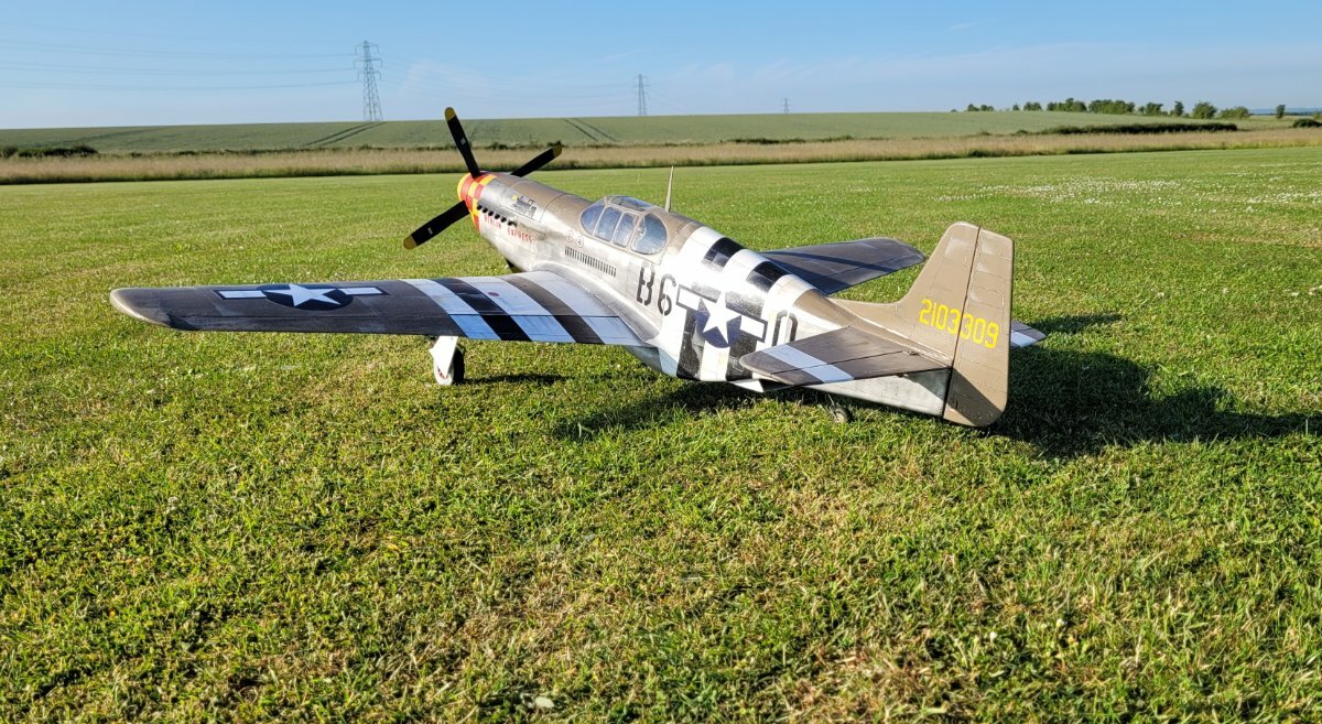

Gordon McConnell Posted May 22 Share Posted May 22 Paul, thanks for the reply. My P51 weighs 2.81kg. The 4S 3350mAh battery is 292g in addition giving a 3.1kg flying all up weight. Alternatively, I have been using a 4S 4250mAh battery at 411g.  Quote Link to comment Share on other sites More sharing options...
Paul Johnson 4 Posted May 22 Share Posted May 22 That's about the weight of mine and she flies well with a 4 blade. 2 Quote Link to comment Share on other sites More sharing options...
Paul Johnson 4 Posted May 22 Share Posted May 22 Also has a fixed tailwheel and ground handling is good. Quote Link to comment Share on other sites More sharing options...
Paul Johnson 4 Posted May 22 Share Posted May 22 Out of interest this is the 11lb Hellcat flying on a NTM 5050 580KV using a 16x8x3 and a 4S 4000mAh battery 5 mins flying time. 1 Quote Link to comment Share on other sites More sharing options...

Paul Johnson 4 Posted May 23 Share Posted May 23 An interesting thing about the P51's ground handling was that the tailwheel was castering for taxi and steered by differential brakes, but then locked by pulling back fully on the stick for take off so our fixed setup does mimic the real one. 1 Quote Link to comment Share on other sites More sharing options...
alan p Posted May 23 Share Posted May 23 Due to circumstances I have sold my Mustang on to a club member, Built and set up as per Richard's instructions. on 4s. Maidened by new owner, comment from friend observing was "Flew like a dream" Nice one👌 Richard well designed. 1 Quote Link to comment Share on other sites More sharing options...
Gordon McConnell Posted May 24 Share Posted May 24 Interesting point Paul. It does make sense to design the P51 tailwheel steering that way. Free castoring at low speed for ground manoeuvres during taxy and fixed to prevent large swings during take-off. Pulling the stick back for take-off keeps the tailwheel firmly planted on the ground until flying speed is reached and the stick returned to near neutral. Quote Link to comment Share on other sites More sharing options...
