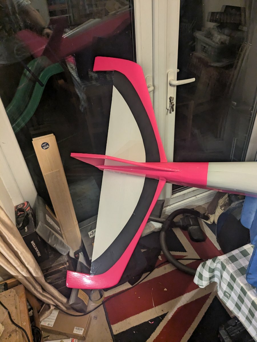

payneib Posted December 7, 2024 Share Posted December 7, 2024 Took a break from sorting the kids rooms to get the side trims on. Officially filing this job under, "things I did not enjoy". In the interest of saving on covering I'm going to try and do horizontal strips on the rudder, using the big pile of offcuts. 2 Quote Link to comment Share on other sites More sharing options...
payneib Posted December 23, 2024 Share Posted December 23, 2024 Got the tail feathers finished today, after several weeks of festive upheaval keeping me off it. I was going to glue the hinges today, but that'll have to wait until after Christmas now - I need to get the dinning room cleared. Left to do: Cowl to paint, canopy to fit, fancy polishing work on the U/C and spinner, new control horns, new pull/pull on the rudder, and the new tail wheel to fit. Then hopefully I've enough covering left for the wings. 2 Quote Link to comment Share on other sites More sharing options...

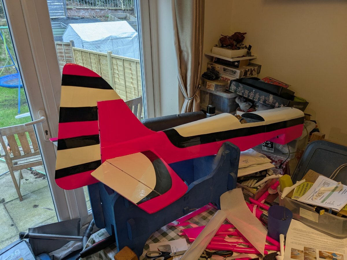

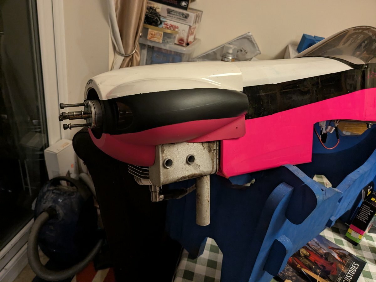

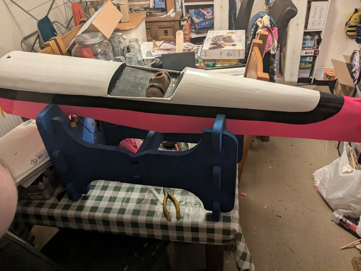

payneib Posted February 1 Share Posted February 1 It's been a while, but I've finally managed to snag 5 minutes to myself. Tail hinges are all glued, tail wheel is on, radio switch is remounted, canopy is on. I just want to mix up a little bit laminating epoxy tonight, to seal round the edges of the covering on the firewall, then hopefully I can cut and colour the cowl in a day tomorrow. Bolt the wheels back on and chuck it back in the garage whilst I do the wings. 1 Quote Link to comment Share on other sites More sharing options...

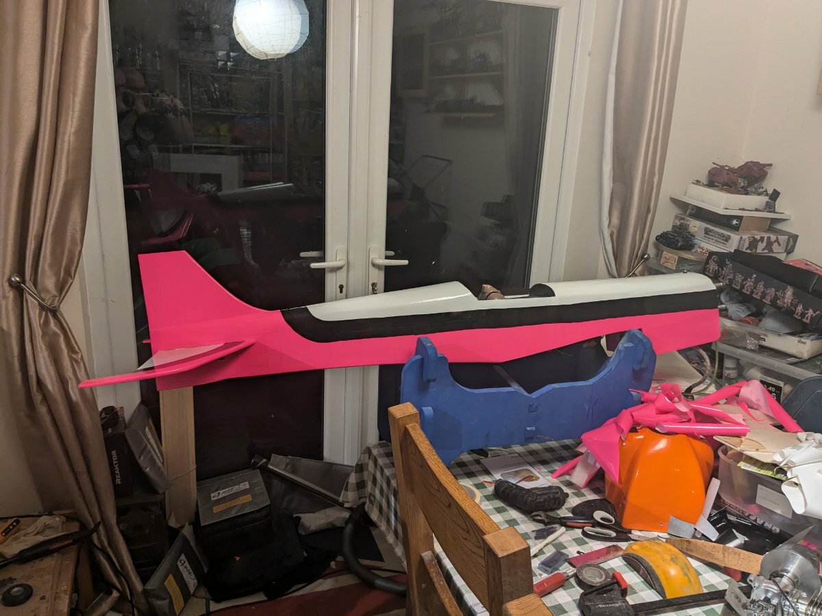

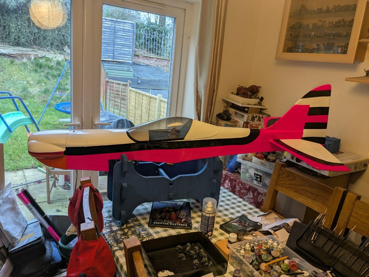

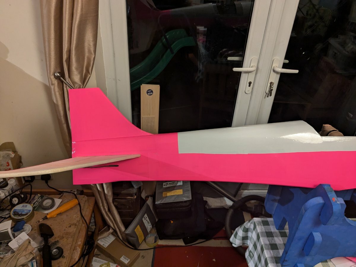

payneib Posted February 2 Share Posted February 2 Cowl cut and coloured. Pink doesn't quite match because I gave it too many coats and it darkened out slightly, I'll not lose any sleep over it. Unfortunately I finished too late to get the gloss coat on, so that'll have to wait until next weekend now. 4 Quote Link to comment Share on other sites More sharing options...

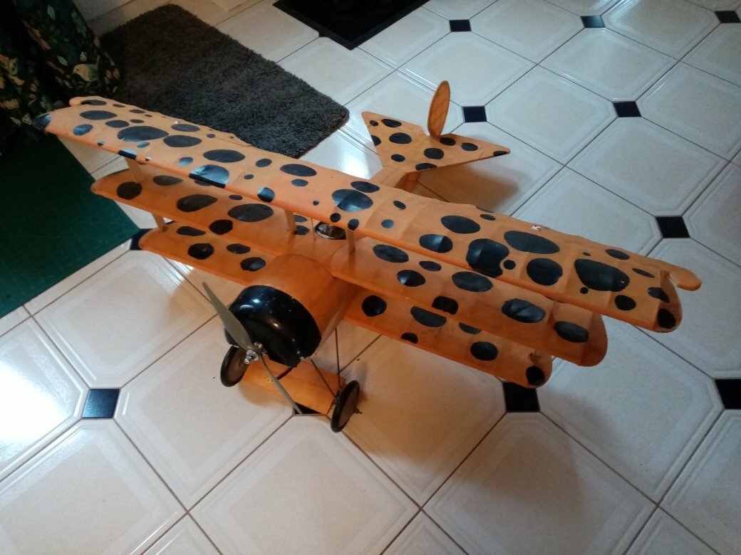

martin collins 1 Posted February 3 Share Posted February 3 Nearly ready to test fly now, couple of small jobs to fiddle with tonight and then Baron Von Spottydog will be taken to the strip on Wednesday for a test flight. Balance looks slightly nose heavy which i am fine with for the first flight, once the model gets repainted it should put the balance a bit more rearward. Running it on a 4s Lipo, i may have got away with a 3s and larger prop but we will see, feels a bit porky with the 4s 4000mah in, the airframe itself feels ok, it does have three wings so we will see once it is in the air. 5 Quote Link to comment Share on other sites More sharing options...

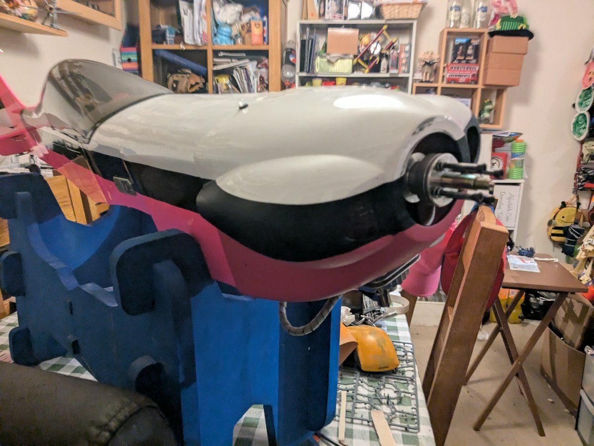

leccyflyer Posted February 4 Share Posted February 4 Finally got to the painting stage on the wee Deacon Beaufighter, In the end I decided to go with glasscloth and EzeCote for the wings, to give a bit of protection, since she'll be landing on the nacelles. The fuselage is tissue and EzeDope, whilst the tail surfaces are laminating film, so a bit of a mixture. Paint is B&Q Valspar sample pots, thinned and with a dash of Floetrol and went on very nicely in no time. Final fettling on the peanut butter jar cowls was a bit fiddly, but all worked out in the end. I left the painting until after that stage, so that I could see the anchoring points through the clear plastic. 3D printed air intakes and hand crafter Porcupine exhaust stacks are yet to be fixed onto the cowls. 11 Quote Link to comment Share on other sites More sharing options...

martin collins 1 Posted February 5 Share Posted February 5 Baronette successfully test flown today, now the weather needs to warm a few degrees so i can get a scale scheme painted on it. 5 Quote Link to comment Share on other sites More sharing options...

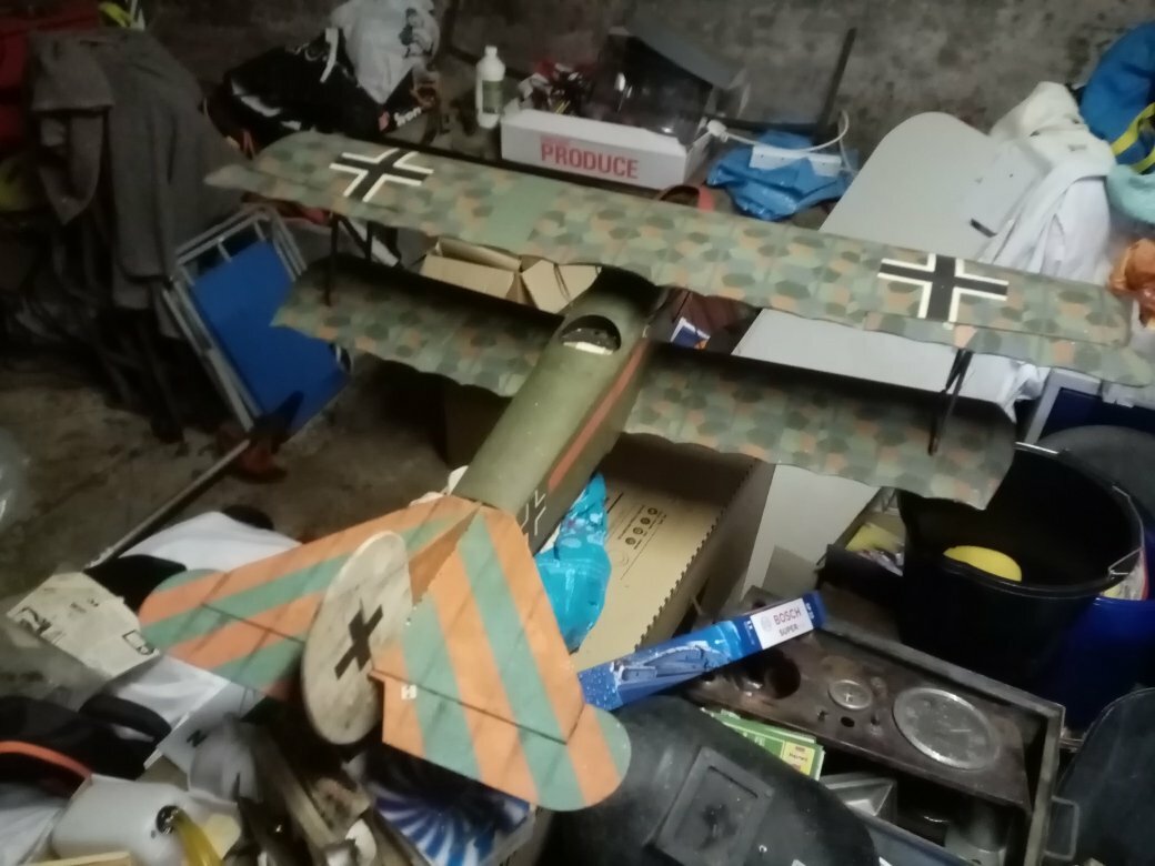

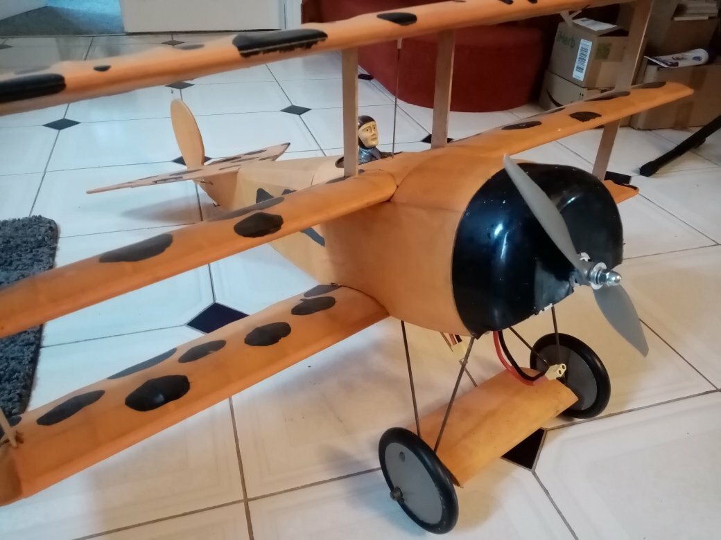

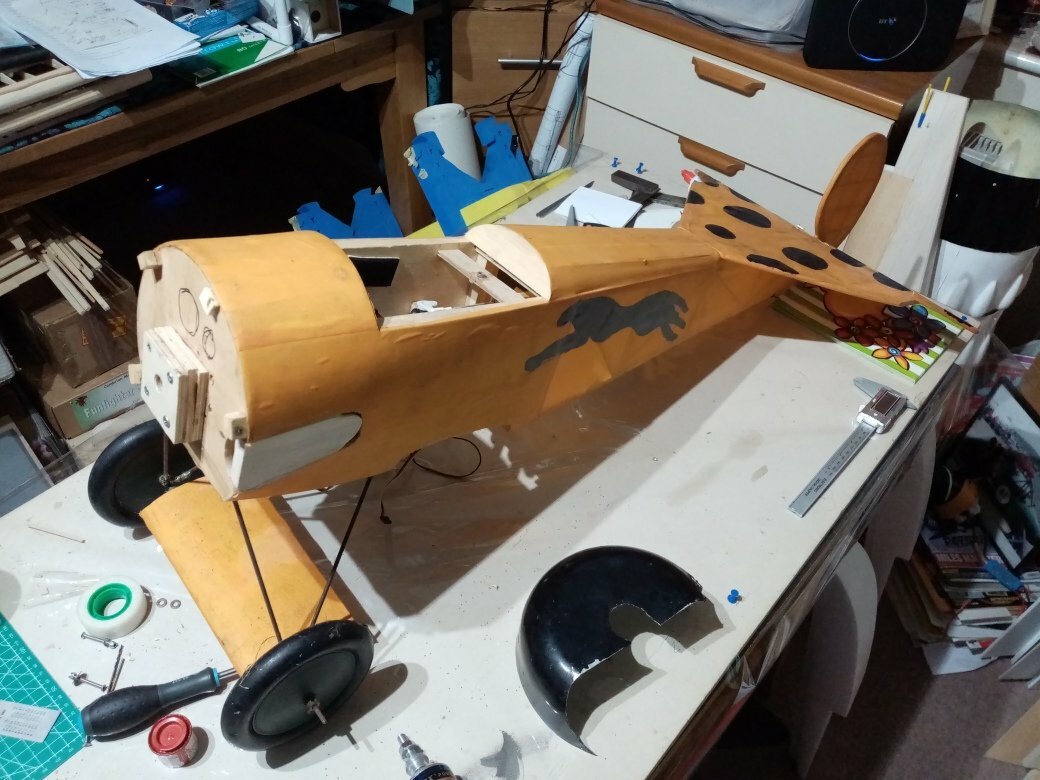

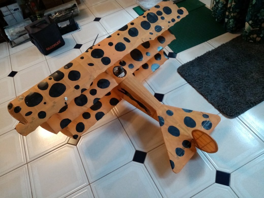

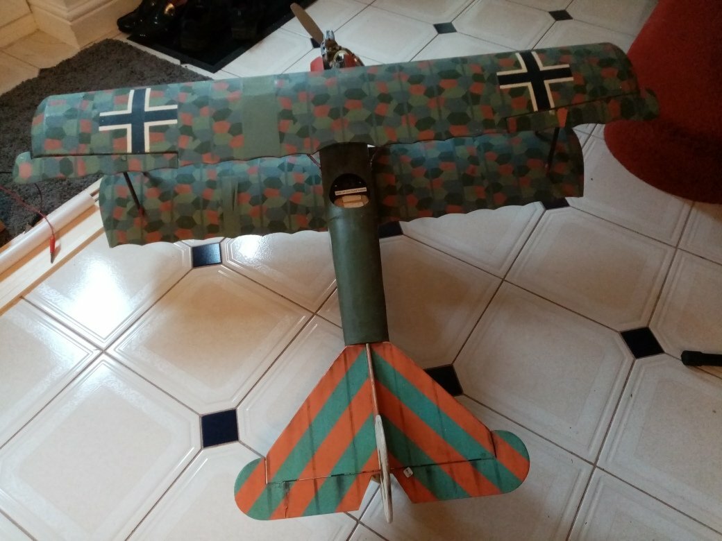

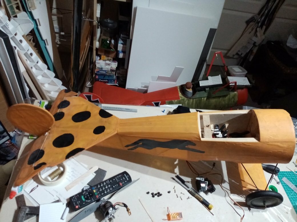

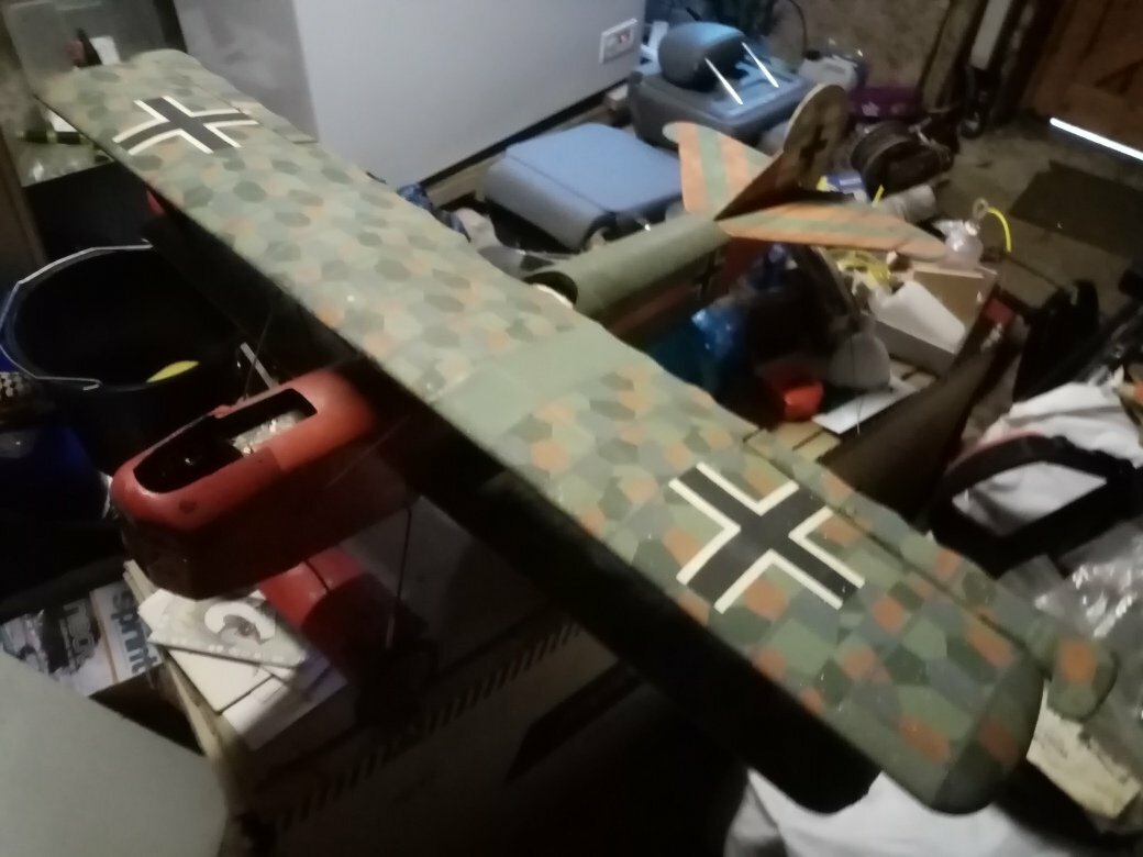

martin collins 1 Posted February 8 Share Posted February 8 (edited) Having got my Baronette airworthy and now just waiting for warmer weather to paint it i have pulled out another Dark nights fix up model, this is a 50" span Fokker DVII. I bought it about 6 years ago at a local Swapmeet, it was pretty grubby then and even more so now as it has been hanging in my barns since purchase as it looks good but needs sorting out to make it useable again. Obviously not a Flair one being too small and it looks like the nose might have been extended, it certainly needs shortening to make it more scale. I haven`t pulled it apart yet to see what is involved in shortening it, i may just leave the nose as is as i`m hoping to pick up a larger Flair one to put my Laser 70 in to, certainly i will be aiming to just make the current covering good as i love the lozenge finish. It will get replacement servos, tank and probably a 48 or 52 four stroke engine, hopefully in the air in the next couple of weeks. Will take some better pictures once it is outside for clean up and dismantling. Edited February 8 by martin collins 1 1 Quote Link to comment Share on other sites More sharing options...

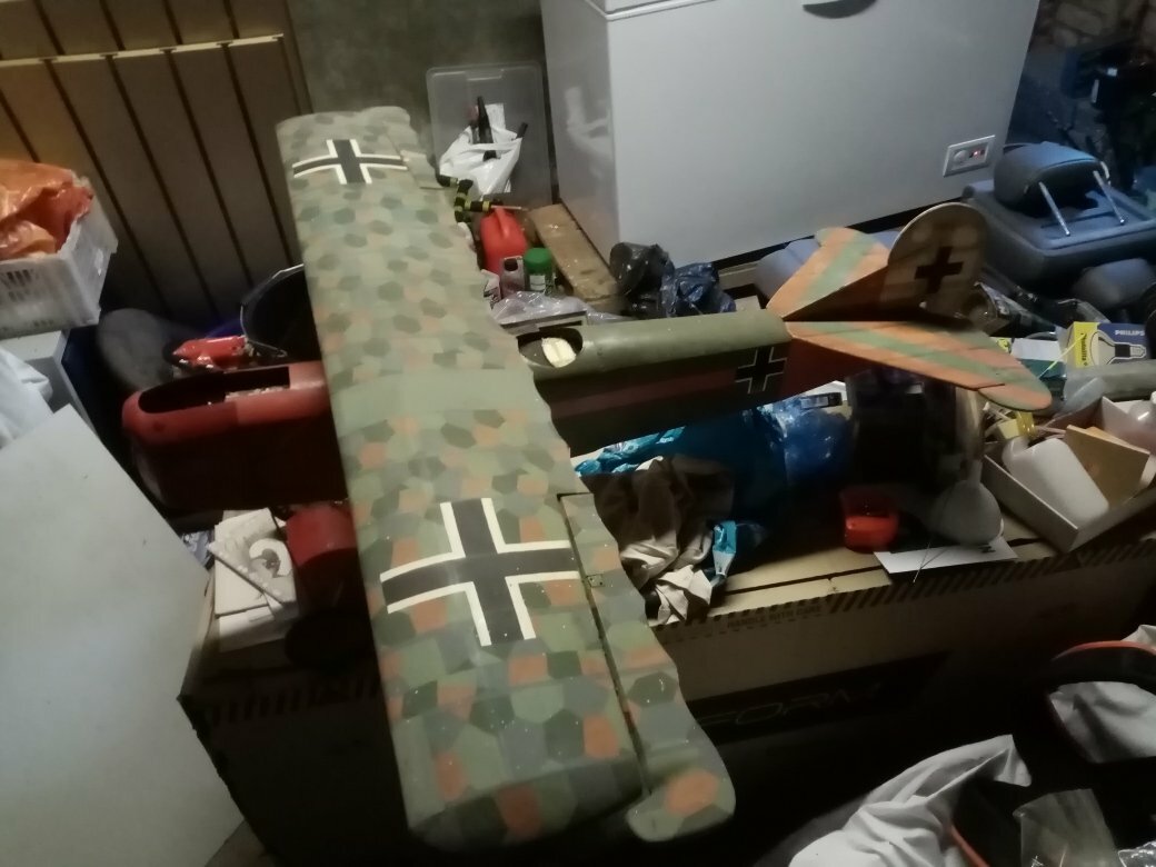

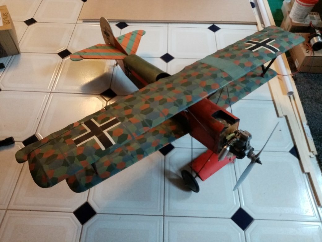

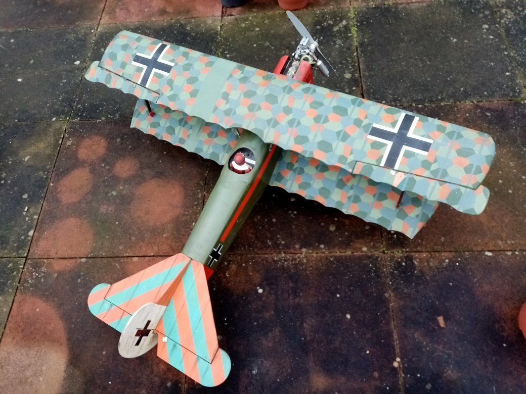

martin collins 1 Posted February 12 Share Posted February 12 The old Fokker is now ready to test fly, it has cleaned up quite nicely, i have left the cowling off in case the slow running needle needs a tweak, as mentioned i bought this at a local swapmeet 6 years ago, yesterday evening i went onto the Facebook page of the club that ran that swapmeet on the off chance that someone might remember the model. Paul Hazelgrove responded on the Fenland Model Flying club page that he had owned it for a number of years before selling it at the swapmeet, he had purchased it from a club mate and `flew it like he stole it` before a mishap meant repairs were required during which he found major fuel soaking on the fuselage so he measured all the parts out and rebuilt it before flying it again till he sold it to me. It is nice to get some history and chat to a previous owner of a model, he said it spent more time being flown inverted than the right way up, looking forward to getting it in the air if this damn mizzly weather finally blows through. 4 Quote Link to comment Share on other sites More sharing options...

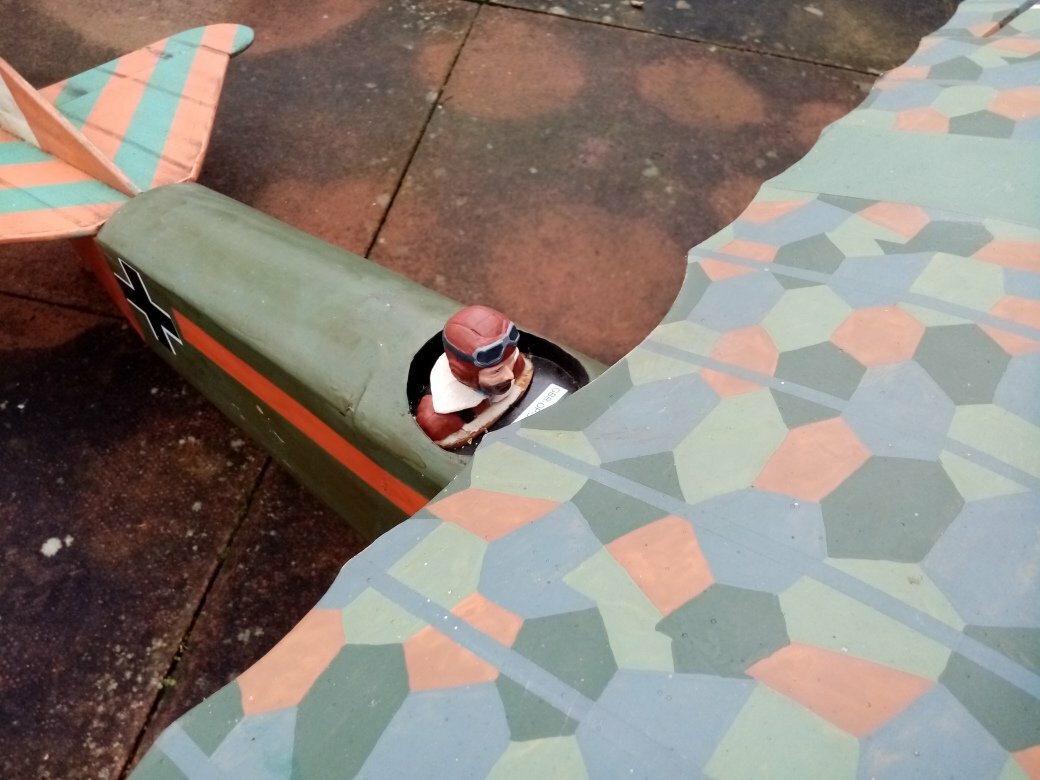

martin collins 1 Posted February 12 Share Posted February 12 (edited) Pilot now added, hopefully the skies will be clear of rain for a sortie tomorrow 🤞, will add the scarf this evening. Edited February 12 by martin collins 1 1 Quote Link to comment Share on other sites More sharing options...
payneib Posted February 12 Share Posted February 12 3 hours ago, martin collins 1 said: Pilot now added, hopefully the skies will be clear of rain for a sortie tomorrow 🤞, will add the scarf this evening. He's got to have a scarf! The bigger and draggier the better! It's the most important part! 1 Quote Link to comment Share on other sites More sharing options...
