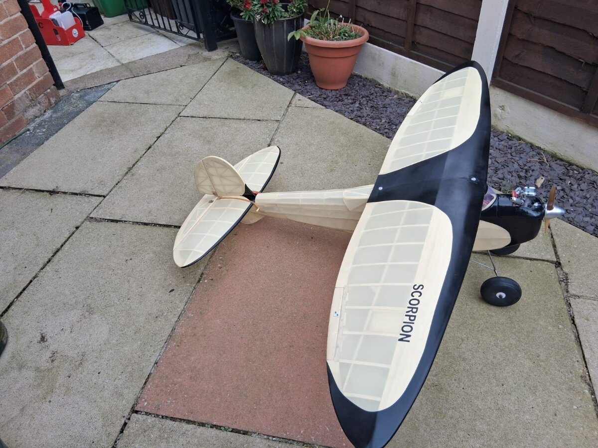

Martyn Johnston Posted February 6, 2023 Author Share Posted February 6, 2023 (edited) Horrible red shiny modern film on the fin. Won't use that again; will try and buy some Oratex (wow it's expensive isn't it). Edited February 6, 2023 by Martyn Johnston Quote Link to comment Share on other sites More sharing options...
Martyn Johnston Posted February 6, 2023 Author Share Posted February 6, 2023 The whole empennage was built to be removable, but the distance from where the snake left the fuselage to the clevis was far too far and it bent too easily. So I've decided to glue the tailplane on permanently (wish I'd done that in the first place). Then I've added another support (you can see it o the last photo - don't know why the photo looks upside-down). Also I couldn't get a wire between the two elevators, so I've added another snake, one for each elevator, and soldered the two clevices together at the front :- might work ! Quote Link to comment Share on other sites More sharing options...
Paul De Tourtoulon Posted February 6, 2023 Share Posted February 6, 2023 Mat varnish will do the job on the red film. 1 Quote Link to comment Share on other sites More sharing options...

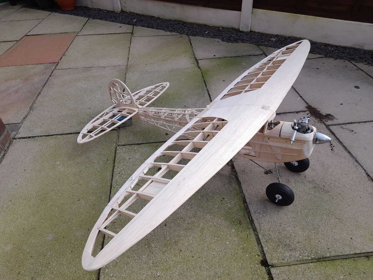

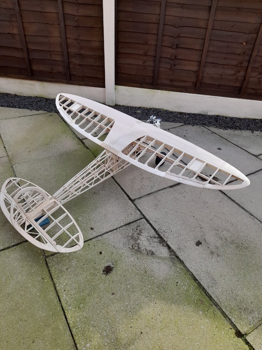

Comper Posted January 5 Share Posted January 5 I’m building the Scorpion at the moment, I’m going to bolt the wing on and reduce the dihedral and fit ailerons. Fuselage is finished with a Saito 40 for power. I’ve also altered the fuselage I didn’t like the triangular shape so the bottom is the same width as the top. Much easier to fit the undercarriage Ok it’s not original and I won’t say anything it will be interesting if anyone notices. Quote Link to comment Share on other sites More sharing options...
