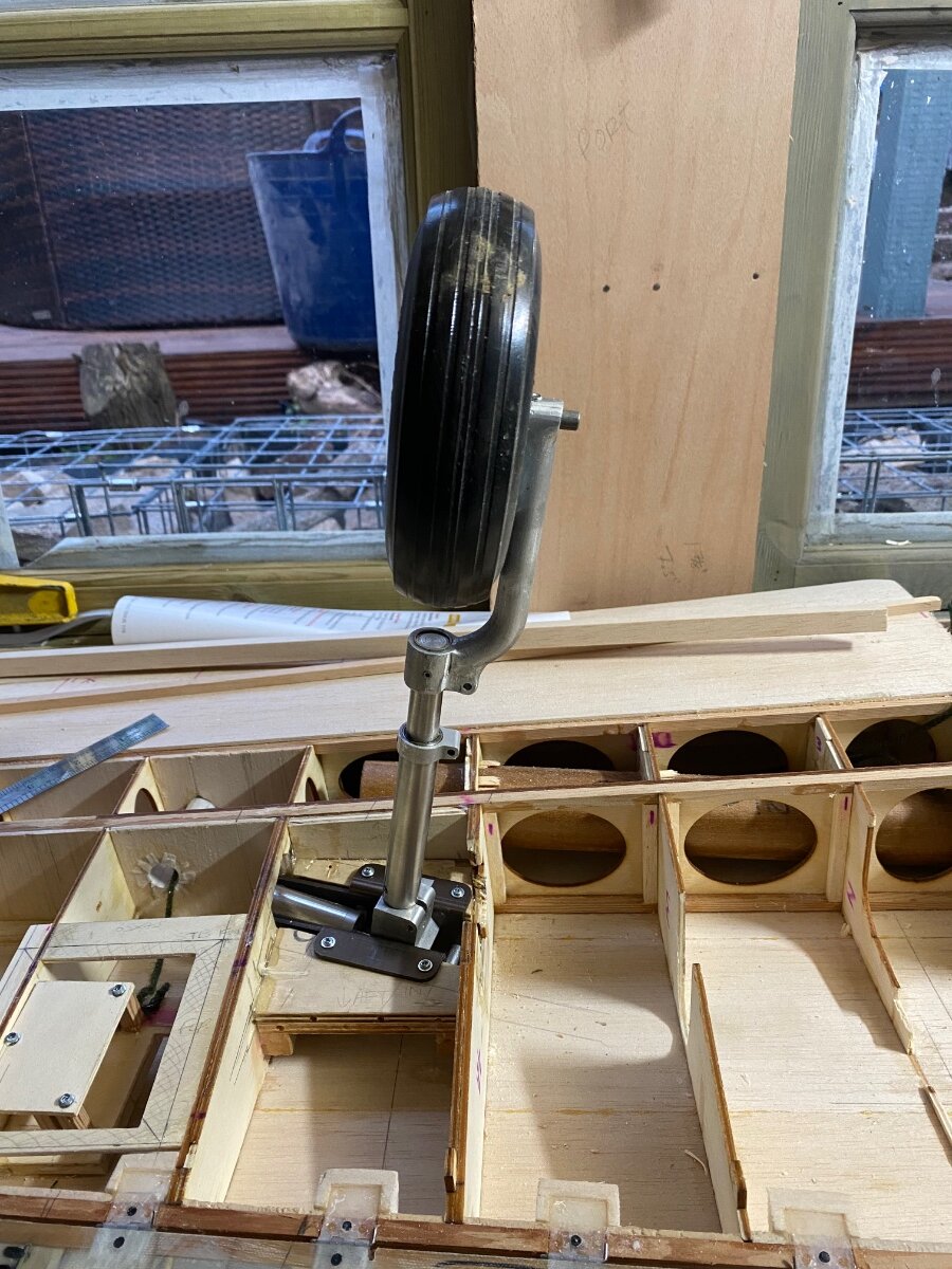

Craig Spence Posted May 31, 2023 Author Share Posted May 31, 2023 Retracts installed and I had to sand the wheels down. I can’t find the spec I need for the wheels so I’ll make these good after sanding. 3 Quote Link to comment Share on other sites More sharing options...
Nick Somerville Posted June 1, 2023 Share Posted June 1, 2023 That looks as though getting the wheels to sit in the bays has been very frustrating! The retract mounts are very small for such a large model. I would consider some carbon cloth in around the area to mitigate the top skin splitting on a hard landing. I have done this retrospectively on my Sea Fury and the weight penalty is minimal. As you say, lovely curves. Quote Link to comment Share on other sites More sharing options...
Craig Spence Posted June 1, 2023 Author Share Posted June 1, 2023 1 hour ago, Nick Somerville said: That looks as though getting the wheels to sit in the bays has been very frustrating! The retract mounts are very small for such a large model. I would consider some carbon cloth in around the area to mitigate the top skin splitting on a hard landing. I have done this retrospectively on my Sea Fury and the weight penalty is minimal. As you say, lovely curves. Thanks Nick, I have some Kevlar pulp I normally use to beef things up. I haven’t put as much info on this thread but the layup is; 1/4” birch ply laminated to 1/4” lite ply. Then half inch balsa block as a shoe. tye leading edge has a 1/4” birch ply sheet web as well. Trouble is with getting these to fit is that no one’s made a commercial set yet so I’ve had to get an engineer to help make the retracts. They should rotate to fit the wheel well but it’s a mod I can’t afford on time so I reduced the wheel thickness. Where do you use the carbon? On the doublers? Quote Link to comment Share on other sites More sharing options...
Nick Somerville Posted June 1, 2023 Share Posted June 1, 2023 That’s a shame not being able to get the retracts to twist a little, but understand that it would be an expensive thing to engineer bespoke for your model. I just laid some carbon cloth down back to the spar and to the adjacent ribs around the mounts. Just used Gorilla PVA as it works well with Carbon cloth. BTW compare the length of the mounts on my FW 190. I suppose with such long stalky legs it made sense to spread the load. 1 Quote Link to comment Share on other sites More sharing options...
Craig Spence Posted June 1, 2023 Author Share Posted June 1, 2023 4 hours ago, Nick Somerville said: That’s a shame not being able to get the retracts to twist a little, but understand that it would be an expensive thing to engineer bespoke for your model. I just laid some carbon cloth down back to the spar and to the adjacent ribs around the mounts. Just used Gorilla PVA as it works well with Carbon cloth. BTW compare the length of the mounts on my FW 190. I suppose with such long stalky legs it made sense to spread the load. Thanks Nick, my original intention was to spread 3 bays (as I’ve done in my bolt) as you have but I went against in the end to reduce weight and make it simpler. As you said you have long legs whilst mine are relatively short and it’s a tricycle gear plane. I hope it pays off 😂 At present there rock solid but are behind the main spar which is different to what I’m used to. Only time will tell. Thanks for all the info and I’ll have a look into the carbon. Quote Link to comment Share on other sites More sharing options...
trevor wood 2 Posted June 1, 2023 Share Posted June 1, 2023 Looks like you might need to calculate a pintle angle that will allow the extended wheels to point fore and aft, and the retracted wheels to lie flush with the lower surface of the wing. Danny Fenton posted some very useful info in “Brian Taylor Hurricane Project” build topic. 1 Quote Link to comment Share on other sites More sharing options...
Craig Spence Posted June 1, 2023 Author Share Posted June 1, 2023 2 hours ago, trevor wood 2 said: Looks like you might need to calculate a pintle angle that will allow the extended wheels to point fore and aft, and the retracted wheels to lie flush with the lower surface of the wing. Danny Fenton posted some very useful info in “Brian Taylor Hurricane Project” build topic. Thanks Trevor, I’ll be going with the set up I have now but when Sierra make a set I will adapt to suit them. Agree with everything above 👍 cheers Quote Link to comment Share on other sites More sharing options...

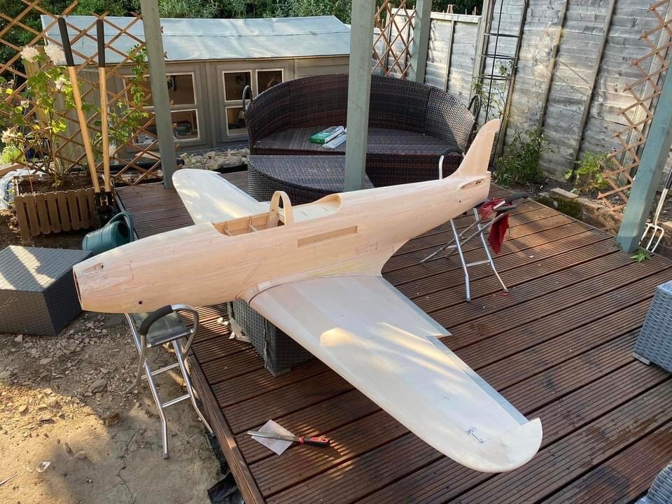

Craig Spence Posted June 19, 2023 Author Share Posted June 19, 2023 Haven't done an update on here for a while. Both wings now glassed, offered up wings to check intake symmetry at the front and all looks ok. More updates to come soon. 2 Quote Link to comment Share on other sites More sharing options...

Nick Somerville Posted March 29, 2024 Share Posted March 29, 2024 Getting close Craig! The wing root fillets came out beautifully! How much detailing are you planing for the surfaces and cockpit? Quote Link to comment Share on other sites More sharing options...
Craig Spence Posted March 29, 2024 Author Share Posted March 29, 2024 1 hour ago, Nick Somerville said: Getting close Craig! The wing root fillets came out beautifully! How much detailing are you planing for the surfaces and cockpit? Thanks very much Nick, really appreciate the kind words. I do plan on adding most surface details and have got some micro screws I’ll be installing to replicate the scale details. Cockpit detailing will have to wait unfortunately. There isn’t a canopy for this model on the market at the moment and I’ll have to make my own which really will be time consuming and the cockpit will have to wait until the canopy has been fabricated. Quote Link to comment Share on other sites More sharing options...
