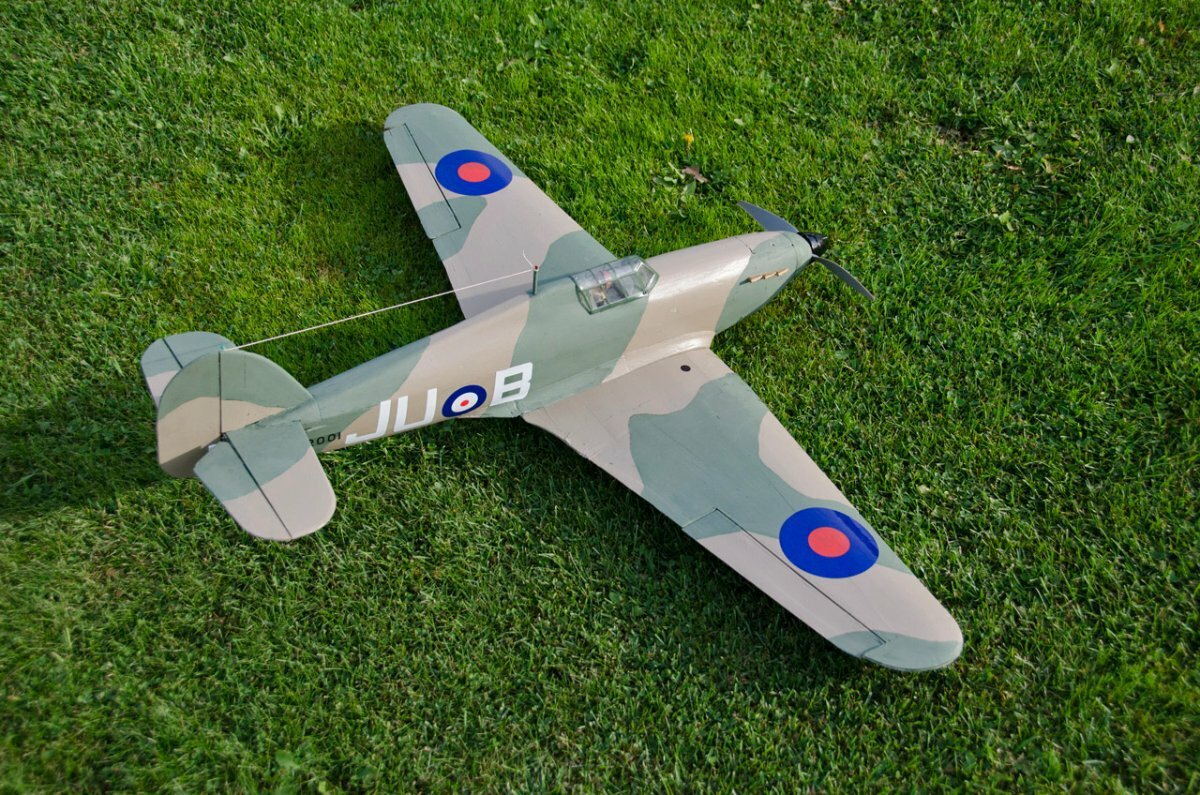

Jan Olof Stenberg Posted October 28, 2024 Author Share Posted October 28, 2024 Hello! Had totally forgotten that I posted the question about the Balsacraft Hurricane, so here's an update of the project. Powered by a Roxxy CL 35-42 with Kv 930 rpm/volt and a Beatles 50 Amp ESC Battery i 3s 3300 mAh a propeller 11x7" Maiden flight 30th Oct 2022, ended with a too hard contact with ground, reason was that the aileron servo gave up. Befor that I felt a very well flying model. No major damage so the repair wasn't too difficlut. I decided to install 2 miniservos in the wing Next flight went better but the model stalled from ca 1,5 meter above ground with the water cooler separated. This Hurricane flies absolutely wonderful now. the only thing I find a bit tricky is launching, i must be very quick to pull some elevetor so I mostly ask a clubmate to launch it for me. Oh, and the flying weight is 1370 grams Best Regards Jan Olov Stenberg, Sweden 9 Quote Link to comment Share on other sites More sharing options...

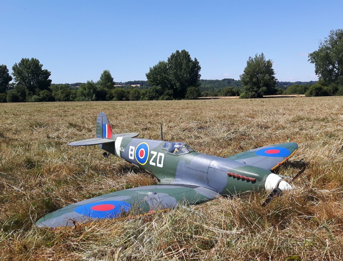

Simon Burch 1 Posted October 28, 2024 Share Posted October 28, 2024 3 hours ago, Jan Olof Stenberg said: the only thing I find a bit tricky is launching, i must be very quick to pull some elevetor s I have a Balsacraft Spitfire IX, which was also difficult to hand launch; with full power applied, it would dive towards the ground and require immediate up-elevator to prevent disaster. This was very entertaining for club-mates; not so much for me. I think this behaviour might have been be due to the model's high thrustline, but I can't be sure. It was designed (as was your Hurricane) for a 600 can motor with a 7 or 8 cell nicad pack and, in this configuration, it didn't have much power. Perhaps this meant that the thrustline wasn't such a problem. Indeed, I used to deliberately launch my 600-powered Spitfire from raised ground so that I had space to dive and accelerate. Once it had gained speed, it performed surprisingly well, especially with the lighter 7-cell pack. With the conversion to brushless/LiPo setup, lack of power ceased to be a problem, but its tendency to pitch down when power was applied (and pitch up when reducing power) was pronounced and unpleasant. I added about 1 degree of upthrust, and I now launch it using about two-thirds throttle, which has largely resolved the problem. Interestingly (for me anyway) I recently built a small Hurricane (Adrian Britton design) which behaved in exactly the same way. I resolved it using the same procedure, together with a small throttle-elevator mix. Best of luck with yours; I think these old Balsacraft designs were great models. 5 Quote Link to comment Share on other sites More sharing options...
Don Fry Posted October 28, 2024 Share Posted October 28, 2024 I’ve got a ducted fan foamy. Same thing. I sorted it by accepting it has not got flying speed out of the hand. It goes down. Use elevator, ( to stop the drop), increases drag, reduces acceleration, takes more time to achieve flying speed. Hits the ground or stalls. Efficient energy use, let it drop. Ease elevator on, to gently level out almost on the ground. Then when ready, it self zooms up, speeding up, and I’m quickly getting rid of up elevator. Quote Link to comment Share on other sites More sharing options...
Jan Olof Stenberg Posted November 1, 2024 Author Share Posted November 1, 2024 Hello, and thanks for Your comments. I launch over high grass just in case... @Simon; Added 1 degree of upthrust, so the motor got a little "up angle", no trim change to elevator? Quote Link to comment Share on other sites More sharing options...
Simon Burch 1 Posted November 1, 2024 Share Posted November 1, 2024 2 hours ago, Jan Olof Stenberg said: dded 1 degree of upthrust, so the motor got a little "up angle", no trim change to elevator? I don't normally add up-trim to the elevator for the launch. With the added up-thrust and only two-thirds throttle set, I find the model's pitch attitude is much easier to control. That said, when I flew it in its original form, ie with a 600 can motor and using an old Futaba Challenger TX, I used to add three-four 'clicks' of up elevator for launching. I'd reset this to neutral in cruise flight. I found the old-style large friction trim adjusters on the Challenger much easier to use than the modern small spring-loaded switches, and in-flight trimming was straightforward. I try to avoid doing it now unless I really have to. A throttle/elevator mix is worth considering, but I haven't found it necessary. Quote Link to comment Share on other sites More sharing options...
