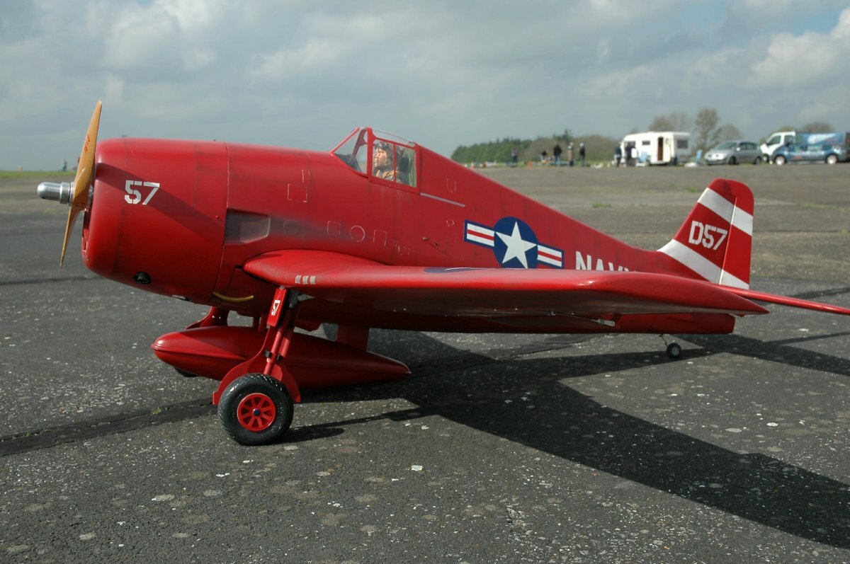

Graham Bowers Posted Sunday at 08:07 Share Posted Sunday at 08:07 On 25/11/2023 at 07:14, Ron Gray said: B&Q do a red and yellow that, once ‘dirtied’ as per Richard’s advice, will look close enough. Thanks for that. Just had a look on the B&Q website for reds and yellows and there are lots and lots of shades in emulsion. Some are obviously a mile out, which narrows it down a bit. However if you had particular ones in mind, would you mind sharing the specifics please? Quote Link to comment Share on other sites More sharing options...
RICHARD WILLS Posted Sunday at 10:16 Author Share Posted Sunday at 10:16 2 hours ago, Graham Bowers said: Thanks for that. Just had a look on the B&Q website for reds and yellows and there are lots and lots of shades in emulsion. Some are obviously a mile out, which narrows it down a bit. However if you had particular ones in mind, would you mind sharing the specifics please? Ok , Graham . In band Q they will mix you a nice size pot of valspar emulsion (Matt or silk ) I think in your case I'd go silk , but for general camo go matt . Take a print off with what you want . The yellow is definetely going to be US trainer yellow but they can match it pretty closely from a sample . The red should be more like pillar box red , so definitely not an element of orange . So ask them to mix a yellow , red and black . That way you can add a little black to the red to calm it down if it looks too much . I dont think you will have to though if you go with my plan of heavy charcoal staining . I tell you what , I will get a piece of yellow paper and weather it as a sample to send to you . 1 Quote Link to comment Share on other sites More sharing options...
Graham Bowers Posted Sunday at 11:16 Share Posted Sunday at 11:16 54 minutes ago, RICHARD WILLS said: Ok , Graham . In band Q they will mix you a nice size pot of valspar emulsion (Matt or silk ) I think in your case I'd go silk , but for general camo go matt . Take a print off with what you want . The yellow is definetely going to be US trainer yellow but they can match it pretty closely from a sample . The red should be more like pillar box red , so definitely not an element of orange . So ask them to mix a yellow , red and black . That way you can add a little black to the red to calm it down if it looks too much . I dont think you will have to though if you go with my plan of heavy charcoal staining . I tell you what , I will get a piece of yellow paper and weather it as a sample to send to you . That'll be handy, thanks 🙂 There's an excellent independent DIY shop a couple of miles away that does mixing so I'll pay them a visit in the first instance. Quote Link to comment Share on other sites More sharing options...
