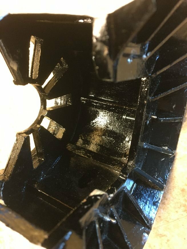

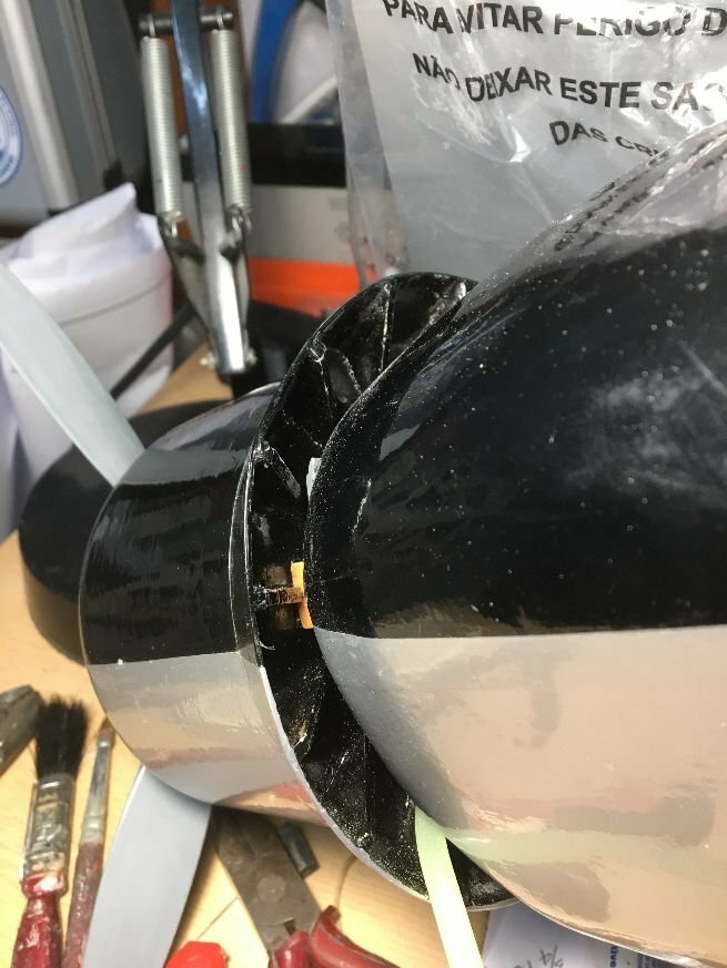

alan p Posted November 24 Author Share Posted November 24 Hi Bas Photos of my cowl construction 1/4 ply for the rings, 1/32 ply sheet and balsa. Obviously for a I/c engine but can be altered for electric Alanp Quote Link to comment Share on other sites More sharing options...

Basil Posted November 24 Share Posted November 24 22 minutes ago, alan p said: Hi Bas Photos of my cowl construction 1/4 ply for the rings, 1/32 ply sheet and balsa. Obviously for a I/c engine but can be altered for electric Alanp Many thanks Allan, some clear pictures of the cowl construction.This together with the other posts has given me some ideas, direction and inspiration. Many thanks. I have never had to make a cowl before. Ta !!!!!! Bas Quote Link to comment Share on other sites More sharing options...
