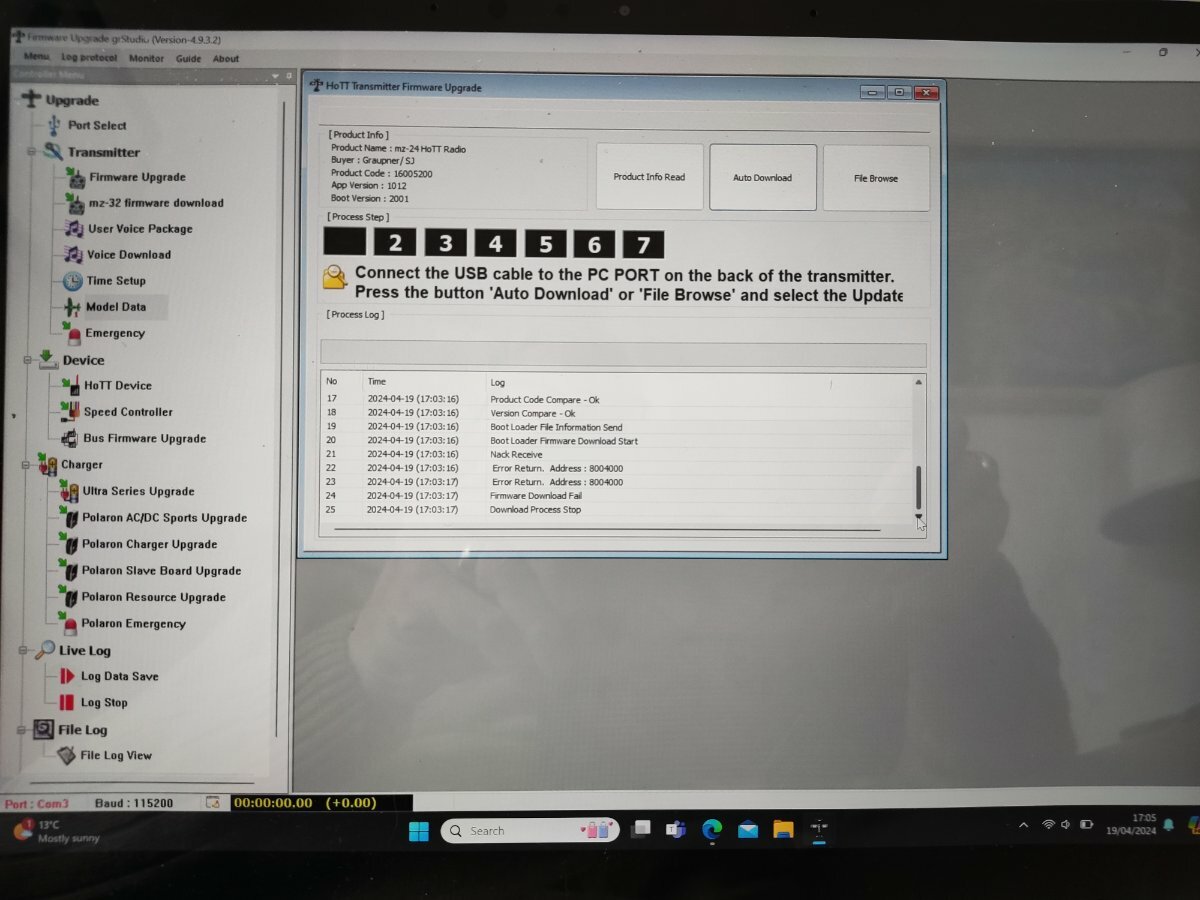

I have a problem with my Mz24. I downloaded the latest GR firmware update software and it downloads the latest file but can't apply it through usb to the tx. Windows 10 seems to have the come port open but the bootloader does not open so the firmware does not complete. Any ideas? I'd like to update to 5he Mz24 Pro firmware but not sure if it's possible?

Thanks yes that's where I downloaded the update studio. I've tried it on windows 10 and 11 pcs with the same result... It gets as far as applying the file to the tx then stops. Obviously the USB comms are OK as it identifies the tx type. The screen image of the failure is here

I was having the same issue. My MZ-24 was stuck on 1.032 firmware just refused to go further with same error in above thread. Tried countless times.   I emailed Graupner Germany to enquire about the pro upgrade but I have not heard back yet BUT..........
I took the back off to fix a broken bit and found a CR2032 lithium battery, my tx is about 10 years old so guessing it was about time to change it. Swapped it out for a new one and put it all back together. Ran the upgrade using grStudio version 4.9.3.2 and it took a lot longer to download the firmware file, around 60-90 seconds. Then rebooted and bingo, version 1.056 all good to go.
