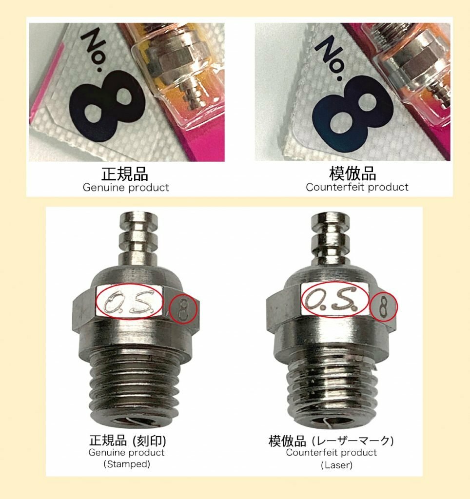

Andy Stephenson Posted September 4, 2024 Share Posted September 4, 2024 There are bogus OS glow plugs out there but I haven't come across F plugs being copied. If indeed you have fake plugs they will probably be laser etched with the type rather than stamped like the genuine article. Alternatively, it could be there is some manufacturing debris remaining in the engine which is destroying plugs. This is not an unknown phenomenon in a new engine. It may be worth stripping it down to investigate. Quote Link to comment Share on other sites More sharing options...
Paul De Tourtoulon Posted September 5, 2024 Share Posted September 5, 2024 Yes maybe counterfeit plugs, but I think that it's a question of quality, like you mine used to last more than 5 years, but last year I changed at least 3 . Quote Link to comment Share on other sites More sharing options...

Fred Lew Posted September 7, 2024 Share Posted September 7, 2024 I have also ordered from RC Japan for some YS and OS 8 and F plugs. I compared the OS 8 plugs to the information on the OS site about counterfeits and found they were the genuine items. Very good shipping times to Canada. Quote Link to comment Share on other sites More sharing options...
