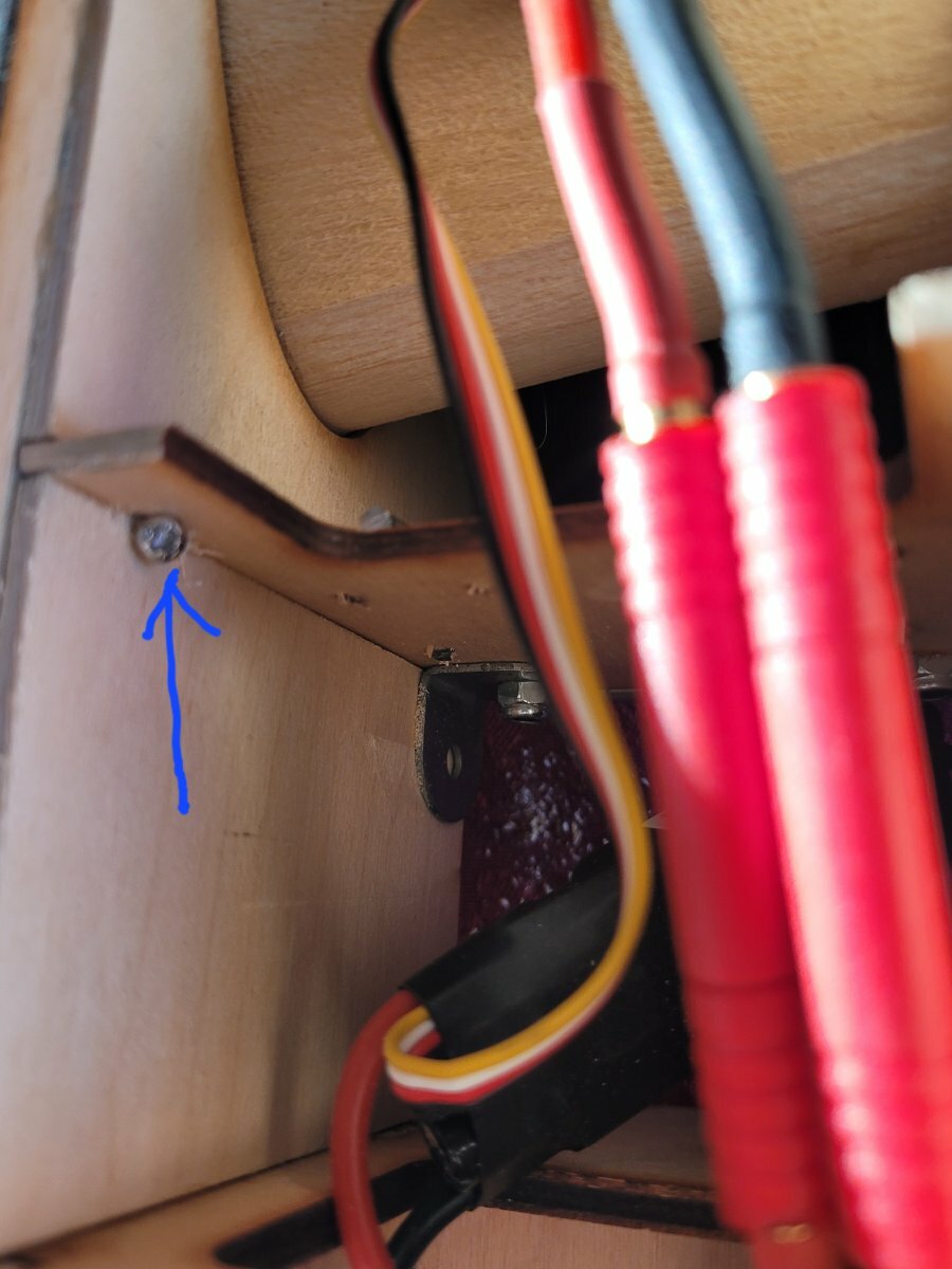

Eric Robson Posted January 3 Share Posted January 3 Richard held the vertical sliding mount for the undercarriage in place with cocktail sticks. He recommends using screws which will make removal over the whole unit quick and easy. The vertical mount needs to have approx 6mm removed from the top to clear the hatch. Two 2x12 self tapping screws one either side should be OK, where I have placed them should be accessible through the battery hatch. 3 Quote Link to comment Share on other sites More sharing options...

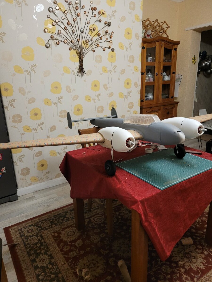

Declan Posted January 4 Share Posted January 4 I've got a few pictures of my build so far if anyone is interested. 3 1 Quote Link to comment Share on other sites More sharing options...

Declan Posted January 4 Share Posted January 4 4 hours ago, payneib said: What's the space like for a stearable tail wheel? Looking at Declans photos, it looks a bit tight. There was the option of steering the tailwheel I fitted. However, the steering arm would have been very short. How it was controlled would be tricky. I did think of either a second linkage from the rudder servo or a linkage en route to the bellcrank. Based on my location descion for fitting servos for the elevators and rudders I decided that simplicity was the best option. I didn't want an overly complex solution that was going to cause me problems later on. Given that the rudders are directly in the propwash I wasn't sure how much authority the tailwheel would have over the steering anyway. Quote Link to comment Share on other sites More sharing options...
