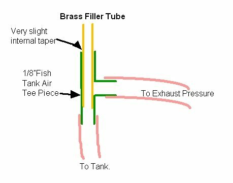

Andy Stephenson Posted November 6, 2024 Share Posted November 6, 2024 You might be able to adapt a fuelling system I've used... The yellow = brass tube inserted to fuel and defuel. Quote Link to comment Share on other sites More sharing options...
