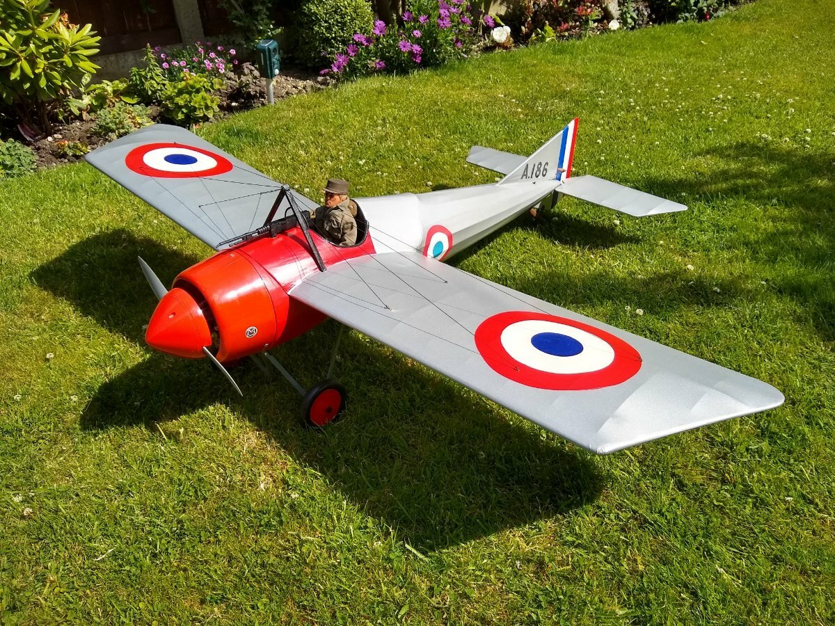

John Wagg Posted February 18 Share Posted February 18 2 hours ago, David Davis said: If I were to cut out a yellow and a blue circle from Solarfilm, using a blade in a compass, how would I attach them to the existing covering without using heat? I expect that the extra heat from the iron would distort the existing covering. Sorry, I haven't done Solarfilm roundels but have done stars. Probably a lot easier but did use heat and an iron. On my Morane I painted the roundels following Cliff Harvey's method :- https://www.youtube.com/watch?v=lnVcT90G2ls I didn't have Frog tape so used electricians tape cut into strips. I used acrylic paints from a local shop which are quite cheap but did a good job. https://www.theworks.co.uk/p/acrylic-paint/crawford-and-black-yellow-acrylic-paint-200ml/5052089334250.html (Other makes available but not sure about availability in France.) 1 Quote Link to comment Share on other sites More sharing options...

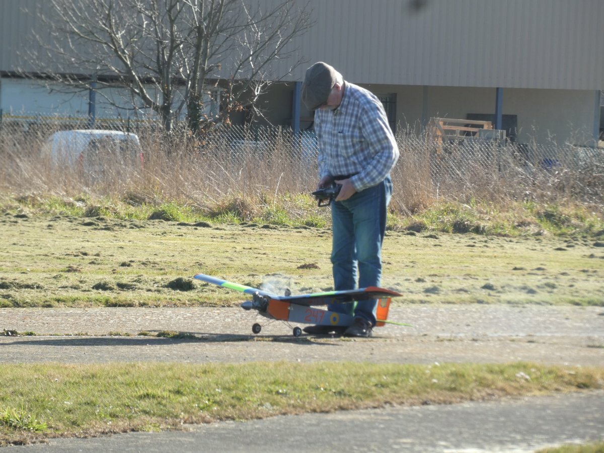

David Davis Posted March 7 Author Share Posted March 7 (edited) While practising for La Coupe Des Barons last week one of the wheels fell off and disappeared into the plough. I managed to get the model down onto our 10 metre wide tarmac runway. Picture of your humble servant and the Ukrainian Baron below. Note the very small wheels. Given the cost of WW1 replica wheels I'm planning to make my own out of balsa and ply with a neoprene tyre. Any tips? Edited March 7 by David Davis Quote Link to comment Share on other sites More sharing options...
