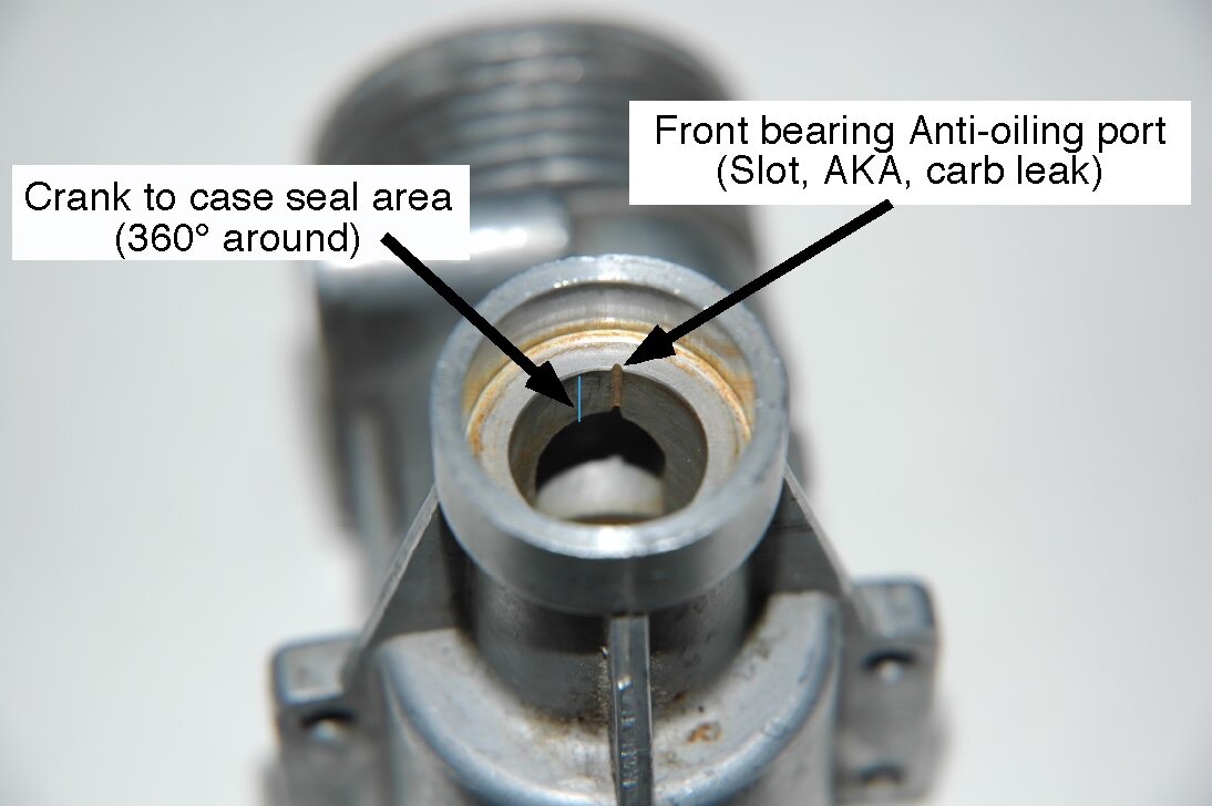

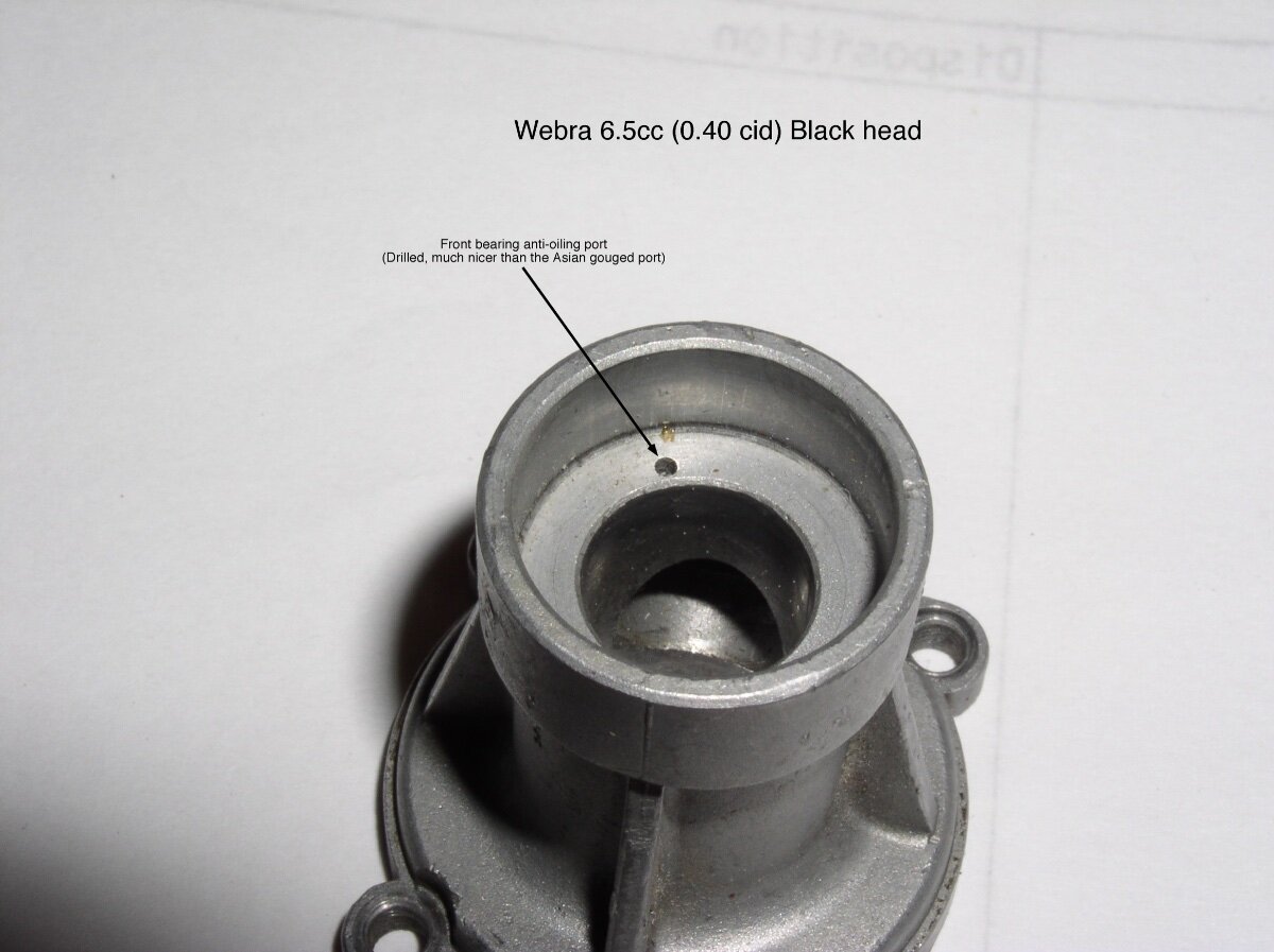

Konrad Posted December 16, 2024 Share Posted December 16, 2024 Designed air leak. This was something that we the customers asked for. That is some kept complaining that there was oil/fuel spitting out of the front bearing. So to quiet the complaints manufactures added a low pressure port. This was to allow the low pressure under the carb at idle to suck the fuel that had gotten past the front crankcase seal to be drawn back into the engine. Originally this was done with a drilled passage. But this cost time and ran the risk of broken drill bits. Later it was found that broaching a grove with the boring bar was much more friendly to the manufacturing process. As to nickel there is little wrong with properly applied electroless nickel plating. OS tried a few short cuts that ruined her reputation. Now nickel never could compete with the performance of real chrome plating. But for the general sport engine properly applied electroless nickel plating was more than adequate. Friends don't let friends fly nickel, Konrad 1 Quote Link to comment Share on other sites More sharing options...
