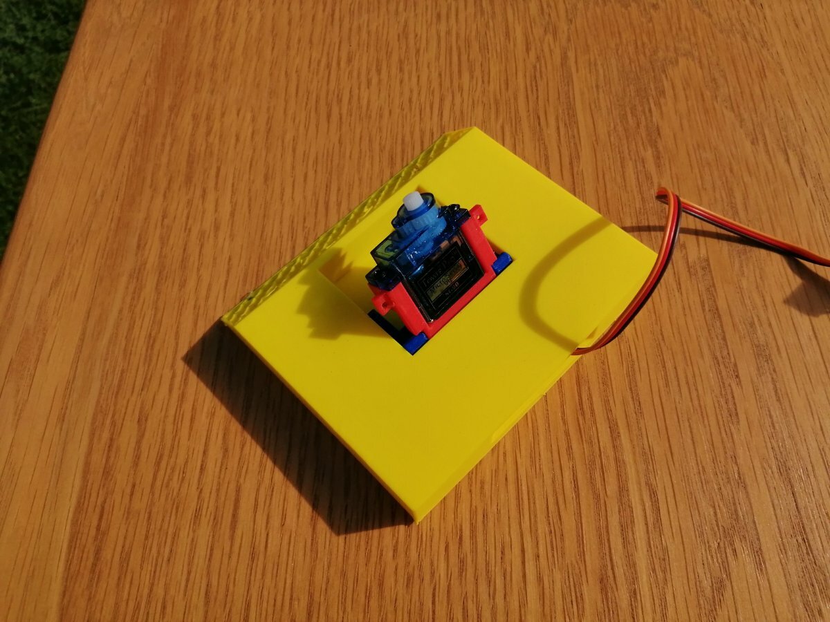

Bob Brown Posted January 14 Share Posted January 14 Don’t glue 9g servos into the wings. Instead of gluing 9g servos into wings due to the limited depth of the recess, try using one of these servo mount designs which give free access to the servo. There are two types, one in which the frame is fixed down into the recess and the other which incorporates a servo cover and is fixed to the wing surface. These are 3d printed designs which are freely available on Thingiverse and only cost a few pence to make. Here are the Thingiverse links for the files and full details. https://www.thingiverse.com/thing:6859356 https://www.thingiverse.com/thing:6721166 2 Quote Link to comment Share on other sites More sharing options...
