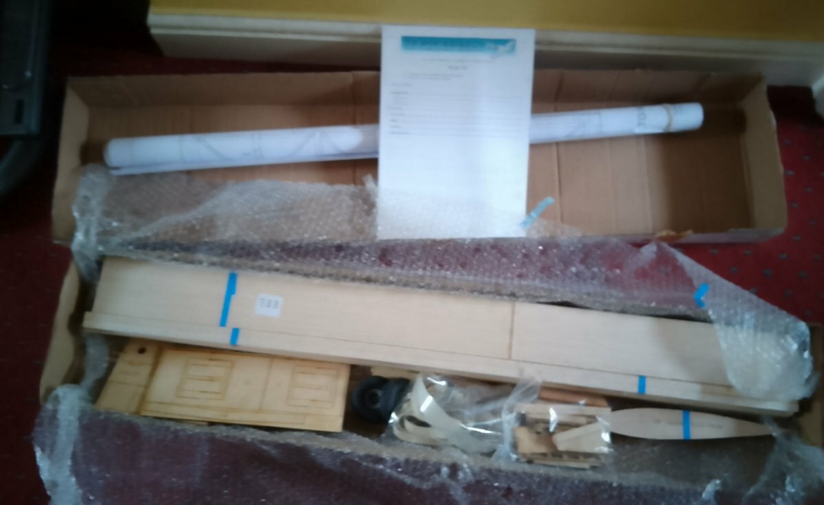

EarlyBird Posted February 9 Share Posted February 9 It has been a long time since I built a kit and the Mascot has been mentioned a view times on here, I thought I would kill two birds with one stone and therefore bought the kit from DB sport and scale. This will be electric as I have the power train in stock. Upon opening the box I noticed the wing bands, which I don't like, so a few changes are going to be made to bring the design up to date with modern materials and methods. Would anyone else like to join in , please do as I do like to have company. Steve 1 Quote Link to comment Share on other sites More sharing options...

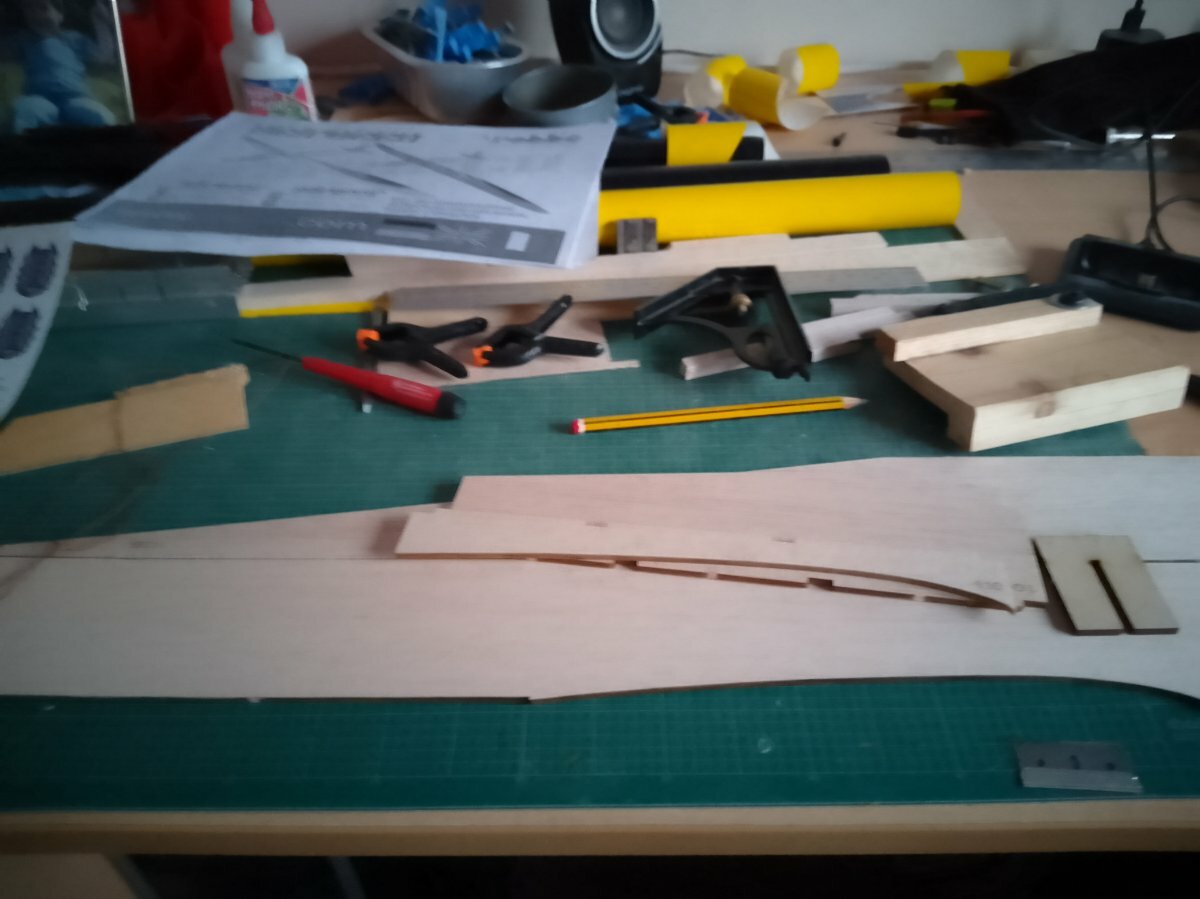

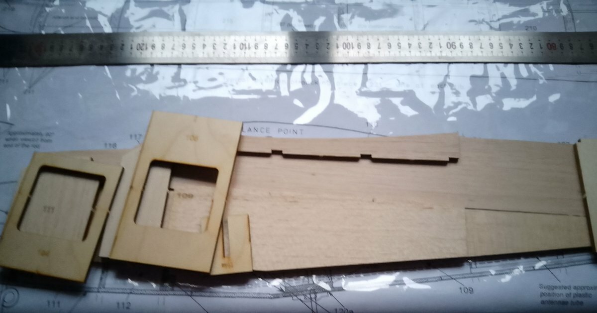

EarlyBird Posted February 11 Author Share Posted February 11 Thank you for the encouragement as a result of which I have retrieved the kit from the cupboard. Opening the box is a one-way Street as there is no way I can possibly not start building. First is to study the plan and then removing the laser cut parts from the sheets as supplied. That's after making room to work. Yes I just pushed all of the rubbish back and got on with it. 🤣👍 Plan is on the building board and the first side is almost ready to build. How far has everybody else got? Pictures of your progress would be good. Steve 1 Quote Link to comment Share on other sites More sharing options...
EarlyBird Posted February 11 Author Share Posted February 11 Now that I am ready to start gluing the first thing to do is read the instructions, I didn't forget honest. 🤣 Steve Quote Link to comment Share on other sites More sharing options...

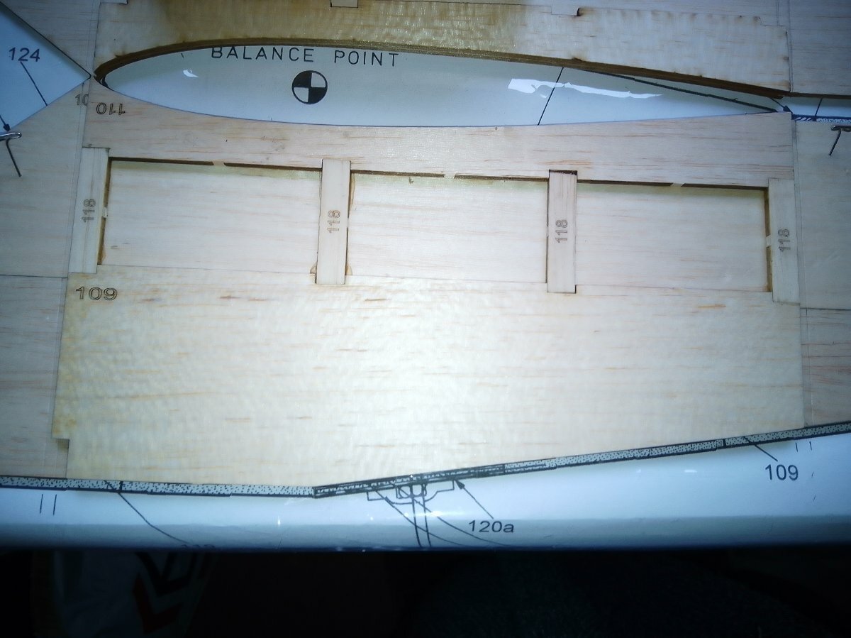

EarlyBird Posted February 14 Author Share Posted February 14 The kit is supplied as designed for i/c with a few modifications for electric. There are some changes I need to make to the formers and obviously these required decisions as for example where the ESC will be located and how the wing will be secured. Another decision required is how to maximize the battery access. Maybe too much thinking going on here as I was considering replacing all the balsa doublers on the fuselage sides with a single piece of 1/32 ply. Studying the plan it looks like there is built-in down thrust and an allowance for side thrust. All this thinking time is enabling me to continue repairing the vq giant stick. Steve Quote Link to comment Share on other sites More sharing options...

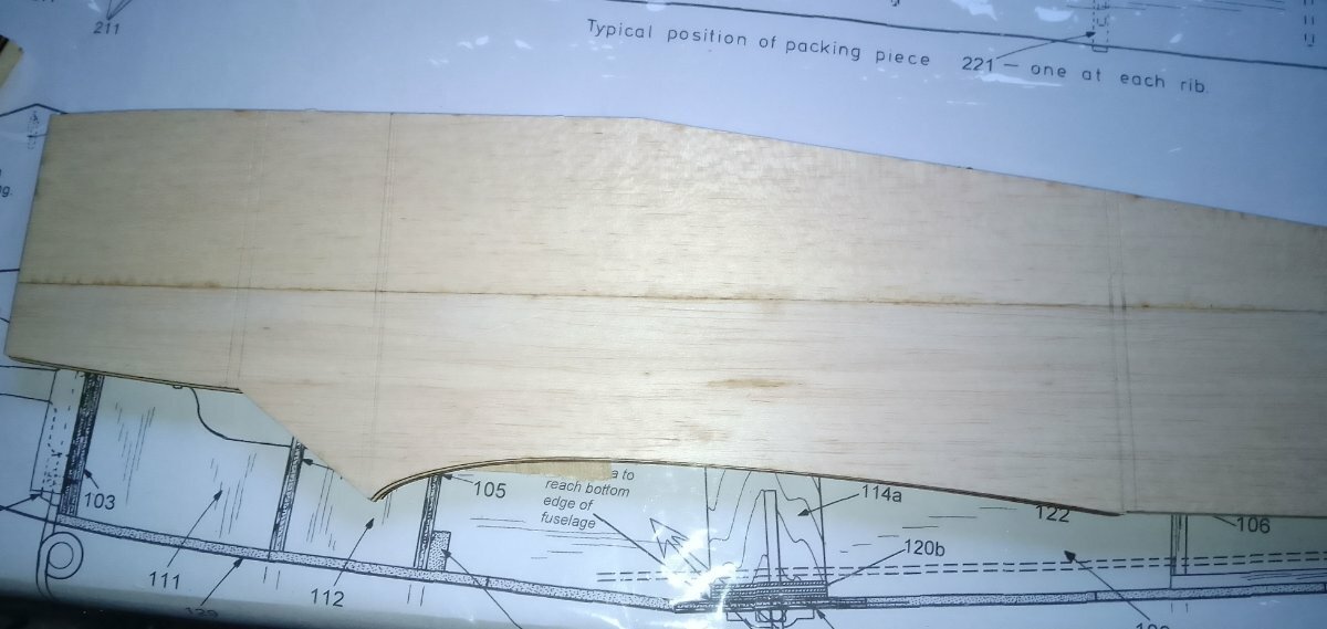

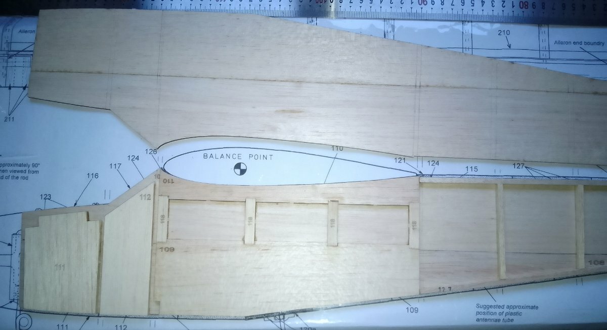

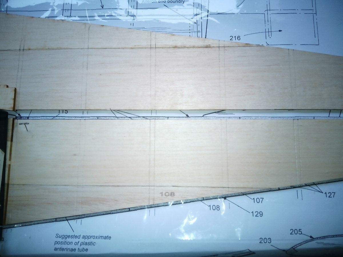

EarlyBird Posted February 14 Author Share Posted February 14 But I made a start by gluing the two halves of the fuselage sides together using the normal tape hinged method. Which involves removing the laser cut nibs and burnt wood first then apply a tape hinge and glue held flat with a weight. Steve Quote Link to comment Share on other sites More sharing options...

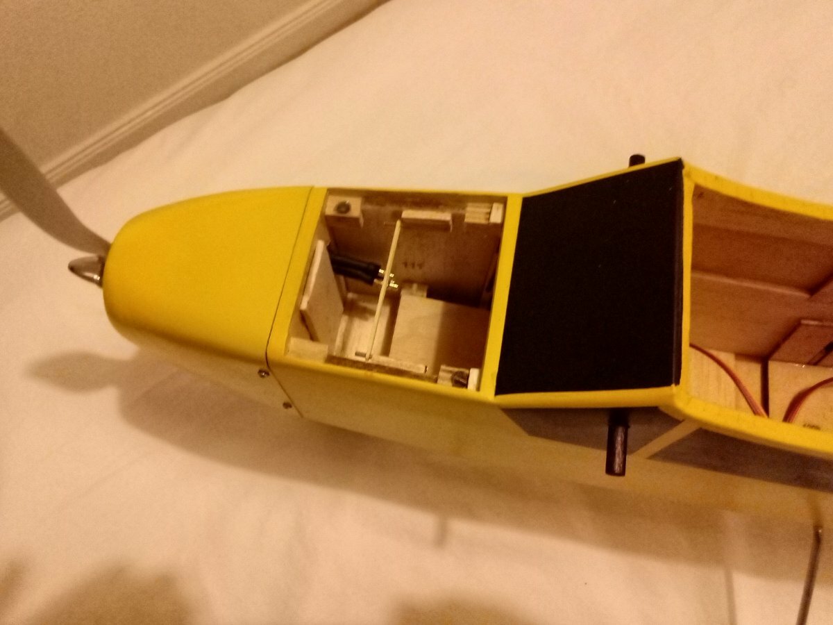

Richard Wood Posted February 14 Share Posted February 14 If it helps, I eventually decided to locate the ESC behind the firewall on the plate shown in the pic. Hopefully a velcro fix will be secure enough. The battery will go on the ply platform, secured in the usual way with velcro and straps. The hatch is held in place with rubber bands anchored at the sides & the underside of the hatch, along with a couple of magnets. The internal hole in the second former was opened out a little to accommodate the battery. My kit was bought a few years ago and the plan & instructions may have been changed since. 1 Quote Link to comment Share on other sites More sharing options...
EarlyBird Posted February 15 Author Share Posted February 15 Thanks Richard, I usually place the ESC under the battery plate. The other option I have used before is to place it on the side of the fuselage. 🤔 With the two sides glued together I pinned them to the board so that they are parallel and transferred the guide lines across from the first to the second side. Following the instructions we can now start adding the parts to the first side. Steve 1 Quote Link to comment Share on other sites More sharing options...

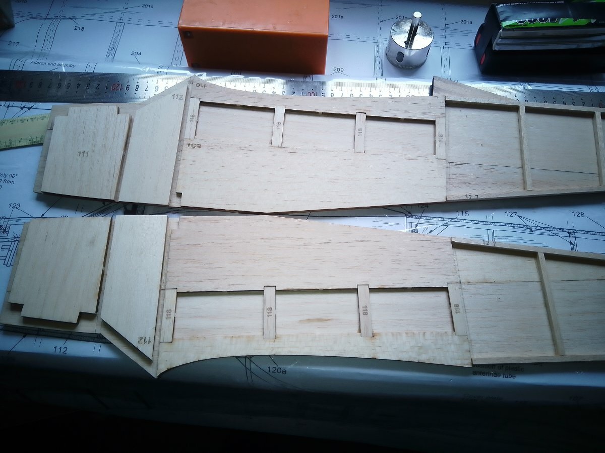

EarlyBird Posted February 15 Author Share Posted February 15 The first side complete Turn it over and place the second side back to back And add all of the parts to the second side and make them identical. Well that's what the instructions say make it sound easy. Steve Quote Link to comment Share on other sites More sharing options...
Outrunner Posted February 15 Share Posted February 15 26 minutes ago, EarlyBird said: The first side complete Turn it over and place the second side back to back And add all of the parts to the second side and make them identical. Well that's what the instructions say make it sound easy. Steve Don't make the two sides identical, you need a left and a right side! Nice kit. 2 Quote Link to comment Share on other sites More sharing options...

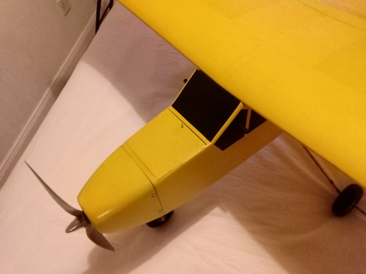

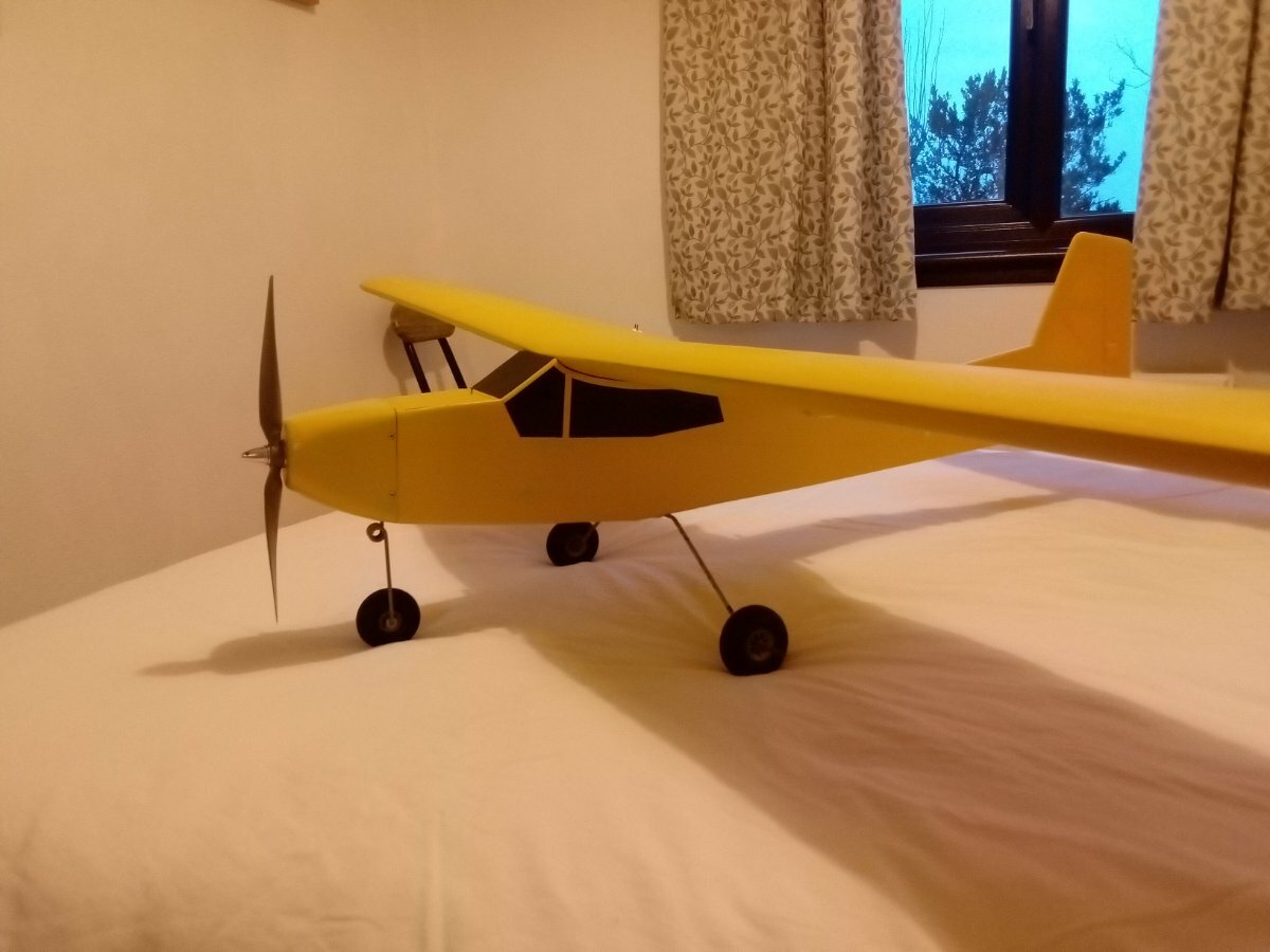

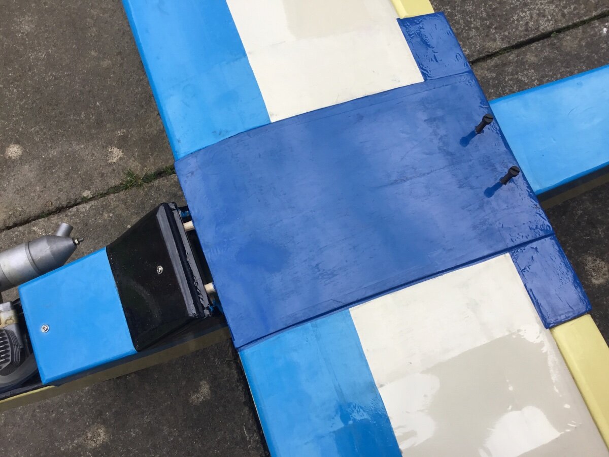

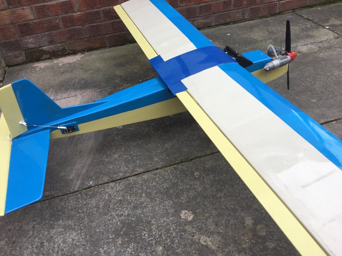

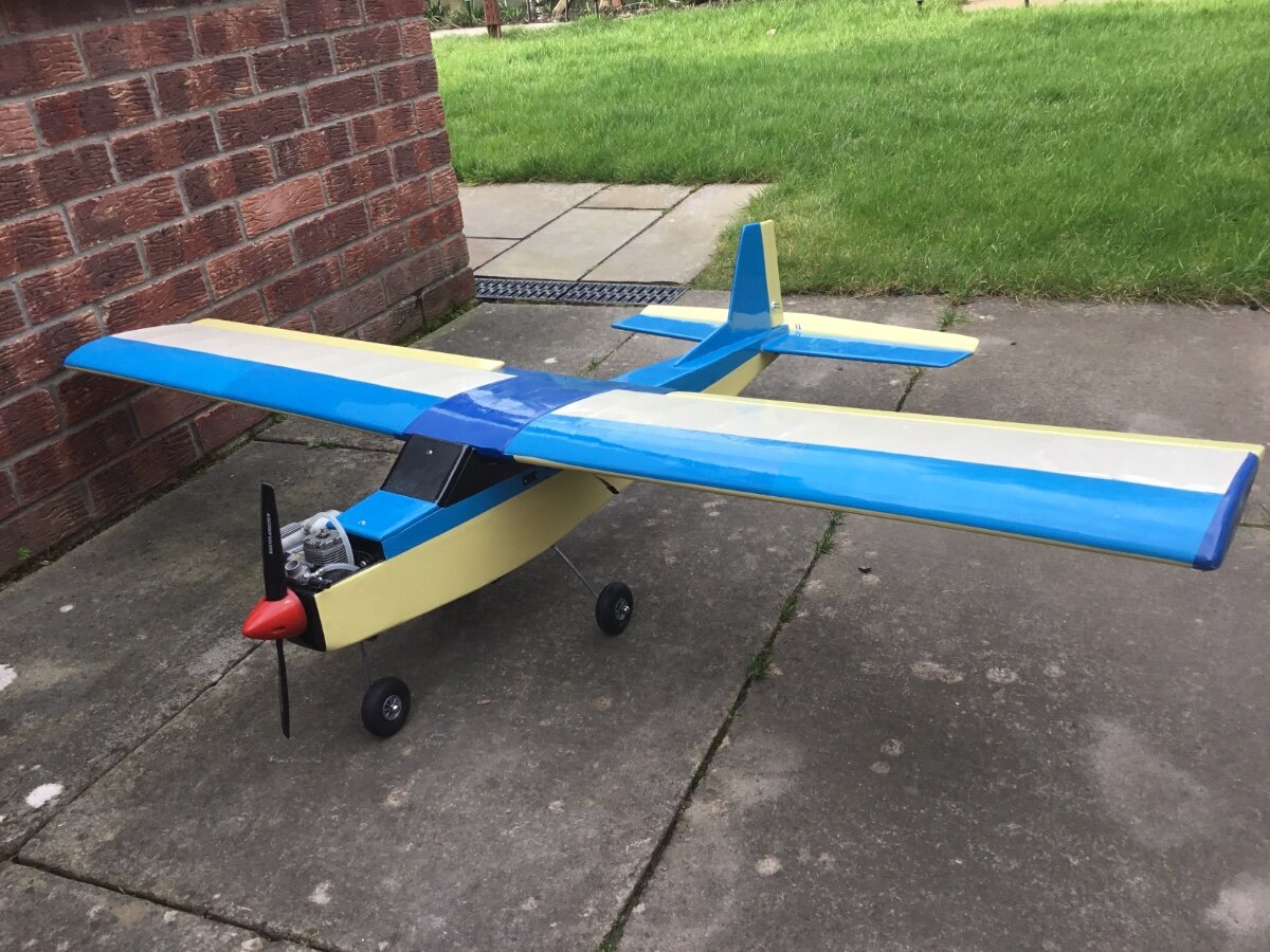

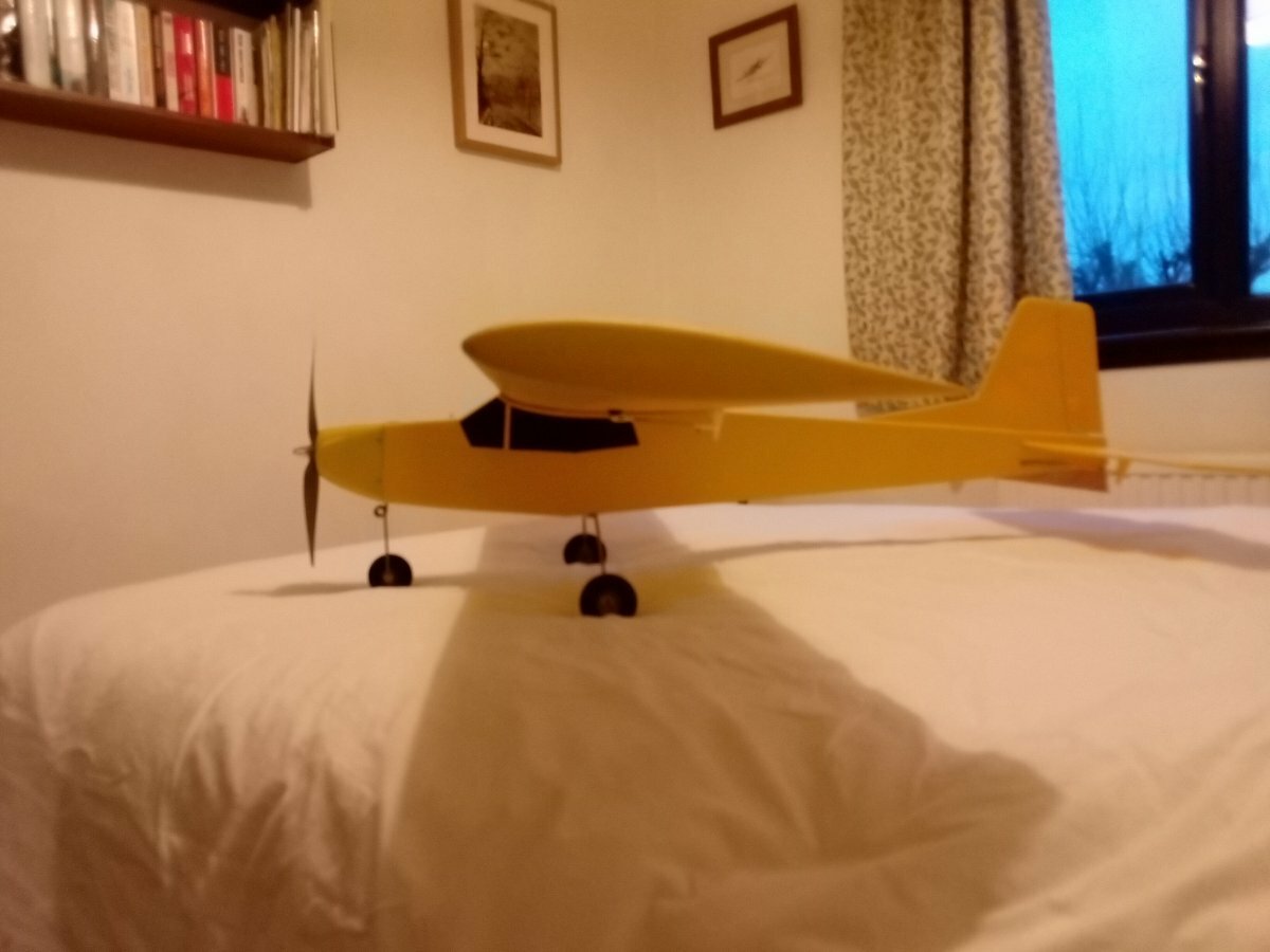

Tom Flynn 1 Posted February 17 Share Posted February 17 Here are some pictures of my Mascot, which I built from the DB plan last summer. As you can see no canopy, so the old fashioned way. Also when originally built it was a tail dragger, mainly as I had an old Acro Wot undercarriage spare, but it didn’t look right, so I changed it while renovating it. Its original first flight was perfect. Next flight it left the ground and went vertical then sharp to the right and back into the ground. After the repair I had a few more incidents of it doing the same, so I put a smaller engine in, added more right and down thrust. It flew and I was happy, but after several minor bangs it looked tatty, So I stripped and rebuilt the front of the fuselage, plus I did away with the elastic bands by using the pegs and wing bolts. I’m now sat Waiting for some heat to arrive so I can fly it again. 3 Quote Link to comment Share on other sites More sharing options...
