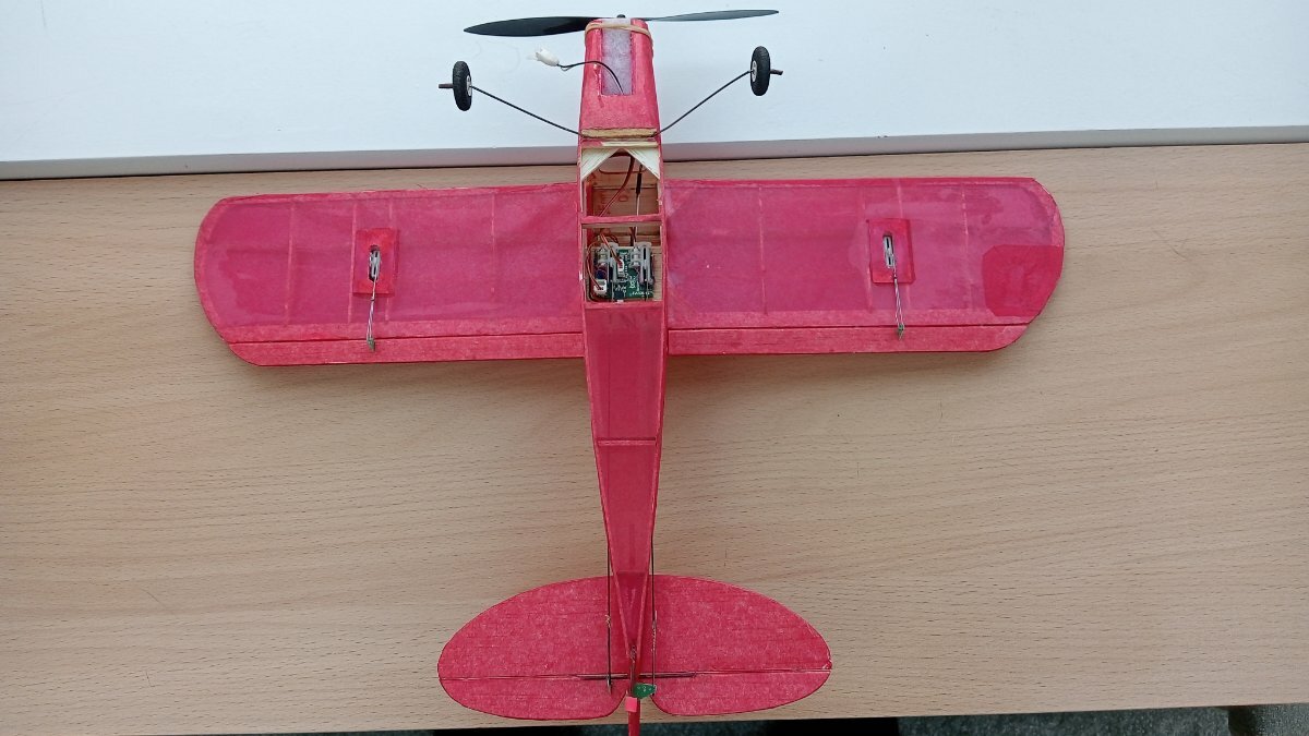

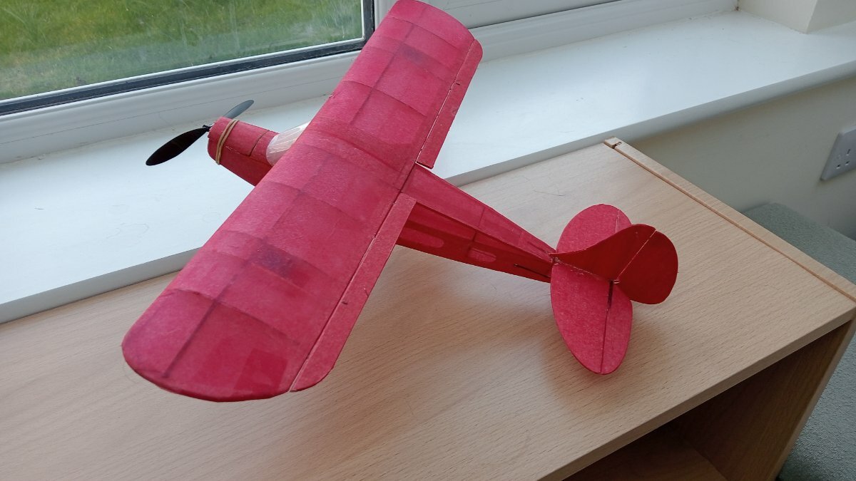

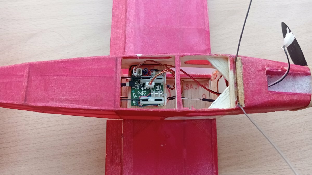

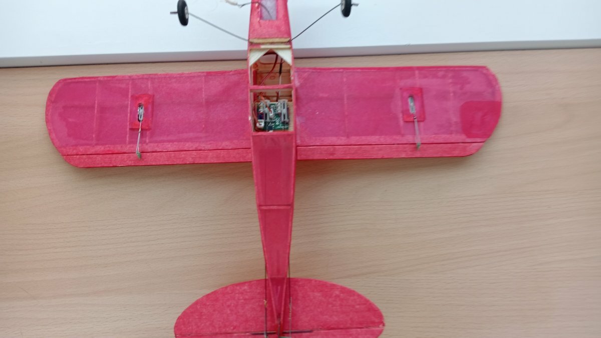

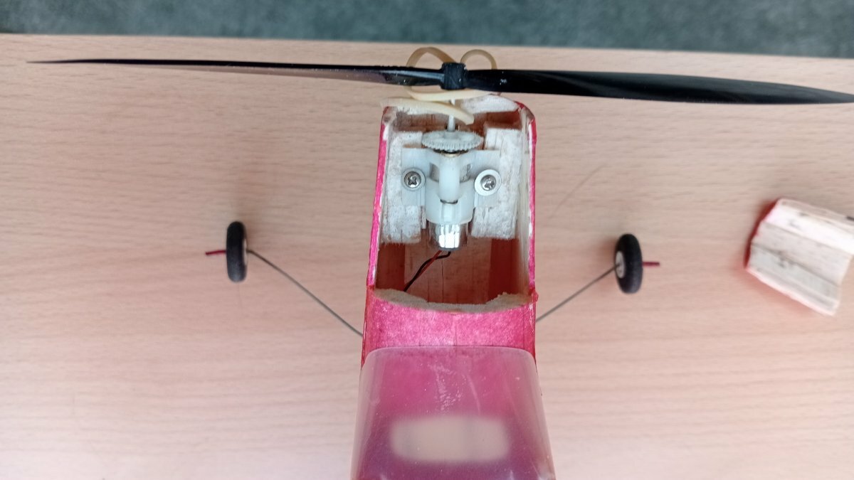

Andy Stephenson Posted March 9 Share Posted March 9 This is my VMC Redwing with 4 function micro R/C gear culled from a Parkzone Sukhoi, covered in tissue over Mylar. It has flown numerous times indoors as well as outdoors. The kits do seem expensive but they are a pleasure to build. 2 Quote Link to comment Share on other sites More sharing options...
GrumpyGnome Posted March 9 Share Posted March 9 1 hour ago, Bigeard said: Do you think the Corsair would make a good conversion to micro RC ? Hopefully it would be a bit more of a slower model ? Slower than what? Probably better off with converting a high wing cabin model as a start..... Andy S's umx stuff, with an all-in-one esc/rx/2linear servo block plus 2 remote linear servos is probably the lightest electronic package, keeping wing loading and speed down. 2 Quote Link to comment Share on other sites More sharing options...

Bigeard Posted March 12 Author Share Posted March 12 On 09/03/2025 at 17:16, Andy Stephenson said: This is my VMC Redwing with 4 function micro R/C gear culled from a Parkzone Sukhoi, covered in tissue over Mylar. It has flown numerous times indoors as well as outdoors. The kits do seem expensive but they are a pleasure to build. what is Mylar exactly ( strength wise ? and is it expensive ? Quote Link to comment Share on other sites More sharing options...
Andy Stephenson Posted March 12 Share Posted March 12 Bigeard, Mylar is a polyester film made from stretched polyethylene terephthalate (PET), pop bottle material. It comes in sheet form on the roll from Mike Woodhouse in thicknesses from 1micron up to 12.5micron. It's a clear film that also can be silvered. It heatshrinks like iron films but has no adhesive and it can be attached to an airframe with Covergrip. I have used the 2micron which is very flimsy, the 5 micron is easier to use. When applied under tissue so little dope is needed, it comes in lighter than tissue alone with the additional advantages that it's completely air-proof and puncture resistant. 1 Quote Link to comment Share on other sites More sharing options...
