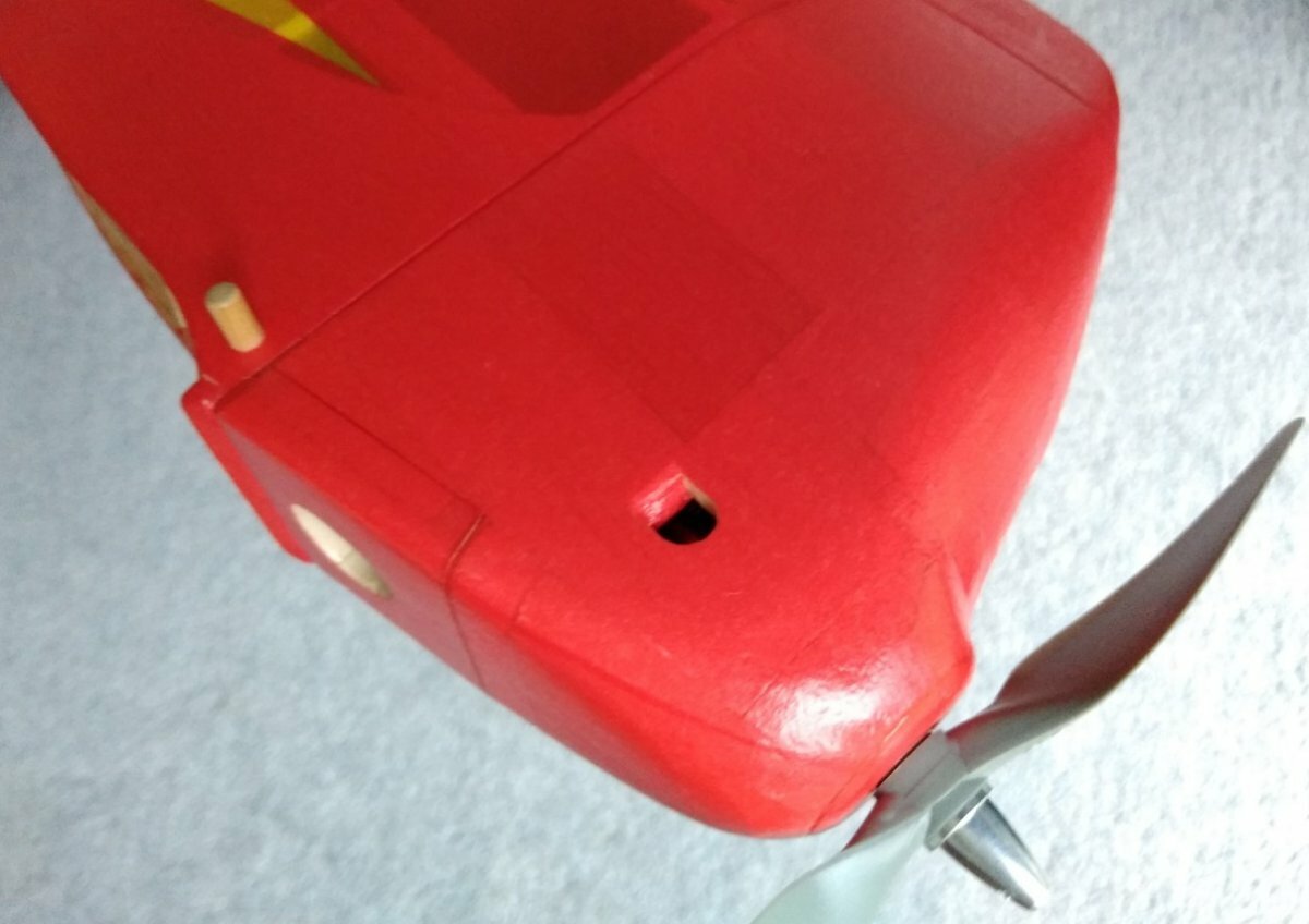

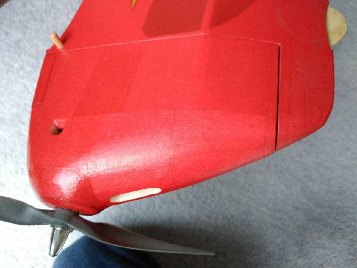

John T Posted March 11 Share Posted March 11 3 hours ago, Mike T said: I used it to cover some sheeted areas on my latest project. The dope doesn't seem to go 'through' it like it used to with modelspan. I've ended up spreading the dope with a brush and then 'ironing' it down with paper towel, to force it through the weave and get it to stick to the (pre-doped) surface. As Leccyflyer says, perhaps it's because it's formulated to work with water based EZE Dope. These photos are of the balsa cowl on my "Jersey Javelin". The EZE tissue was just attached using Wilco interior varnish, and as you can see, by keeping it damp it went around the compound curves ok with a bit of patience. I didn't have any real issues with the edges detaching. Quote Link to comment Share on other sites More sharing options...
David perry 1 Posted March 11 Author Share Posted March 11 They look neat. I’ll try eze next time although free flight supplies and mike Woodhouse is worth supporting I think Quote Link to comment Share on other sites More sharing options...
