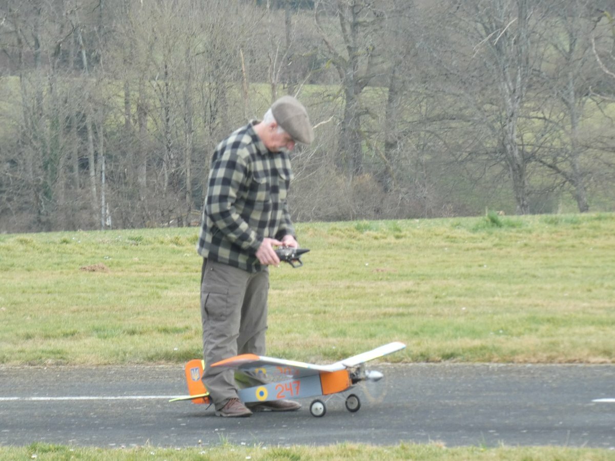

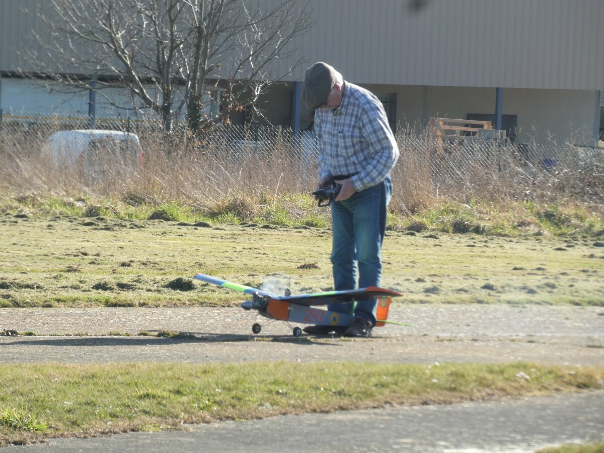

While practising for La Coupe Des Barons last week, one of the Flair wheels fell of into the plough and was lost forever. I am currently using small wheels but I would
lose points in the competition if I were to use them. Rather than pay 55€ for a pair of Williams Vintage Wheels, I'm going to have a go at making a pair out of balsa and ply as Cliff Harvey has for his Sopwith Triplane. Video here: https://www.youtube.com/watch?v=M2jzMr8K-UI&t=2s.
I notice that he has used 0.8mm ply discs seperated by 6mm balsa for the basic components of the wheels. Given that my Baron fitted with an OS 52 in the nose and with fuselage longerons made from basswood weighs 4lbs 4ozs or 1.9 kgs, do you think that 0.8 plywood would be strong enough for my purposes? I expect that Cliff's triplane is much lighter.
