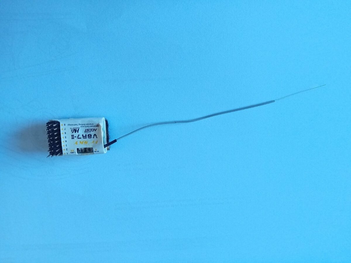

GARY BLANDFORD-HULL Posted April 3 Share Posted April 3 Hi everyone. Looking for some advice on receivers which will work with a FS-i6X transmitter. The receiver needs to be the same size as this broken receiver in the picture to fit into my model glider (Protech Topic 400 RC Motor Glider Cobolt) which has a very small fuselage diameter. In future I would like the receiver to work with a FrSky TaranisX9D Plus transmitter running EdgeTX version 2.10.6 when I can get my head around the programming required. Any help would be appreciated. Gary Quote Link to comment Share on other sites More sharing options...

Richard Wills 2 Posted April 3 Share Posted April 3 The FS-i6X is a Flysky transmitter, so you need a Flysky receiver. It will not work with an Frsky receiver. Quote Link to comment Share on other sites More sharing options...
GARY BLANDFORD-HULL Posted April 3 Author Share Posted April 3 Oh, didn't realise that they companies. Quote Link to comment Share on other sites More sharing options...
GrumpyGnome Posted April 3 Share Posted April 3 Your transmitter needs an AFHDS receiver. If you Google it, you'll find a number - some made by FlySky, some by others. If you upgrade to an FrSky transmitter, you'll need a MultiProtocolModule to be able to continue to use any receivers other than FrSky. Other transmitters can run Edge, and have built in MPMs - e.g. Radiomaster TX16... Quote Link to comment Share on other sites More sharing options...

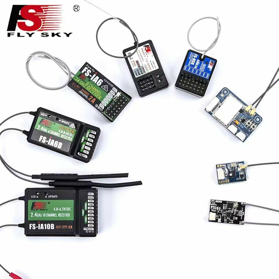

Dale Bradly Posted April 3 Share Posted April 3 (edited) Here's a few suggestions. Perhaps the FS-IA6 (10 o'clock position) Edited April 3 by Dale Bradly 1 Quote Link to comment Share on other sites More sharing options...
GrumpyGnome Posted April 3 Share Posted April 3 That looks significantly bigger than the OP needs to fit in the fuselage...... Quote Link to comment Share on other sites More sharing options...
