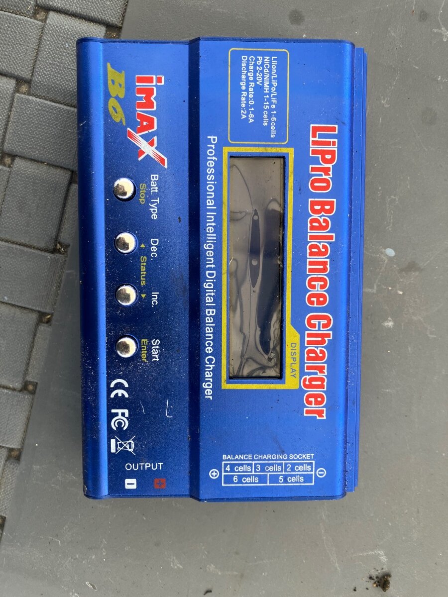

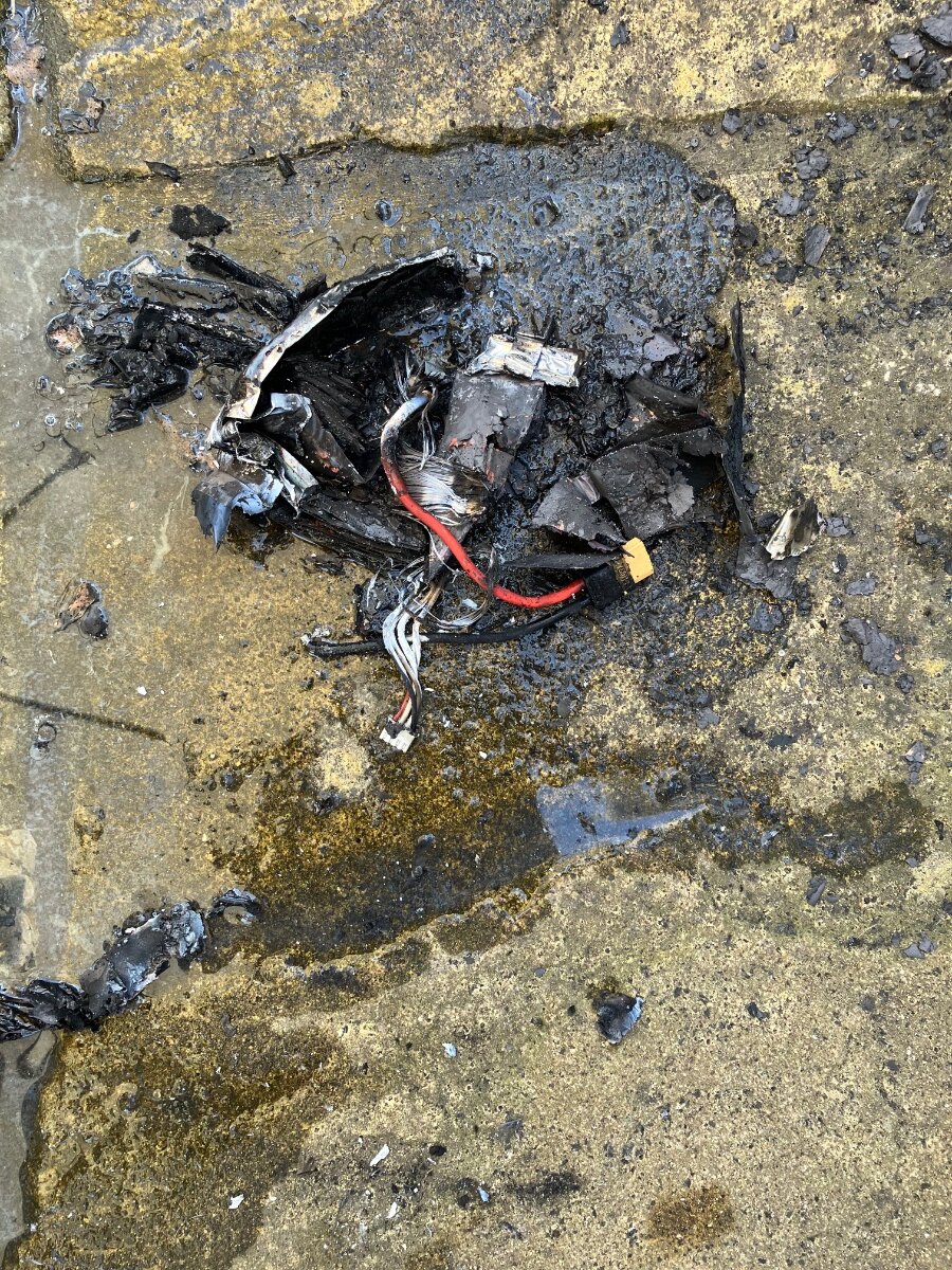

Cliff Bastow Posted April 13 Share Posted April 13 (edited) I have just had two battery’s catch fire on consecutive charges so I think my charger must be faulty. I was monitoring the second one. The charger beeped to indicate full charge, then the battery just burst into flames. Luckily I charge outside. Won’t be using that charger again! It is an IMAX B6 and is less than 5 months old! Edited April 13 by Cliff Bastow Spelling 3 Quote Link to comment Share on other sites More sharing options...
Cliff Bastow Posted April 13 Author Share Posted April 13 Quote Link to comment Share on other sites More sharing options...

PDB Posted April 13 Share Posted April 13 (edited) Where did you buy the charger from? Is it a genuine unit? https://www.skyrc.com/antifake/public/ Edited April 13 by PDB Quote Link to comment Share on other sites More sharing options...
Cliff Bastow Posted April 13 Author Share Posted April 13 I did not buy it PDP it was a Xmas present. Using the info you sent I think it might not be a genuine one! scary stuff! Quote Link to comment Share on other sites More sharing options...
Phil Green Posted April 13 Share Posted April 13 (edited) The SkyRC B6 is widely copied, I think the problem is that copies often aren't calibrated. Edited April 13 by Phil Green Quote Link to comment Share on other sites More sharing options...
