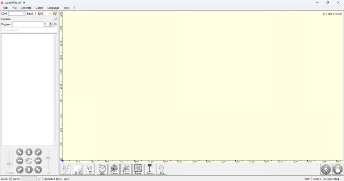

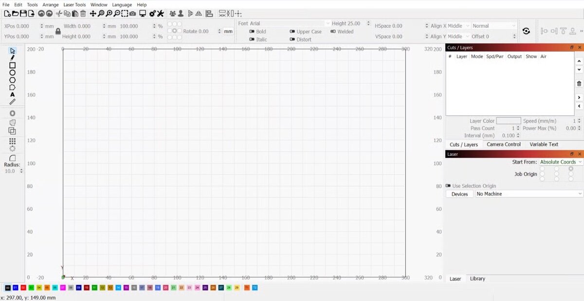

Ron Gray Posted June 20 Share Posted June 20 (edited) 40 minutes ago, FlyinFlynn said: just personal preference I guess That's about it really, I tried both (having already got Lightburn free) for about 3 months and found that the Lightburn, to me, was far more intuitive and less clunky that LaserGRBL which has a very dated (imo) GUI (see below). There are some machine settings (for my Omtech) that you need to use GRBL for as they aren't available in Lightburn, fortunately these were only needed during the initial setup of the machine. If I remember correctly you built your own laser cutter so I can see that using Laser GRBL maybe more suited, but for the vast majority of people they will be buying a commercial unit so do not need to delve into machine setup to level that you probably need. User interfaces Laser GRBL Lightburn Quoting another comparison, this time by All3DP Ultimately, the choice between LaserGRBL and LightBurn comes down to your specific needs and preferences. If you’re looking for a free and straightforward program with nice cutting capabilities, LaserGRBL will be your best option. If you use another image editing software, such as Adobe or Gimp, LaserGRBL will retain image detail and translate it into your engraving. Just keep in mind that it has limited photo editing capabilities and the learning curve can be steeper. Overall, it seems LaserGRBL requires more trial and error, but can yield good results. On the other hand, if you’re creating a custom engraving, LightBurn offers the easiest way to create, test, and visualize your project to get it done on the first try. Once you become more familiar with the interface and tools, LightBurn will allow you to create more advanced projects with less of a learning curve. However, its versatile capabilities come with a fee. All in all, if you’re someone who doesn’t want to fight with software, or has given up on other hobbies out of frustration, LightBurn will get you engraving thoughtful, beautiful items in no time. Edited June 20 by Ron Gray Quote Link to comment Share on other sites More sharing options...

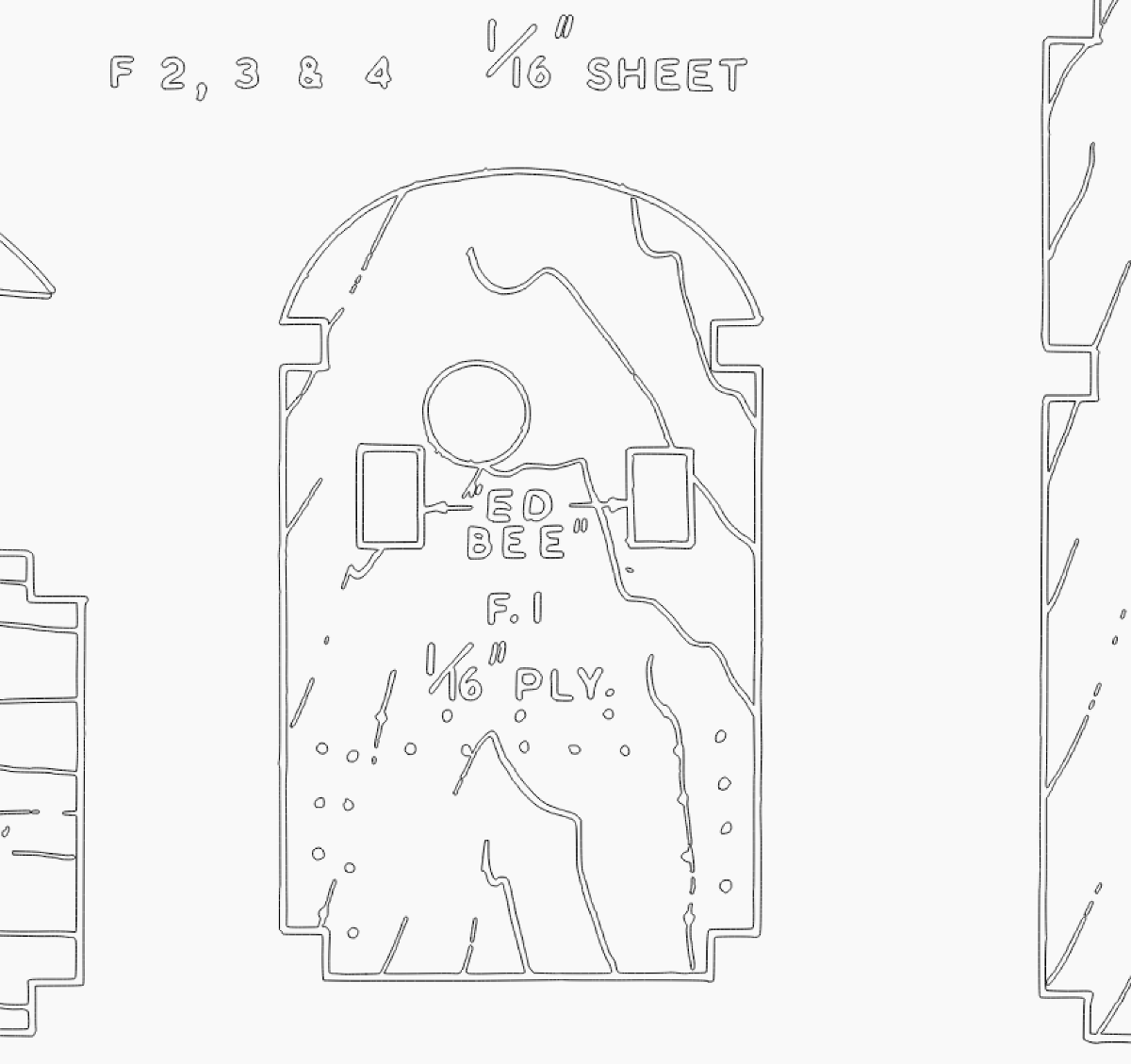

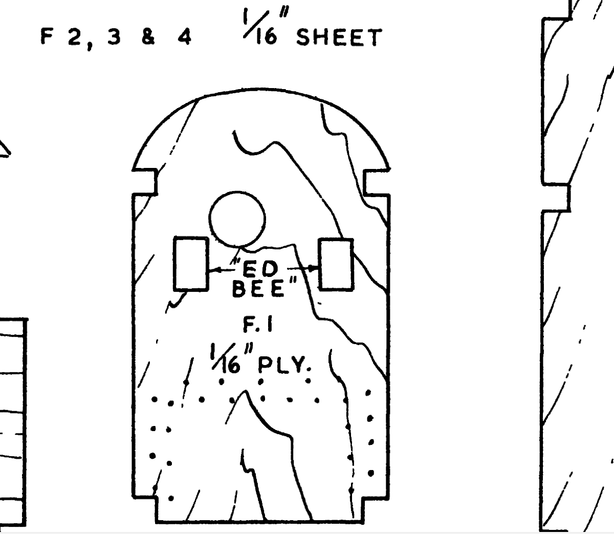

Richard Thornton 2 Posted June 22 Author Share Posted June 22 On 20/06/2025 at 18:03, Richard Thornton 2 said: Just throwing another brick in the pond. When using a drawing imported into LightBurn or LaserGRBL, do you need the lines to be polylines or are ‘standard’ lines OK. I ask this after watching https://itat-forum.bmfa.uk/topicid/77 Which just like Ron’s zoom was extreamly informative and have already made use of 2 functions whose icons have been sitting there all along just waiting to be used. Not had a response yet, any thoughts? Quote Link to comment Share on other sites More sharing options...
Ron Gray Posted June 22 Share Posted June 22 If you import an image of a drawing then you will have to trace it and you will end up with 2 lines, an inner and an outer. IMO it is far easier to actual sketch over the top of an imported image. If you are importing a dxf type file then, in effect, the lines have no thickness, just their reference points for plotting so no need to trace. Quote Link to comment Share on other sites More sharing options...
Richard Thornton 2 Posted June 22 Author Share Posted June 22 1 hour ago, Ron Gray said: If you import an image of a drawing then you will have to trace it and you will end up with 2 lines, an inner and an outer. IMO it is far easier to actual sketch over the top of an imported image. If you are importing a dxf type file then, in effect, the lines have no thickness, just their reference points for plotting so no need to trace. Many thanks Ron 1 Quote Link to comment Share on other sites More sharing options...
Ron Gray Posted June 23 Share Posted June 23 Pictures explain it better! Using Lightburn, the imported image After using the trace option to convert the image into something the laser cutter 'understands' There is software available that will allow you to automatically remove one of the lines, outer or inner but that doesn't always work as expected plus you still end up with less than ideal curves and corners that are not sharp. Quote Link to comment Share on other sites More sharing options...
