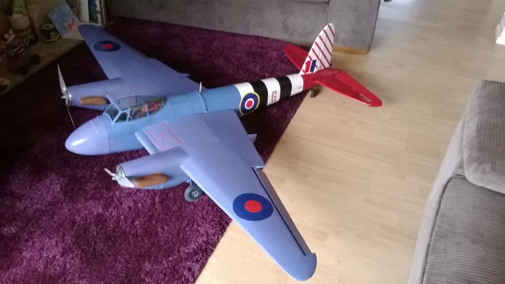

Hi Guys, after a heavy weekend of Work parties, I managed to fit in a quick test with an 11-8 prop, she came out at 45 amps and 690 watts, so all in all I'm in a lot better place than when I started. Here's a picture. As I say I have no info as to who manufactured her but here she is set up for electric, I reckon she has quite a good scale look. Regards John

PS it's not the black horse mossie, it's an old ic plane that I bought in the late 90's and I've since thrown all plans paperwork away so I have no idea who made it. It has foam wings and fuz, with rather thick plastic parts for the nacelles and gear housing. I'll stick it together and post a picture, someone might recognize it
