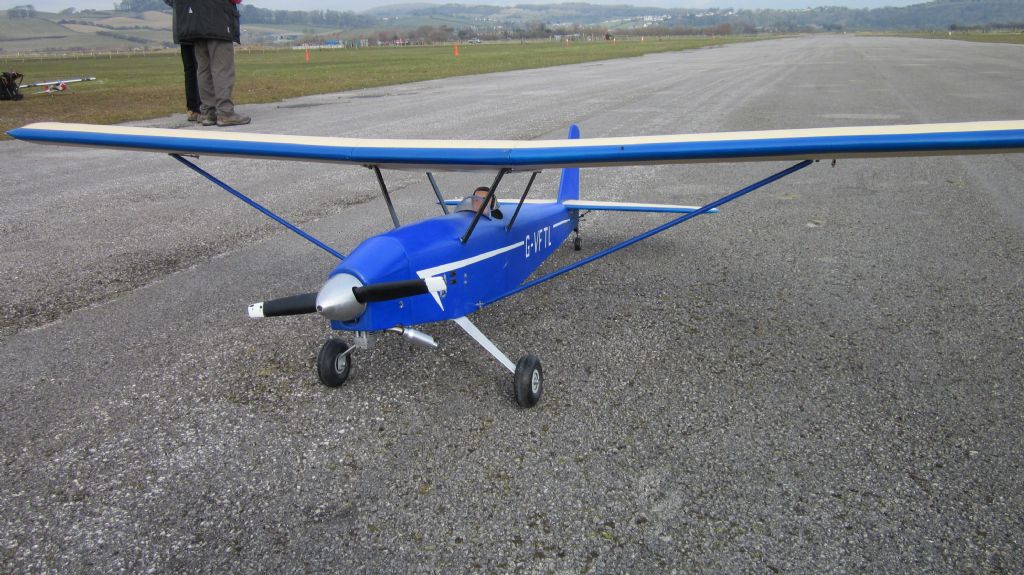

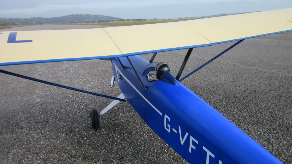

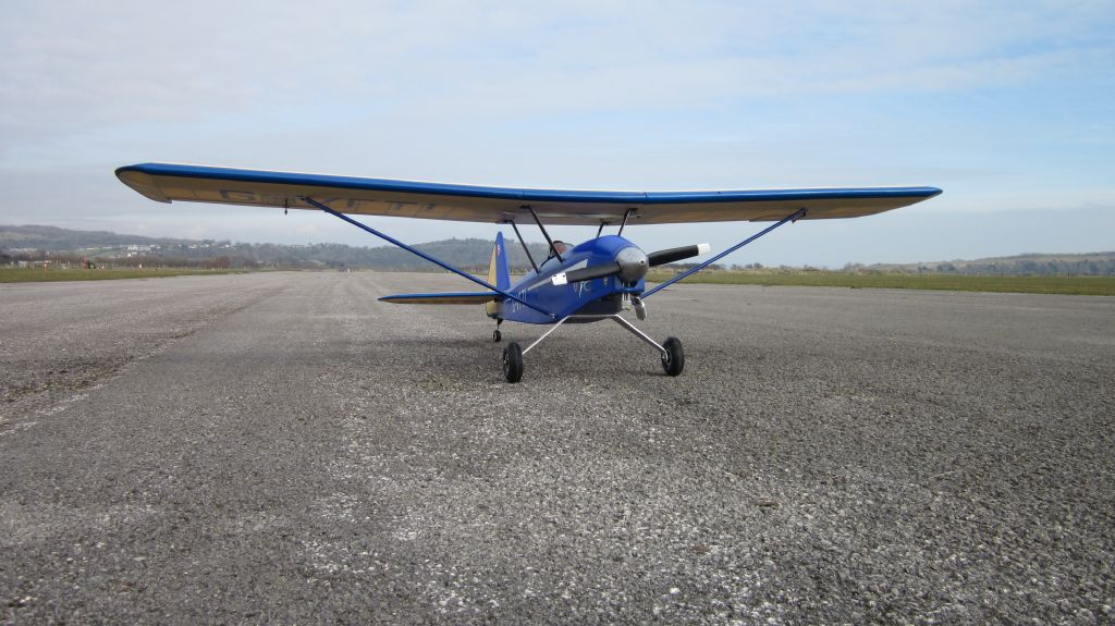

This is my modified Mighty Barnstormer. It was built from Boddo's drawings, with some improvements, the wing centre section being fixed and the wings being fitted by means of two steel rods each side, the aileron wire connection being made via. MPX plugs and sockets, so the wings are just slid on without messing around with loose wires & plugs. With this method struts are required to take the wing loading, which make the model appear more scale-like. The maiden flight took place today, and the model flies perfectly, including looping and rolling nicely. The wings are held together tightly by means of a strong rubber band underneath, pulling on a couple of protruding screws (not visible in flight)

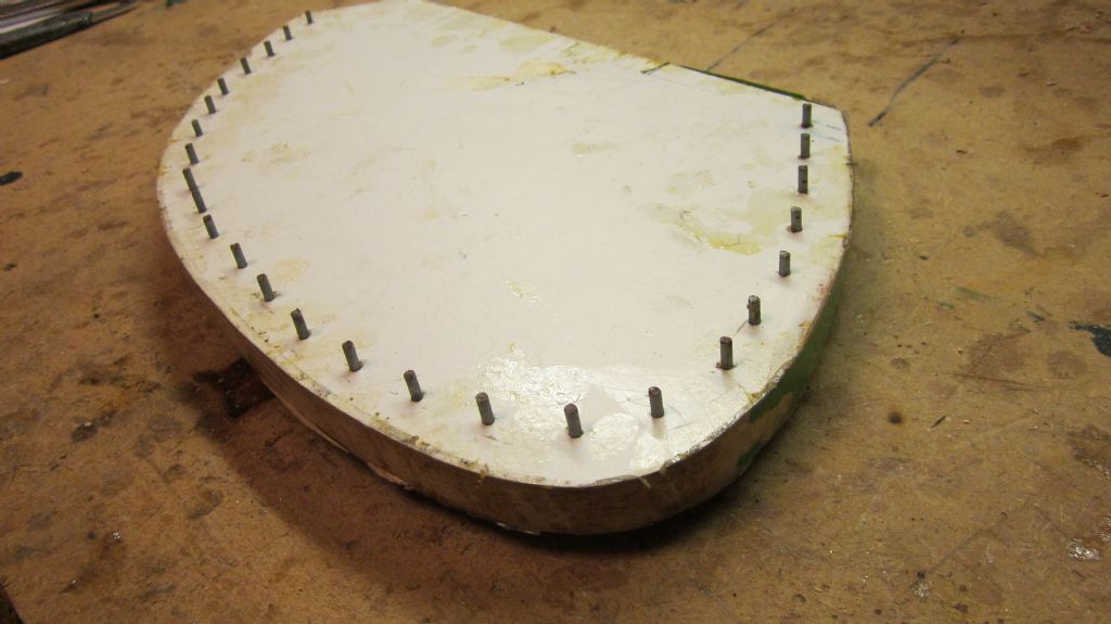

Referring to AVC's excellent instructions for laminating balsa strip to make the outline of wingtips, rudders and tailplanes, I agree that this method is very easy and results in a very strong outer structure.
When bending the strips around the former (I find just a couple of hour's soaking is enough, unless the bend is very tight) I previously hammer-in nails all around the edge of the former, about 1" in from the edge. Then, when the final strip is in place, I wind rubber bands all around the nails, ensuring that the strips follow the former outline exactly. I usually make the former from 5/8" chipboard and cover the chipboard edge with sellotape
Photo shows the former for making a Tiger Moth rudder)

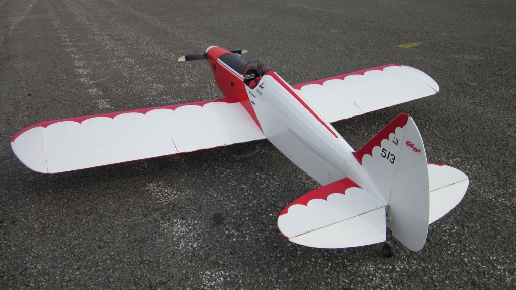

Fellow Ballerina builders may be interested in my method of attaching the engine cowling. For me, this was the only tricky part of the build (the magazine article does'nt mention this bit - the cowling appears to be permanently fitted with no join line visible.... )
My cowling is easily fitted: - two lower dowels firmly locate the cowling, and the upper part is secured by magnets. In use the cowling is simply pushed on, over the engine.

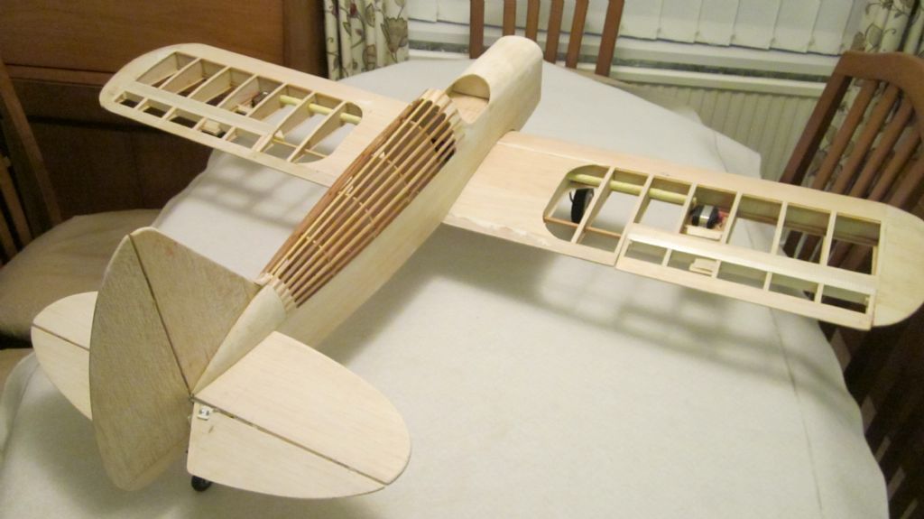

Re. the Ballerina: I found it to be a really pleasant build, no complications and a nice-looking design. I've ordered an OS48FS engine off e-bay and intend to fit it as in the magazine article.
