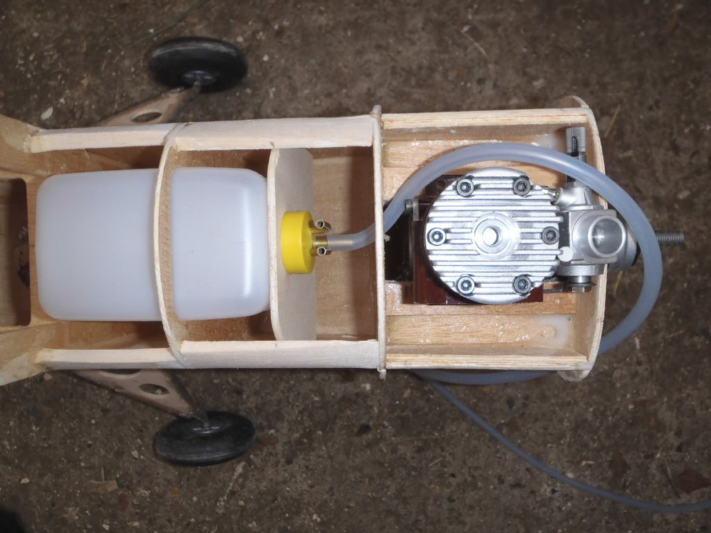

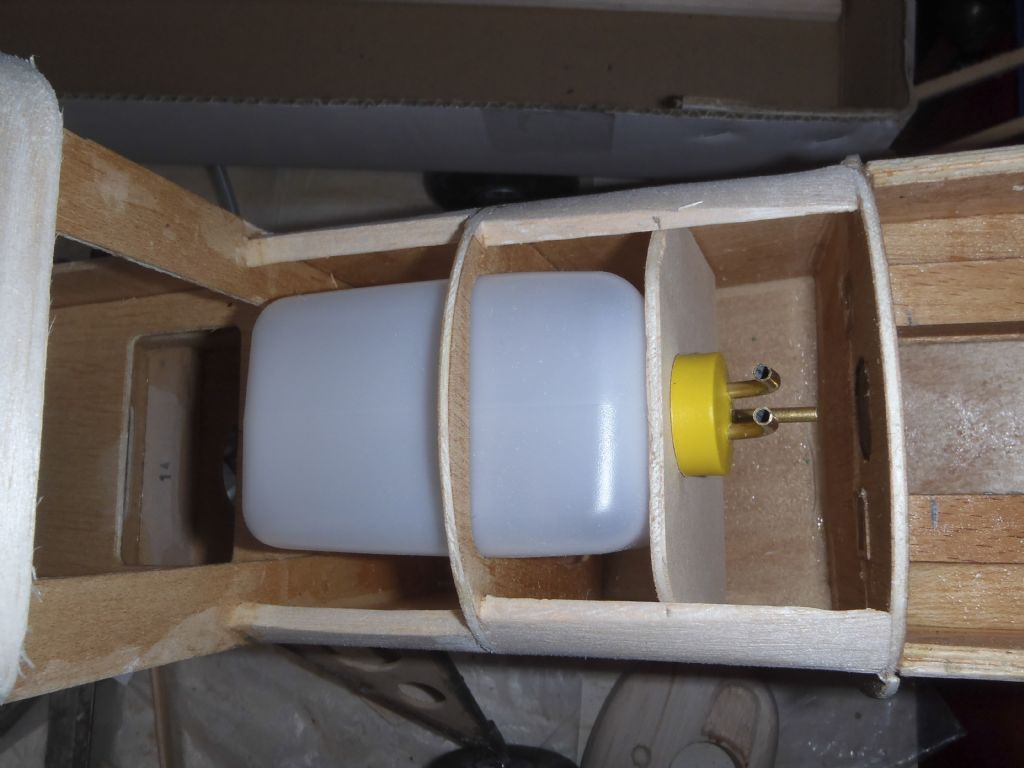

I've just downloaded an viewed the images that you sent me, so I can see how you fitted your engine and the mods you made to the bulkheads. If I'm not mistaken you tank appears to be as far back as I'm proposing to site mine ( with the rear close to the servo tray) - am I right? Also, the filler, vent and fuel pipes all appear to exit at the underside of the model - so these pipes don't need to be upright then?

I guess I'll move the tank back then, as that will be the easier and neater solution. The only drawback as far as I can see is that the filler and vent pipes will have to come up through the upper decking, rather than the engine bay. Fitting my engine inverted would have been a neater solution, but as the bulkheads and lower sheeting are already in place it's a little late without major surgery - so, upright it'll be and I'll live with the removal of the front sheeting.

Thanks for replying, but first, my name isn't Simon! Chamfering the bearers, as you say, will be quite straightforward. I understand your point about the sharp corners, so as not to introduce stress points. My thought is that rather than resort to buturery at the front end I'd prefer to move the tank back; this will necessitate adding a partial bulkhead behind the present one in order to support the tank neck. It will mean making 2 holes in the upper decking as well for the and vent pipes.
Now a couple of questions: if the fill pipe is blocked of during flight, does it have to be upright? Also, if the vent pipe is connected to the silencer, does this need to be upright? If the answer is no then I can bring tubing from these through the bulkhead, rather than up through the upper decking. Regarding the fuel tank: I figure I've got some leaway, as the bigger engine is heavier than the smallest engine for this model. How far could I get away with moving the tank back? By passing the fuel tubing through the left side of the bulkhead, rather than using the original centre hole I guess I could manage the centimetre, but it will be quite a fiddle. If I move it back about an inch it will be far easier. If I can get away with most or all of the above it will save me chopping great chunks out of the front end! As it is, most of the front decking will have to be cut away at the top to allow the engine in, access to the needle valve and access to the engine bolts. - because the engine hasn't been run in yet. I'll also have to provide some relief at the front bulkhead for the throttle linkage, because at the extent of its travel it just touches!

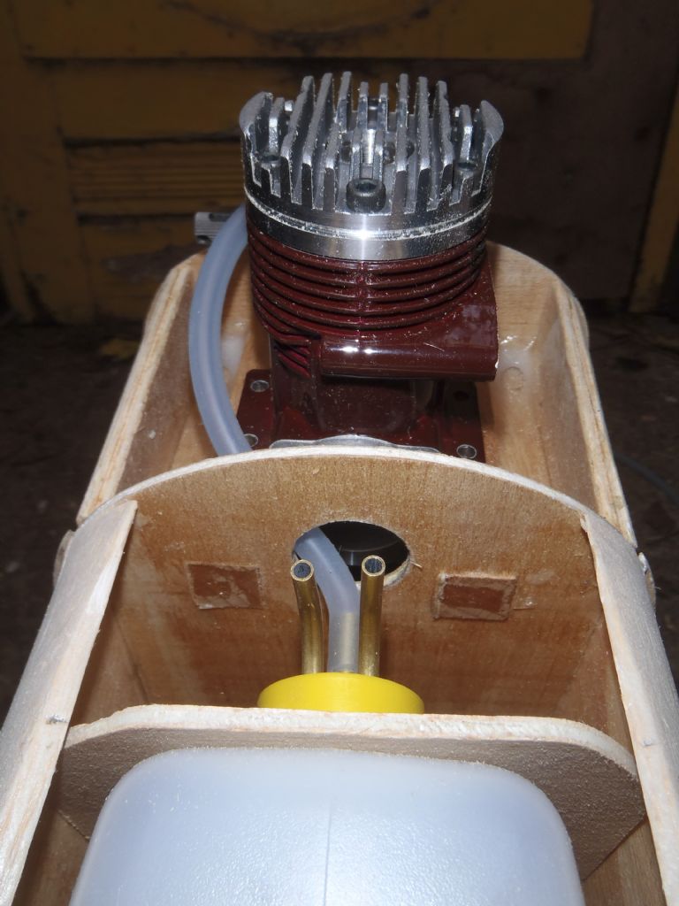

Wouldn't it be great if things were easy! Today I decided to trial fit my Ervine 40 so that I could work out where to bring the push rod through and where it would sit to allow the fuel pipes through, prior to fitting the top cowl sheet.
The first problem is that the engine doesn't physically fit between the bearers! This will only require some minor fettling of the inside top edges of the bearers to allow the crankcase to fit in and not enough to compromise their strength. However, with the engine moved forward to the front bulkhead there isn't sufficient room for the fuel pipes and tank cap to come through! This means that as the tank has to go in before the engine ( because its under the sheeting) I then won't be able to slide the engine in!
There appear to be 3 possible solutions to the problem: buy and fit the smallest allowable engine for this model; cut the front bulkhead and probably part of the nosepiece too; or make an additional bulkhead and move the tank back. I'm quite reluctant to start buturiing the front end as I'm worried about reducing strength, but my feeling is that this might be the only way forward.
As this model was designed to take glow engines up to the size I have I would have thought that suffient space would have been provided. I guess I was nieve!
