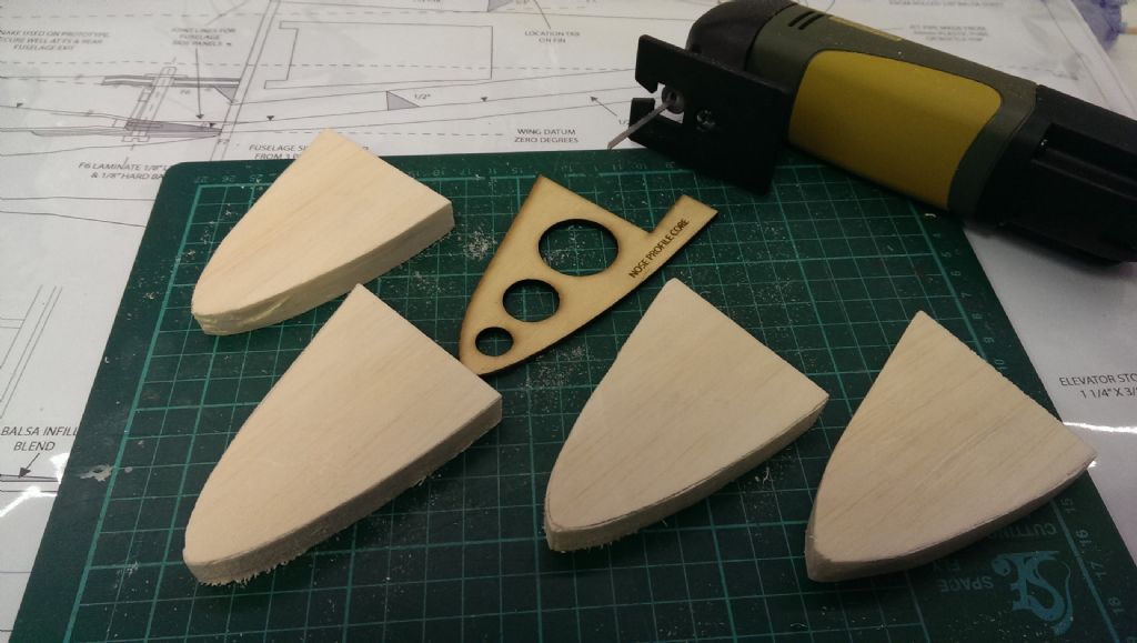

Not much done last night as I don’t have the ¼” balsa for the front fuselage. Rather than do nothing I worked out if there were any bits I could prep ready for later along the build. So I cut out the ½” soft balsa for the nose. I cut out a pair using my usual S&M scalpel but they were a bit rough so I though why not use my Proxxon jigsaw. Proper job!

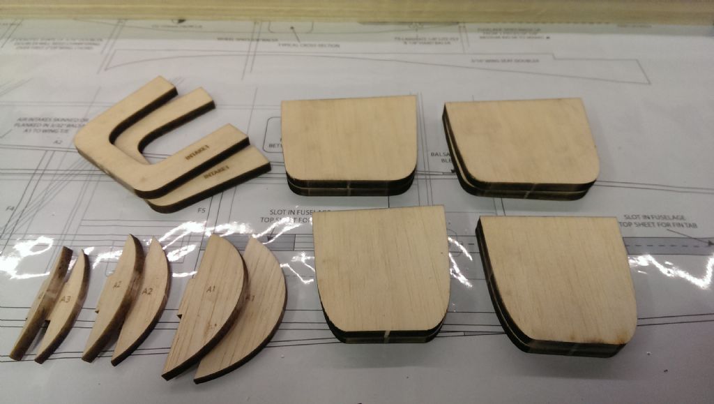

I also cut out the intake parts and formers ready. I spent the rest of the time tiding up my workshop, it’s amazing how tools seem to spread themselves out everywhere.

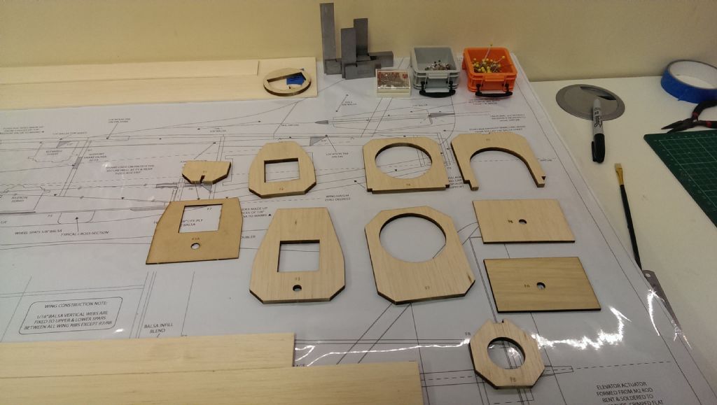

I've split this post out from my usual ramblings as it's worth highlighting. Phil emailed me earlier today pointing out that I hadn’t inserted the captive nut into F6. Now I was aware that it needed doing but reckoned on it being done later down the line. I am so glad Phil emailed and said to do it now before I went any further. It wasn’t the easiest job to sort out as the hole is 6.8mm and my captive nut was 7.5mm. Ordinarily with a block of softwood I might pull the captive nut into the wood but I thought that was likely to cause damage to F6 with the hole about 1mm too small. So carefully I opened up the hole with a 7.7mm bit and also made four small 3mm holes to ‘pilot’ the prongs from the nut. The later might be over-kill but I wasn’t convinced that the prongs might not damage F6 when it was pulled home. I also added a dollop of super glue to the nut when I was happy to make sure it wouldn’t go AWOL on me.
My advice, get the captive nut sat in F6 before you add it to the first fuselage side. It’s gotta be much easier than what I did.

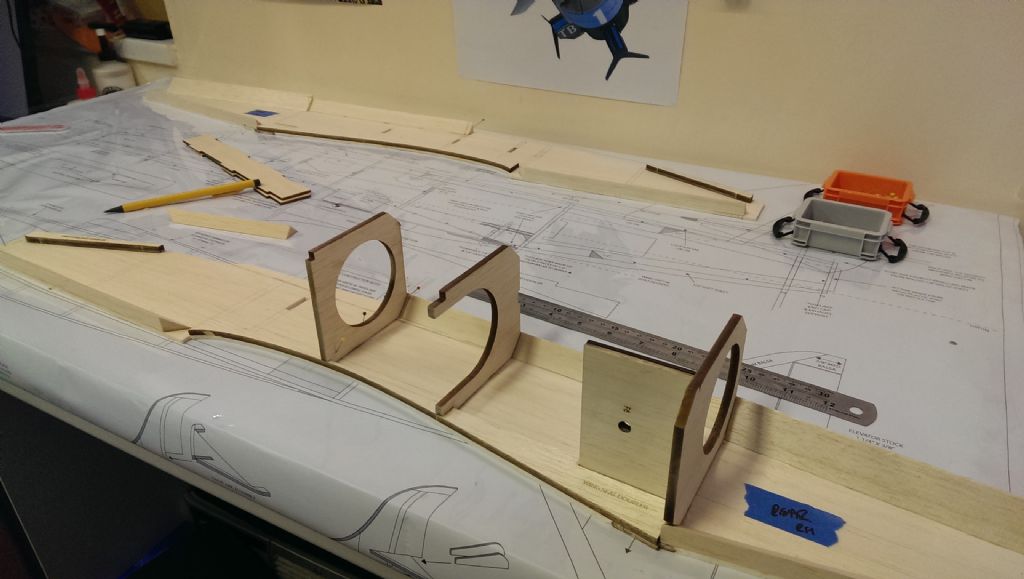

Having left the battery box half done I started by setting the other half so that it would be workable a bit later and complete the whole box. The theory of doing two halves was that if they were both square then the whole assembly would be square. Like Hannibal from the ‘A-Team’ says “I love it when a plan comes together”

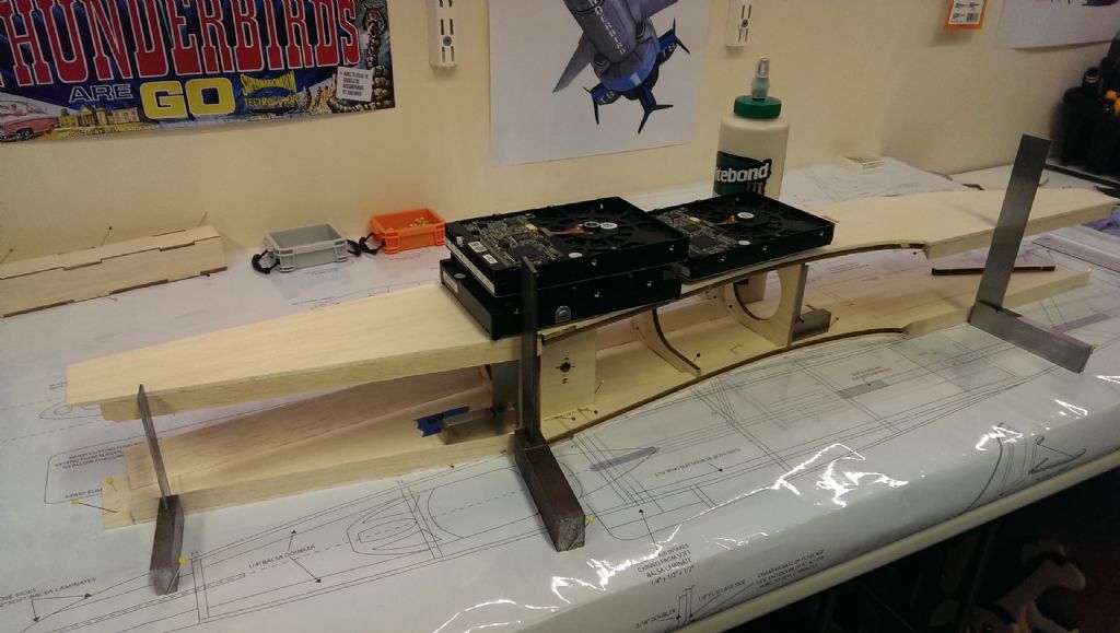

In between the battery box part drying I proceeded to put the two fuselage sides together. Now for some reason F6 and F7 didn’t want to sit right, being 1mm higher. This would mean that the whole thing would be out of shape if I left it like that. Now I measured every thing from the distance from the datum to the wing seat doubler where F6 sits to even putting the fuselages sides back to back and it was all the same. There was nothing wrong with any of the formers and it should have all gone together nicely, but it was having none of it. In the end I made an executive decision to remove 1mm of the wing doubler where F6 sits. Once that was done it all lined up bang on.
With the fuselage setting against as many engineers squares I have (maybe I might get a few more :D) I moved back to the battery box and following the magazine I dry fitted F2 & F3. I dug out my ¼” to do the bottom for these to sit on and disaster! I’ve only gone and bought 3” sheet instead of 4”

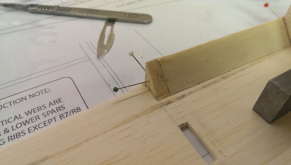

Having cut out all the triangular section I glued these down. As it turns out I misinterpreted the plan and cut the section over the wing too short and not following thru to the front of F4. Also despite pictures in the magazine I also cut short the section that intersects with F3. It’s not the end of the world and some fillets will fill those gaps.
Now I didn’t notice the F4 issue until I got to the gluing it in F4 and so a little MacGyver was required. It was also at this point I discovered that my ½” triangular section is 9/16th on one side so I’m going to have to watch my joints and any affect it has on the interface of with fuselage formers.

I've also cut and tidied all my formers and made up F3 and F6.
