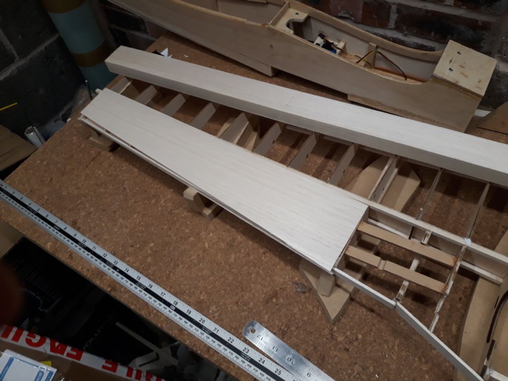

Initially when I placed it on the board I thought it was horribly twisted. Then I realised I had not factored in the fact that the wing was partially sheeted. Once I had, then I checked and it's probably the straightest wing I've built. Pleasing! Stiff now too.
Next is to build the other half of the wing onto this half.
Making jigs to turn the wing over.

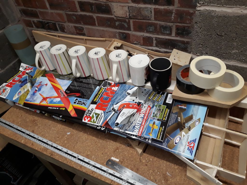

And then turned over...
And now glued. The mug row is on a bit of wood on the jig tabs to maintain straightness. I'm confident it will be straight when revealed. Next is either to do the other side of the wing or make the flap and aileron for this side, not decided yet.

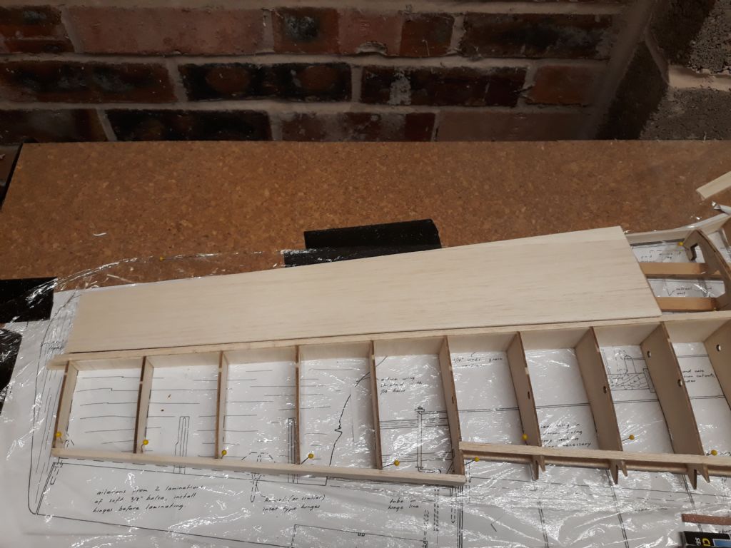

Front centre section done with the famous Mustang leading edge starting to exist

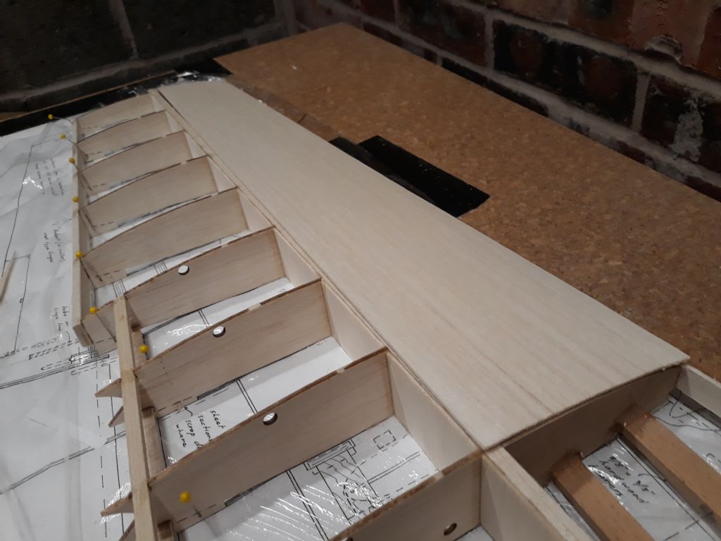

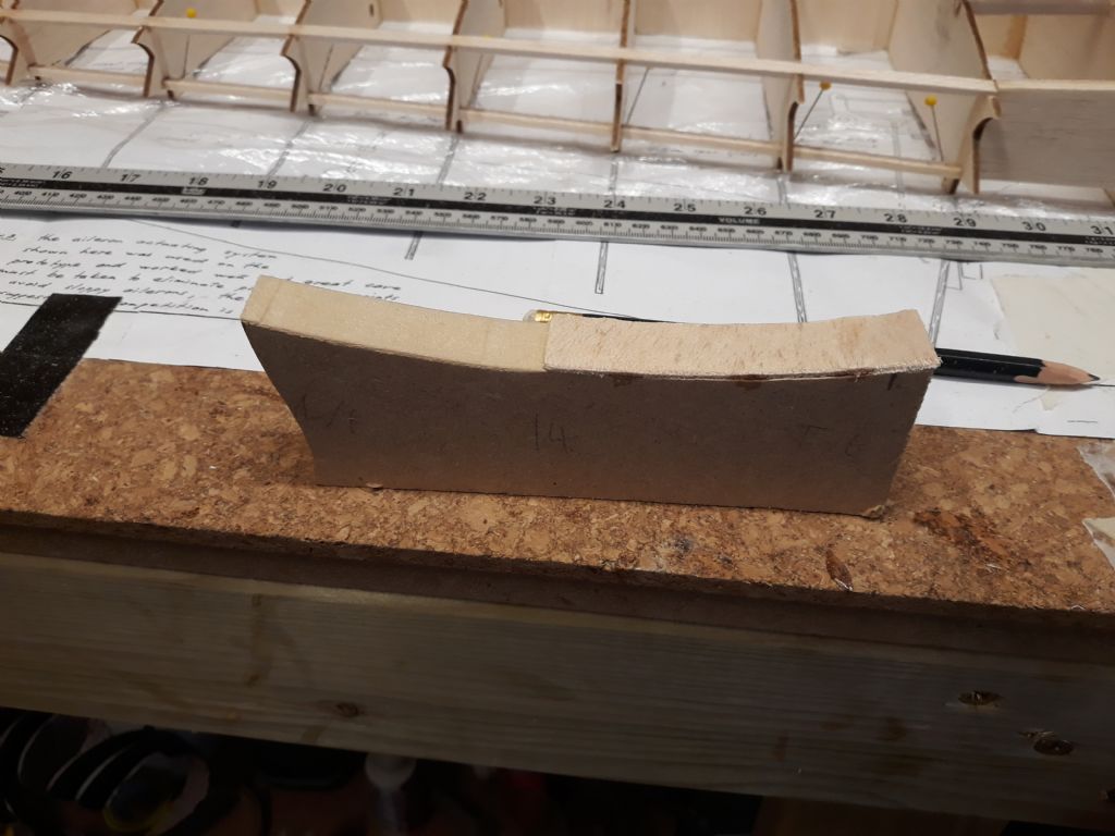

As the designer specifies on the plan, the d-box is skinned from the outer retract rib to the tip, and then the wing is flipped over and the same done there. This stiffens the wing but leaves access to the aileron and flap areas. There's a great build on RCSB ('Mustang second time around' ) which I'm copying extensively, and he found this method worked as long as the wing is jigged when flipped to skin the other side. So I'm going to copy! I made up the skin...
...then wetted it and put it in position (no glue). I will leave it overnight, take the magazines off before work to let the wood dry fully and glue tomorrow night. Never bothered doing this before, but making an extra effort to improve quality with this (even rejected the first wing skin I made due to an unsmooth finish!)

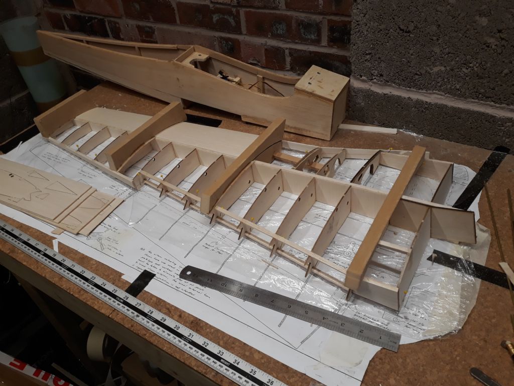

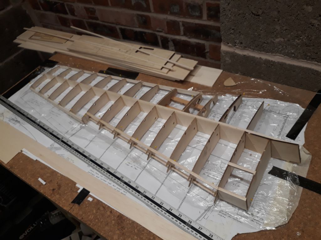

Been a while due to many other things getting in the way, but now I am getting started properly on the Mustang.

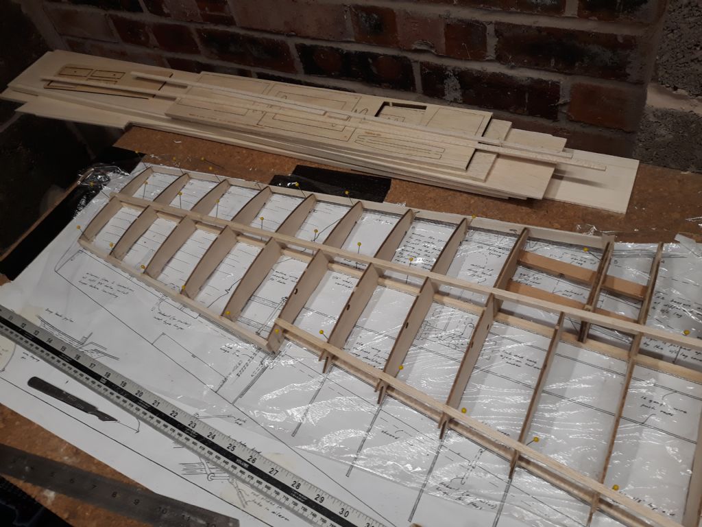

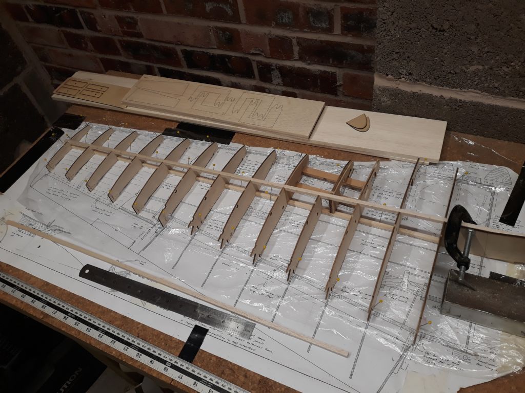

Wing ribs glued to the lower spar. I usually put the top spar on immediately, but for this it seemed best to do this prior. Made one mistake by glueing the ply wing joiner on the rear of the spar rather than the front, but I can just mildly change the design so it's not an issue.
More tomorrow to give the pva a chance to set properly.
