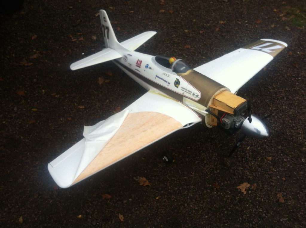

you wouldn't believe the effect that the flapping film had on the aircraft. I needed full left aileron to keep the wings level, so my flight path back to the landing area was interesting. I could have done with some bicycle clips! To be honest, as a relative novice, I feel that coping with the issue has made my feel more capable of dealing with problems that arise. A good learning experience. Mind you I have had a few of those - when does it stop???
There was no sign off fuel seepage and it is a sheeted wing so no foam in sight. I guess a loose corner then the air got under it. Anyhow fixed now with a good application of Balsaloc and a hot iron. The rest seems reasonably well stuck down, I will keep a careful eye on the other wing now!
So, I popped out in a break in the weather to give the Rare Bear an outing. This jobbie flys like a brick and is a devil to get airborn off grass (especially long wet grass). Anyhow, found I left the important bit of tube to allow me to fill her up through the valve, so off with the cowl. Three flights in, the nerves were settling down and I was getting the confidence back, then Wallop, lets turn right shall we. I could see something flapping on the wing and thought that the aieleron had come loose. Anyhow, I managed to get back to the strip and put her down.
Ok chaps, what did I miss in the preflight? Could I have foreseen this? The good news is that there is no damage

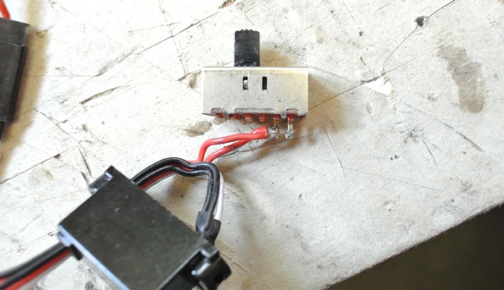

just to be clear, the third wire that is not clear in the photo went from the end pole to the receiver, I think the wire broke and that was that. The switch works by making/breaking a circuit in the positive lead. I have no idea if this is normal or not as I have never dismantled a switch before.
I have no idea where the switch came from it was on the plane when I got it. I doubt its home made as the case and the top plate look very commercial. So what could I have done? What could anyone who purchases a second hand airframe do? Check and replace every component? I have flown that aircraft probably about 100 flights. I double check all fittings regularly. I did not take the switch apart to see how well it was made, but then I did not strip all the servos either. Ok not an obvious brand name switch but hey, i wouldn't recognise a spectrum or JR switch as I use Futaba usually.

I think a cheap switch. I should have changed it when I bought the wotty, it was second hand though all the other components seem good quality. the two red wires are soldered to one terminal. The third wire ( sorry can't be seen in the photo, is soldered to the other terminal. That joint failed or perhaps the wire broke.

This time I can prove it was not pilot error!! 5th flight of the day, model checked and tested, 5 minutes in to the flight, slow roll followed by complete lost of response. The acrowot just rolled into the ground, total write off. see below the picture of the fault. The solder between the contacts on the switch had failed. Now how was I supposed to check that? I suppose a new switch every year is the only answer??
