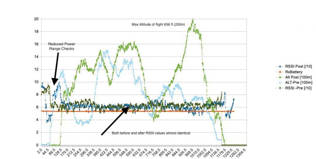

The picture below shows the before and after telemetry plots for the GRX8R.
I am very happy with this as there are no dropouts over the course of the 20 min flight and the RSSI levels are virtually identical both for the preflight range check and the flight itself. The lowest recorded in flight was @50dB at 650 feet. The vert speed I have omitted for clarity but suitably bounded and combined with an audible beep I find makes thermaling much easier.
The next plot is for the RX6R. I belatedly realised I had not kept a pre update telemetry plot for the RX6R but the RX4R must be virtually identical ( firmware is the same) so I used that .
Given that the flight profile for the RX4R was much different ( Gnat as opposed to a glider !) I am again very happy with the correlation.
I guess I had never looked closely enough at the absolute levels of RSSI value between different Rxr's but they do seem to vary. I have heard that the RX6R has a greater range than the RX8R so perhaps there is some design consistency ( especially I guess since we probably all use the same warning level from one Rx to another ). I'll leave that one for those that know to elaborate on if necessary.
I will test fly the RX8Rpro as soon as the wind drops but all in all I am very happy to go fly with the upgraded firmware.
Apologies for the perhaps excessive detail but I thought it might just inspire confidence in those yet to undertake this upgrade.
