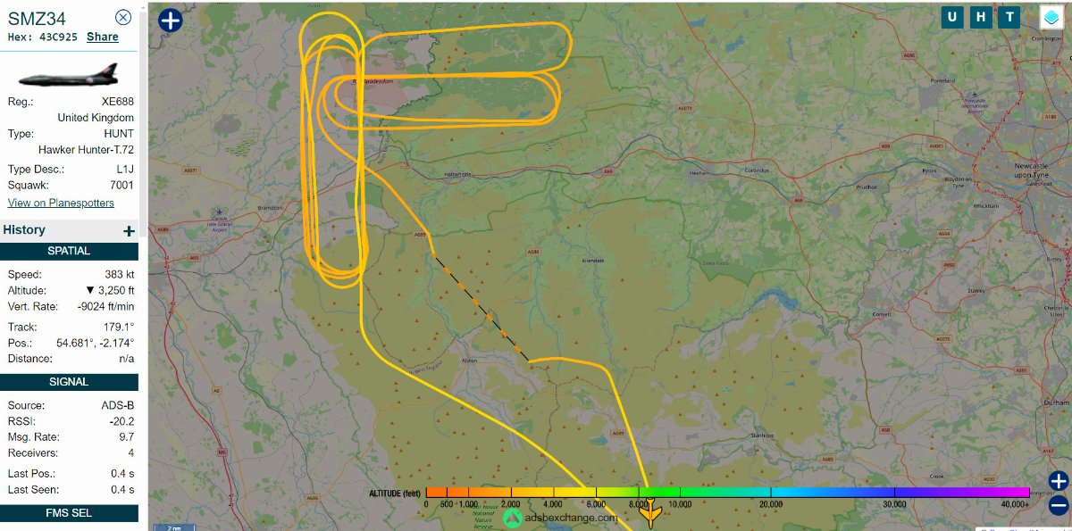

Thanks Focae, that's the one. Wonder why it was doing circuits about 15miles east of Carlisle.
