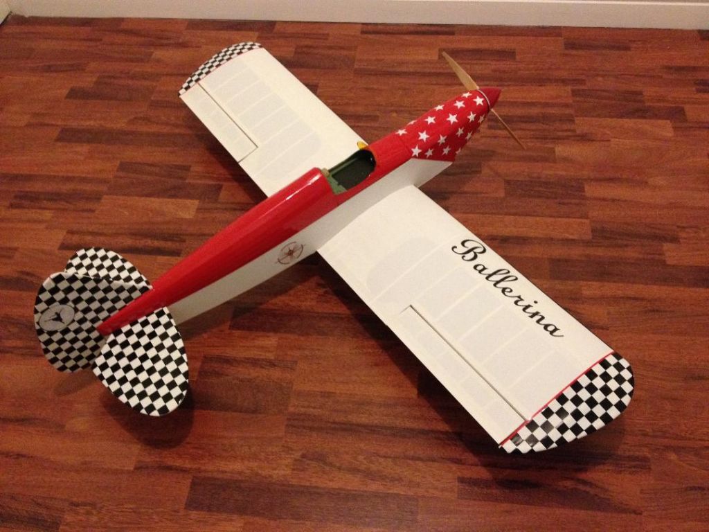

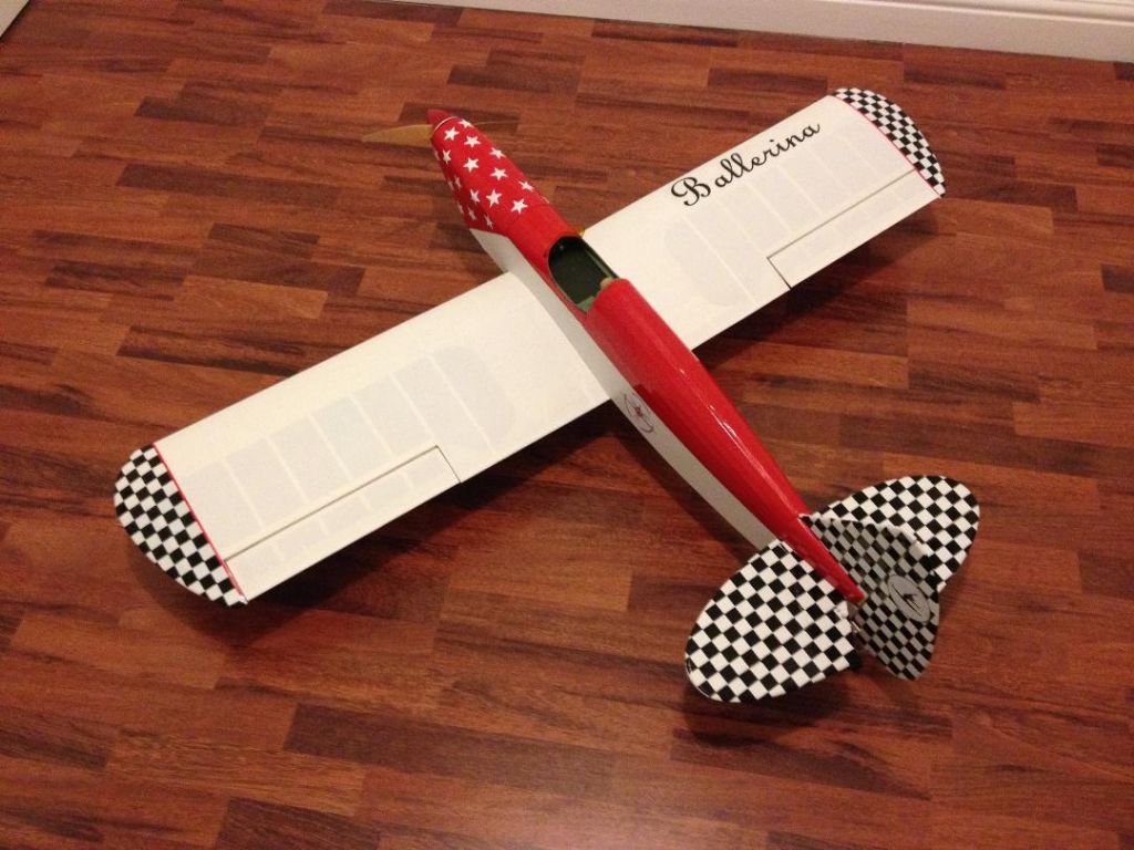

Hi all, Just when you thought it was all over lol!
So I finished the build in March this year (2020) but then the lockdown happened and our club field closed, I never got the chance to fly Ballerina.
Then today, following the government and BMFA guidelines and beautiful weather, i grabbed the opportunity to maiden her. I always fly my own aircraft for the maiden.
I worked hard to get the C of G right and I thought I had, nose down tendency when fingers placed on main spar position, model upside down with battery installed.
So I took off.........fairly quick in to the air but straight away I new it it was too pitchy, very hard to control when ever I applied elevator. I gained height and levelled off and found with no pitch inputs she flew very nicely, quite nippy too.
I tried to do a few practice approaches, wanted to get her on the ground as soon as possible but it was clear that my work was cut out to avoid taking home a bag of splinters.
Anyway, did my best, suppose the lack of flying over the last few months didnt help. Ballerina's wheels hit the ground pretty hard and she bounced back up in the air about 6 feet. By this time she had stopped flying, fell to the ground and cartwheeled a few feet.
Happily though, the only casualty seems to be the prop and maybe the undercarriage a bit bent........ good job it wasn't a not so cheap ARTF!
My Ballerina has an AUW of 2.2KG, I think i probably put about 200g of lead in the nose to balance her. I have set all the controll throws to the initial recommended settings.
Does anybody have any views on this? my first thoughts are with the Centre of gravity and I need to invest in a proper jig to ensure I have this right. What else could it be?
I am keen to get this sorted cos I'm sure when it's right she will be a great plane to fly.

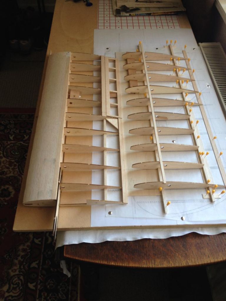

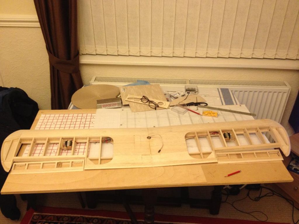

Just an update..... I'm taking my time lol, but the wing is almost finished. I practically have an ARTF kit now and am focusing on the build now as I want to finish it for our annual build competition at KADMAC in March.
So I haven't gone away, I'm still building my Ballerina. As you can seeI have started on the Port wing and hoping to put many more hours in to the build now the dark nights have arrived.

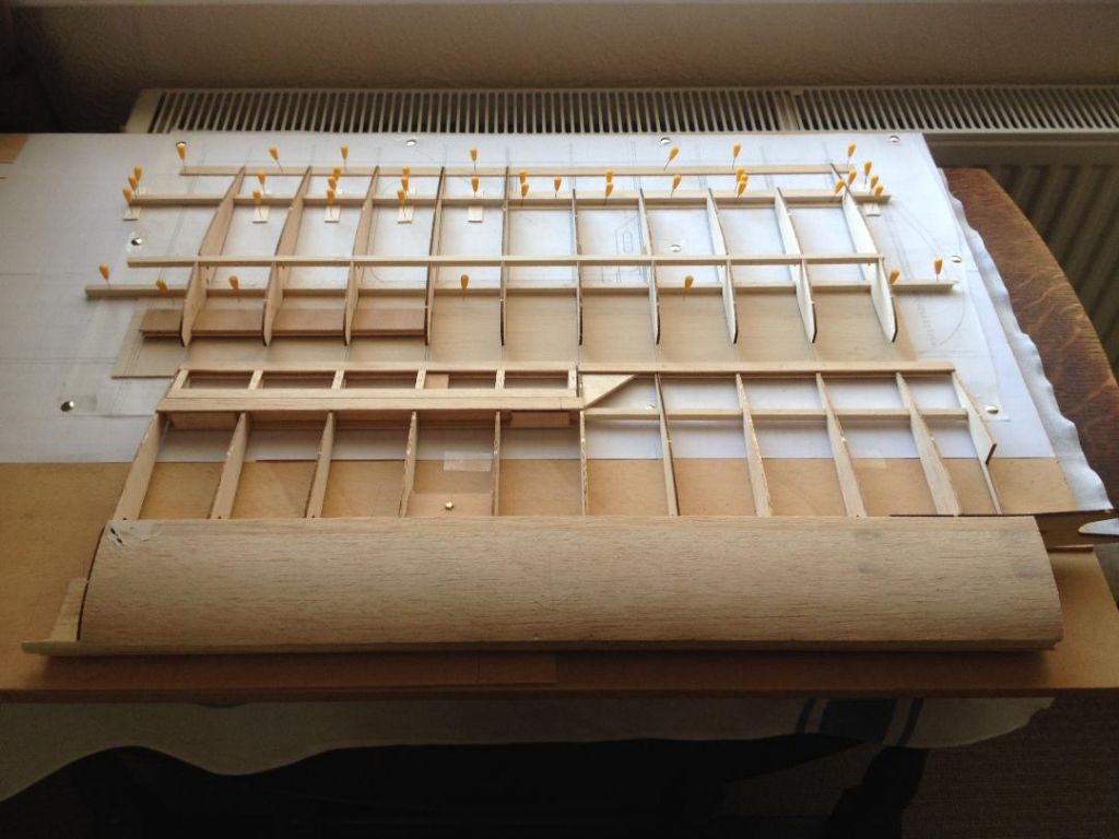

So work on Ballerina is going at a slow pace but I don't have to worry about being the first one to finish lol. This is progress so far on first half of the wing.
Looking forward, as far as the undercarriage goes, apart from the undercarriage saddles has anyone used apoxy to secure the undercarriage struts. Is this necessary?
As the nights draw in I expect to have a lot more time during the winter months to finish this project in time for our Clubs model building competition!

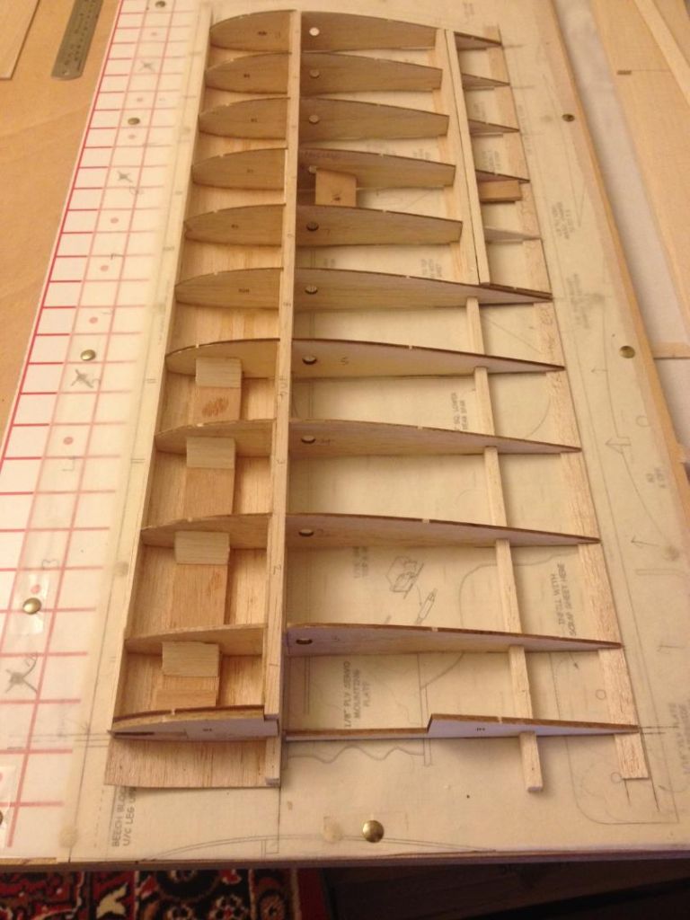

I have started work on the starboard wing, not glued much yet cos I want to see how things fit together and sort out any difficult bits which can be done easier and better (or more correct) early on in the build. An example of which is placing the mounting supports for the aileron bellcranks to the relevant wing ribs. I decided to keep to the original plan and use 1 servo for both ailerons.
From what I have read, I understand R1 & R1a should be glued in position on the first half of the wing 90 degrees to the spar, as are all the other ribs. The angle when the two halves of the wing are joined is created by R1 and R1a on the second wing half (port wing) when they are joined together. Is this correct?
I will post pics as my progress with the wing continues.

Hi Mark
The CG should be at 25% of the chord back from the leading edge.
Thanks Peter.
I have balanced it "approximately" on the main spar, I assumed that was where it should be as that seems normal with most models. I say approximately as I just use the fingertip method which I'm guessing isn't all that accurate. Looking at the plans again, 25% of the chord from the L.E, would put it about 1 centimeter forward of where it is now. I have read the dire consequences of an aft CofG today, would that much difference make it so unstable in pitch?
The symptoms certainly suggest an aft CofG
BTW, I checked my elevatorthrows, function, end points and expo but all seem to be OK.
Think its time to invest (or make) a proper CofG jig.
Cheers
