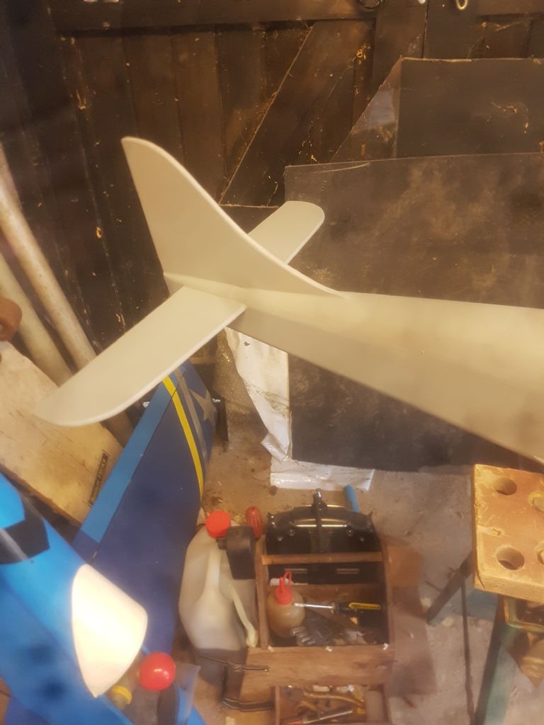

I'd been watching the weather forecasts to find an evening to fly. This evening showed a nice gentle northerly, but also rather a lot of rain, so I went back in the garage!
Airframe is now doped and the first coats on. Light grey on the underside and a darker grey on the top. It's starting to look good now.

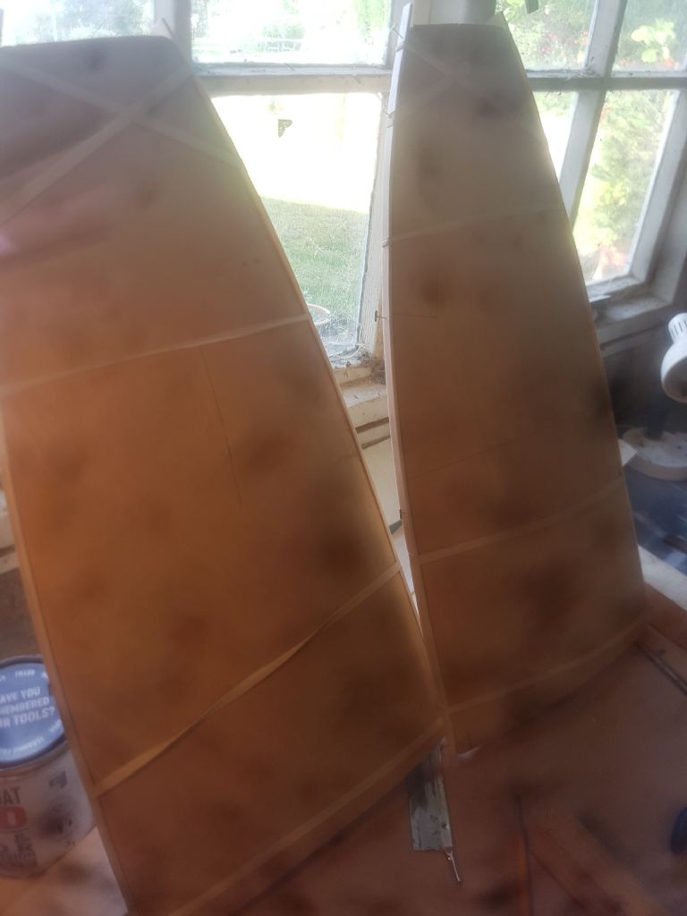

A bit more progress. The airframe is pretty much done. Sheeted under the chin and lined up the cowl today. Just completed the wing fillets which will just need a few strokes of the sanding block tomorrow. Motor is mounted to the motor/ battery box and just needs lining up to the cowl and gluing into place.
I covered the wing today using Richard's magic brown paper idea. So, how have I got this far without discovering this before? I pasted the paper with slightly thinned PVA, left it for a few moments and then ironed it on. Piece of cake! It irons on really well and goes around curved better than shrink film. Only challenge is a couple of bubbles where I need to inject a little PVA and tack it down. It looks great though and masks a lot of finish challenges that I would otherwise spend ages filling.
Fuselage and control surfaces to cover tomorrow, then a coat of non-shrinking dope, and then onto trying to avoid messing up the paint. Talking of which, I bought some great paint from my employer; Rapid electronics. I got Ambersil grey acrylic primer, which is a pretty good match for the underside, and Plasticote primer which is a darker grey for the top. £6 a can and next day delivery!

Got a lot done today. The wings are pretty much done. I have used lightweight glass cloth to reinforce the centre join and will put a second layer on tomorrow. The ailerons are separated and lined with 1/8" balsa. I have completed the servo boxes, so once the second cloth layer is done, they are ready for covering.
fuselage is nearly done. I have carved and shaped the foam decks. The rear deck will not be sheeted, but covered directly with brown paper. I have sheeted the front deck. This is not yet fitted as I have still to cut it in half for a battery hatch. I'm not going to do this until I have glassed the inside of the cowl (awaiting some resin). This will allow me to adjust the height to get an exact fit to the cowling. Richard's idea to make a 'sliding battery box/ motor mount' is brilliant. I will be able to get an exact fit of the spinner backplate to the cowl once this is fitted.

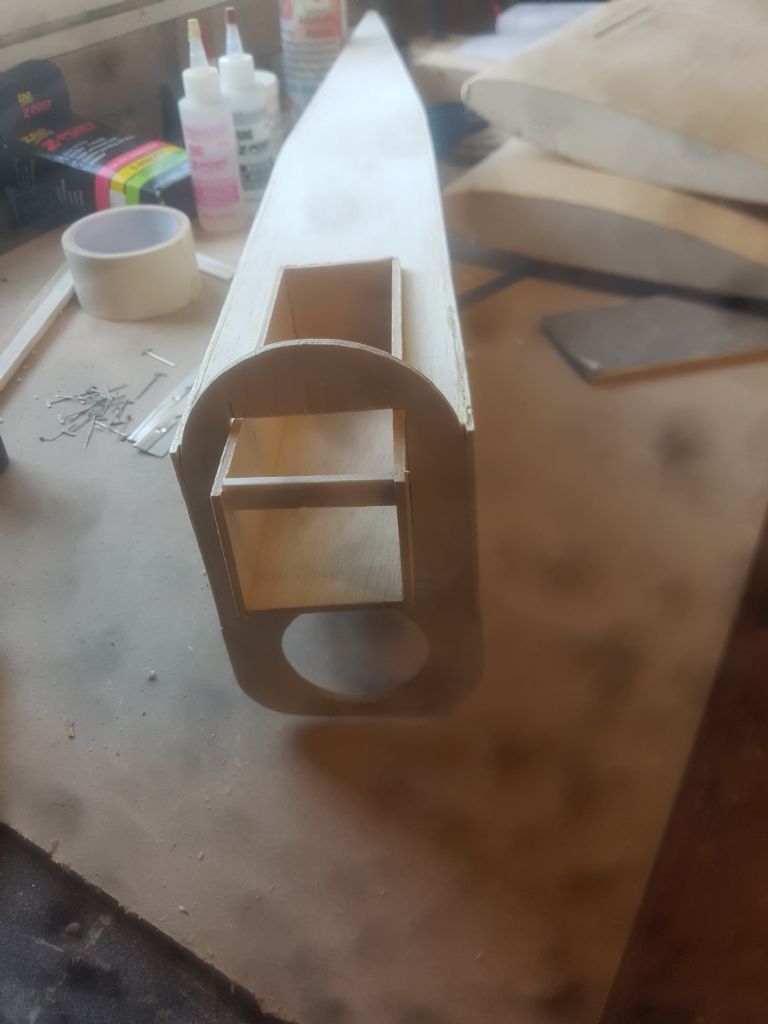

Gentle progress today.
(forgive the terrible pictures, my phone camera is broken!)
Fitted up the fuselage formers and fitted laminated leading and trailing edge to the foam wing panels.
Nice simple stuff. Tomorrow I will work on the wings:
- Fit the wing tips
- shape the leading edge
- Cut the wing panels and rejoin all the panels to get the polyhedral
- Set the undercarriage blocks
- Prefit the servo and retract extensions (I'm preparing for the eventual fitment of retracts, once I've got used to the fixed undercarriage)
Graham
