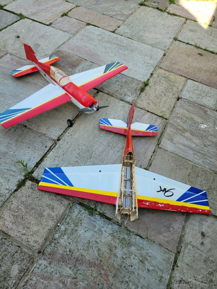

  8. Latest B&Q foam creation:
    A 1:1 scale model of the mini Yak that I managed to tent-peg a week or so back. I bought the little Yak from a clubmate, and it's been a go-to for about a year. It encouraged me to try new things, and you know what sometimes happens when you try new things...
    These lightweight ARTFs are not built to crash. The poor broken body is respectfully included in the pictures. A moment's silence, if you please...
    So, I made another one! Mostly from the 6mm black laminate floor underlay. I wasn't going to cover it, but the hinging was rather ugly, so I covered it in brown paper/ PVA. Painted with emulsion and a lick of water based varnish. 40" span, 2lbs 4Ozs with a 2200 3S pack...
    Graham
    • Like 10

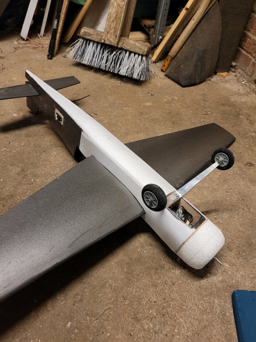

  9. So, to contribute...
    This is a 'one week from cause to effect' project
    I dumb-thumbed the little Yak I bought from a clubmate. It flew brilliantly and encouraged me to practice the things I'm not so good at, and it ended badly when I lost which way up it was. It ended up tent-pegged, and these lightweight ARTFs are certainly not built to repair. So, BUILD A NEW ONE!
    Crash was wednesday. Thursday was spent in a moving, private mourning ceremony. It was emotional..
    Started on Friday, 1 1/2 hours. 1 hour on saturday and then a good day at it one Sunday. One hour this evening and this is where we're at. Not much more to do; maybe an hour before painting and finishing.
    It's made from the black 6mm laminate flooring underlay from B&Q, with a bit of 3mm white (Diall) stuff for the curved parts of the fuselage. A few bits of lightply, 1/32" ply and a couply of carbon strips from a recently retired foam 3D indoor thingy, and coffee stirrers to stiffen the ailerons etc. Cowl is a lump of polystyrene, glued to a lightply disc, and spun until it was roughly the right shape. The top hatch is a lump of polystyrene onto a lightply base sanded to shape. I've been able to salvage a little bit of the canopy, so it's not far off.
    I'm not going to cover it. I'll mist coat it in white emulsion, and then spray an emulsion colour scheme before a thin coat or two of water based varnish to give it some gloss.
    Not weighed it yet, but the original is very light, and this is lighter!
    The elevators, rudder and ailerons are not fitted in the pics as the stiffeners are still drying. The poor broken body of the original is there out of respect...
    Graham
