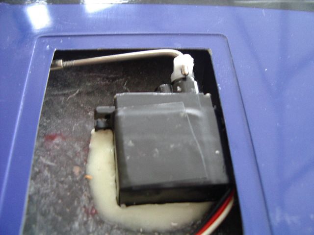

Servo positioning is not that critical.
The further inboard the less inertia and therefore faster roll rate, yet the closer to the centre of the aileron length, the better control.
I opted for the pushrods at the centre of the ailerons.
Install the servos in the thickest part of the wing and build a box with ply (3/32" or so).
Wrap the servos in insulating tape, sand down lightly and wipe with white spirit, meths or isopropyl alcohol. Glue in place using epoxy thickened with microbaloons.
If the servo needs to be replaced simply cut the tape, take out the servo and peel the tape from the epoxy. You are left with a lovely servo shaped hole.
