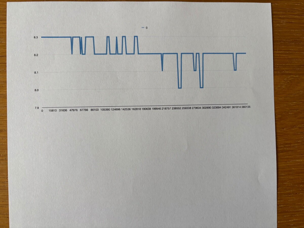

Well renewing the RX packs certainly put my mind at rest because I compared the Telemetry chart using old and new packs with flying the same aircraft and a similar freestyle aerobatic pattern.
The old RX pack showed noticeable dips at times of high servo deflection.
The new pack showed a clear improvement with very little voltage deviation during high servo defection. One thing which may have made a difference is the higher discharge rate of the Optifuel lipos compared to the Turnigy packs. Don't know for sure.

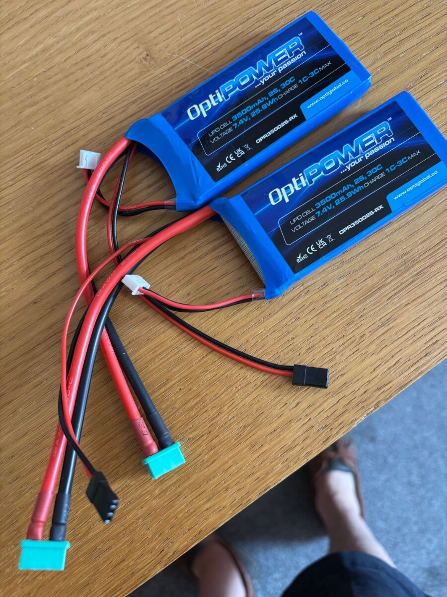

As a matter of caution I have replaced all my Turnigy RX 2S 3600 mAh packs as they are quite old and look suspiciously as they are about to down the puffy route. Furthermore, I wasn't happy with some of the telemetry data relating to the RX packs given I am using all digital servos.
I chose some Optipower packs and truth to tell there wasn't a lot of choice of packs with that capacity.
The only issue I have now is that I need to buy an MPX (male) charging lead ........

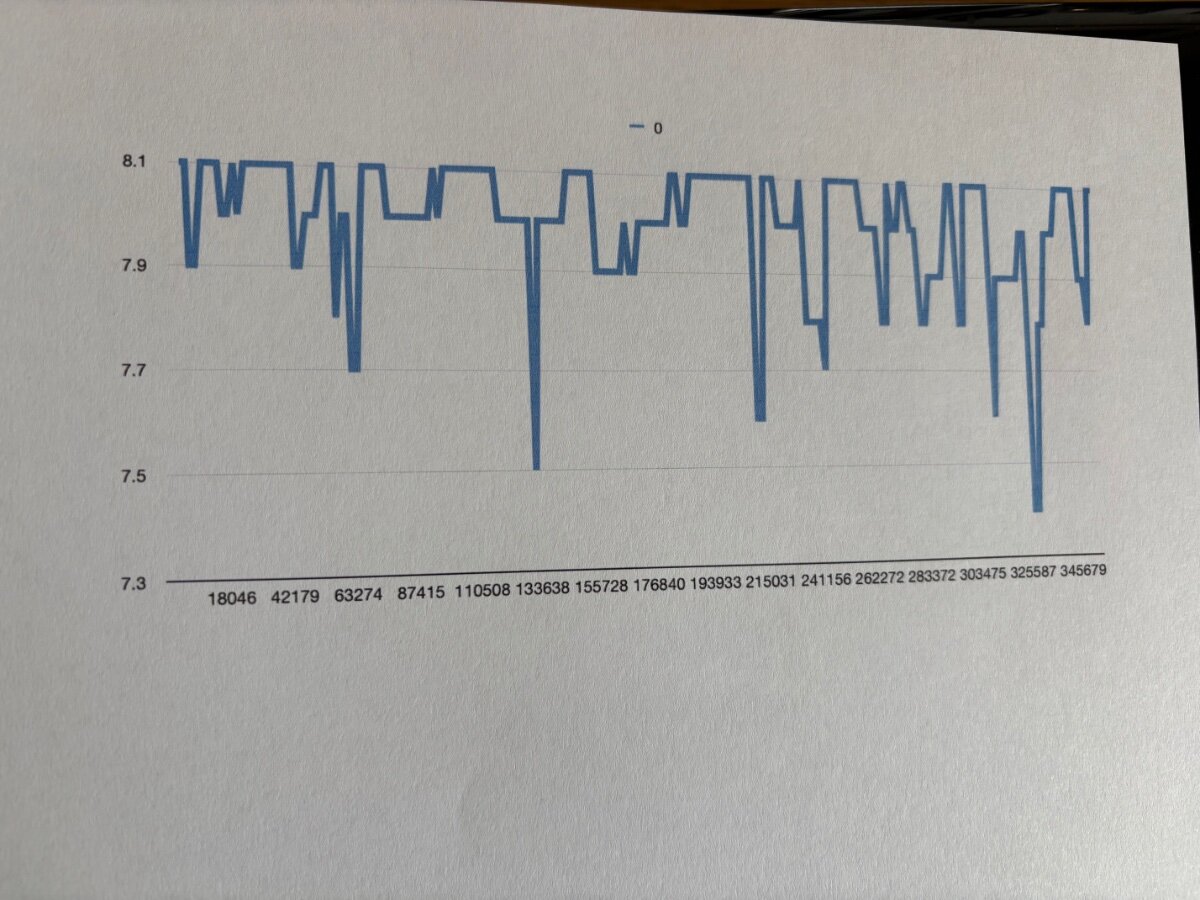

As I say the Rx battery is just just supplying the servos via the switch due to the OPTO nature of the ESC. I am a bit surprised to see this happening only when the ailerons on this particular aerobat are at full deflection. My other 2 large scale a/c using the exact set up (same RX battery too) and don't show anything like the brief large current draw on the RX battery (2s lipo) doing the same flying patterns. But I take you point about access and it may be be nothing worry about. I am going to go through the aileron geometry anyway this week because I am not happy with it and retest.
As you say GG, until started playing around with telemetry I was happily ignorant. Now I am more inquisitive and want understand more. It just makes life more interesting for me.
Hi DickW, the wiring from the lipo is what it is. It connects to a switch from 4-Max which is sturdy enough I think and is the same for all my large scale planes. As it's an OPTO setup it only provides power to servos.
https://www.4-max.co.uk/gt-electrical-switch-8a.htm
I tend to think the evidence from the Telemetry/TX setup points to a servo on or near the stalling point , but I will test it all when I go to workshop this week.
Thanks for the input, gents.
Well looking at the two aileron EPAs the RH aileron servo limit up & down is at 135 with actual travel of 115 and 140(!) respectively. The left aileron has a limit of 135 up/down with the travel set at 120 for both. Going to the sub-trim menu the RH aileron is +70 while the LH aileron is at -12. Something definitely not right there. Both servo arms need coming off with servos zeroed and start again. The throws when she was initially set up were supposedly equal, also I can't say I noticed anything untoward in flight either. I think anyway the roll speed can be toned down a bit to make it more scale like because as it is now this is not right.
I have had a look at the servo measurements, GG. The readings indicate a high level of rotation on the two aileron servos (probably non-scale rolling at the time), but with the throttle approaching WOT. The ESC is an OPTO and of course, as normal, there is no throttle servo. So you may have a point GG 👍 Looking at the charting on my two other large scale jobbies and doing the same routines, the most voltage drop is briefly down to 7.9v during the flights. So you are probably correct and I need to look at the EPAs carefully. I am the first to admit my EPAs are quite large (I don't do low rates or EXPO by and large!). Good time to check during the rainy week.

Trawling through the data on one of my large scale aerobats (Goldwing 91") I was looking at the RX battery and I was horrified at the gyrations during one flight! I am using a 3600 mAh 2S RX battery (12c). At the start of the flight telemetry indicated it was 8.2v (although my lipo tester said nearer 8.4v) which is starting point I expected. However, during the flight it hit 7.5v and then 7.4v! On my other aircraft there is some dips in capacity before recovering, but not this much. Scary. I wonder if the battery is nearing its useful life, although the discharge rate on both cells at the end of the flight are the same. It's got me thinking though ......
