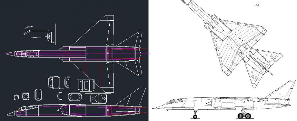

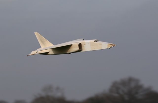

Here's the final offering and yet another indulgence for me....the TSR2 on a single 50mm EDF...wings are a little stretched buy hey, let see what happens

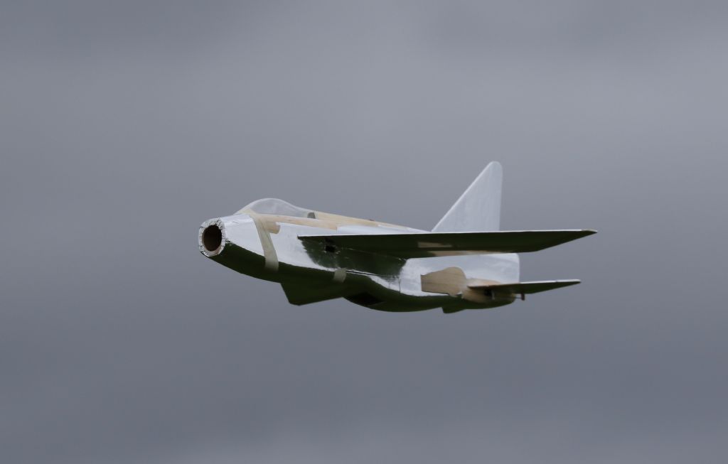

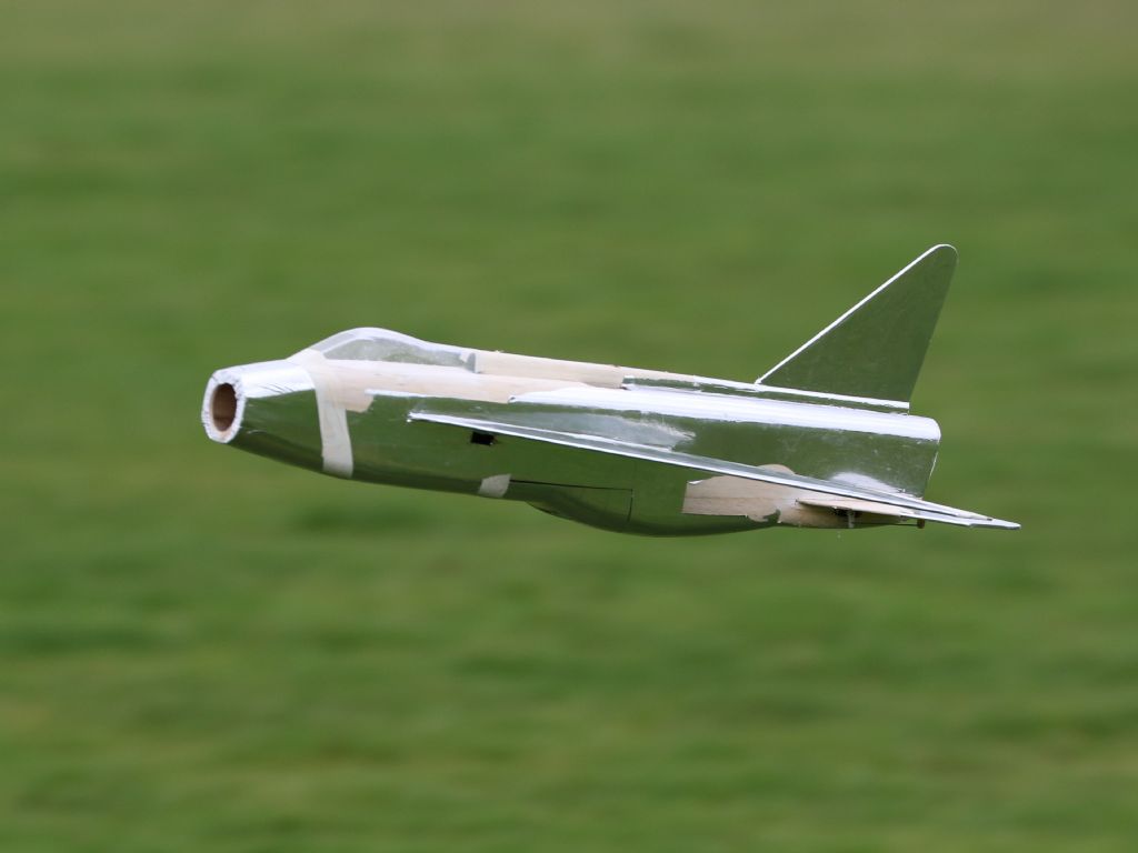

New EDF Mini Jets- Hawk & Lightning
in Tony Nijhuis plan builders
Well it took 6 months to rebuild (not because i'm slow
) but retested the EE Lightning yesterday having removed the complicated Aileron control and reverting to tailerons......a much easier servo installation and simple to set up......the results were it still had great althourity but the full roll was much slower.....mind you that's no bad thing as the aileron version was a little too rapid on the roll.....
