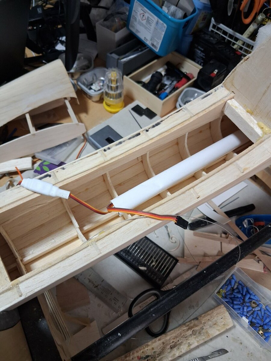

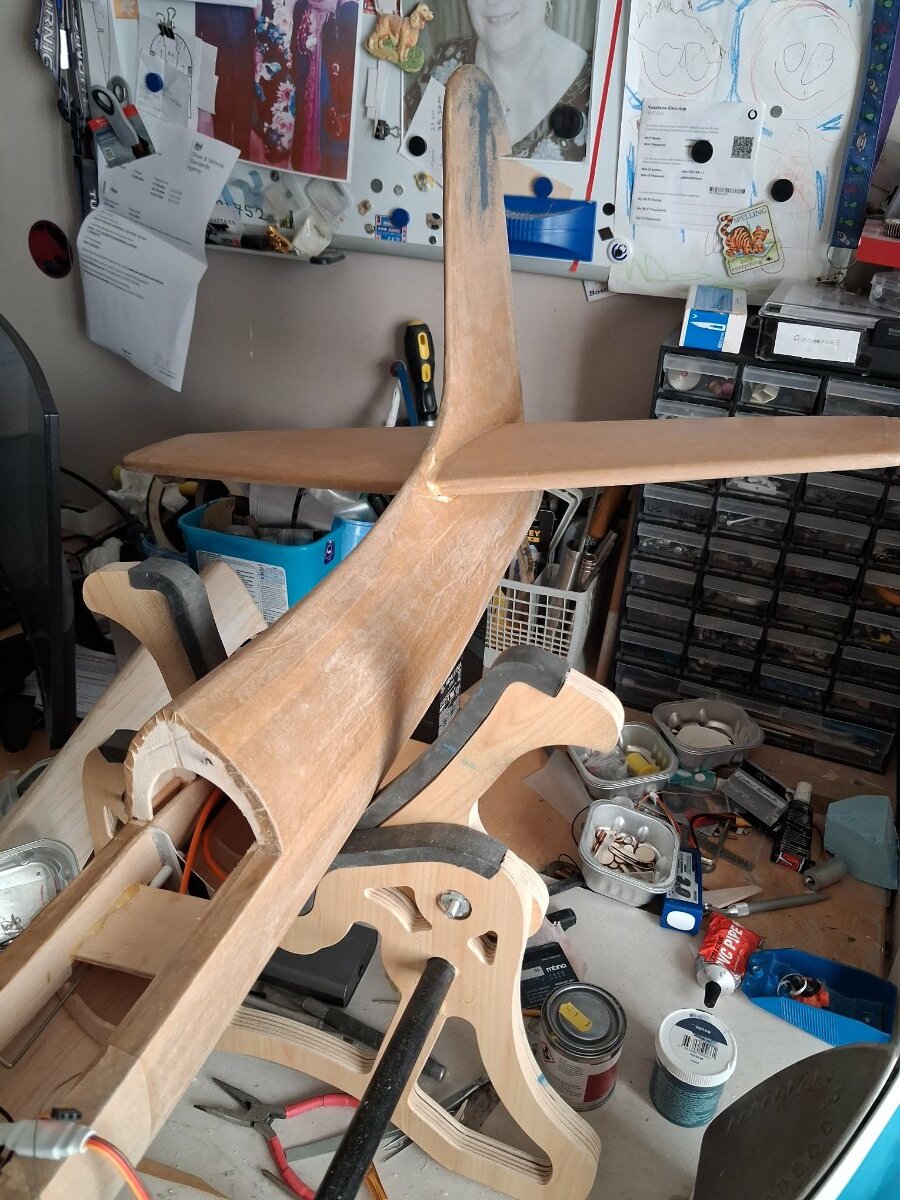

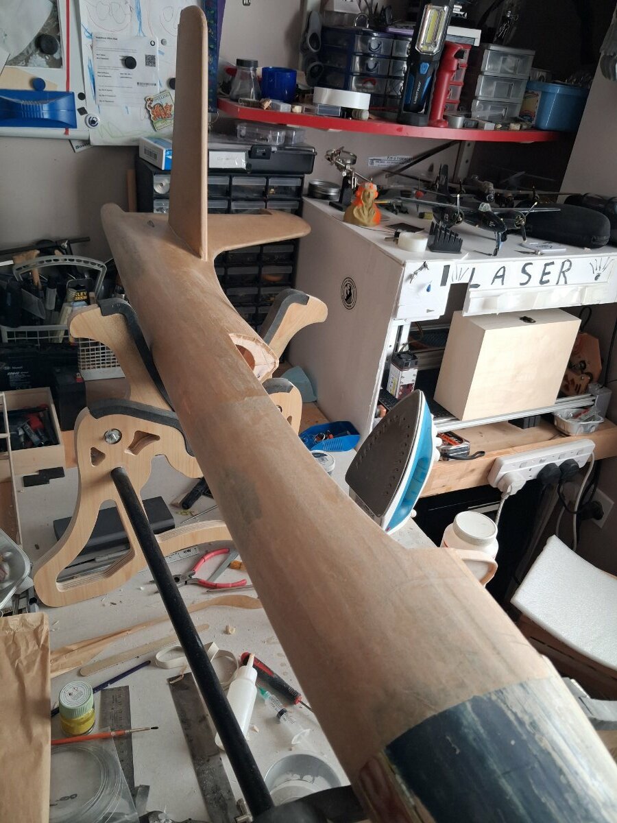

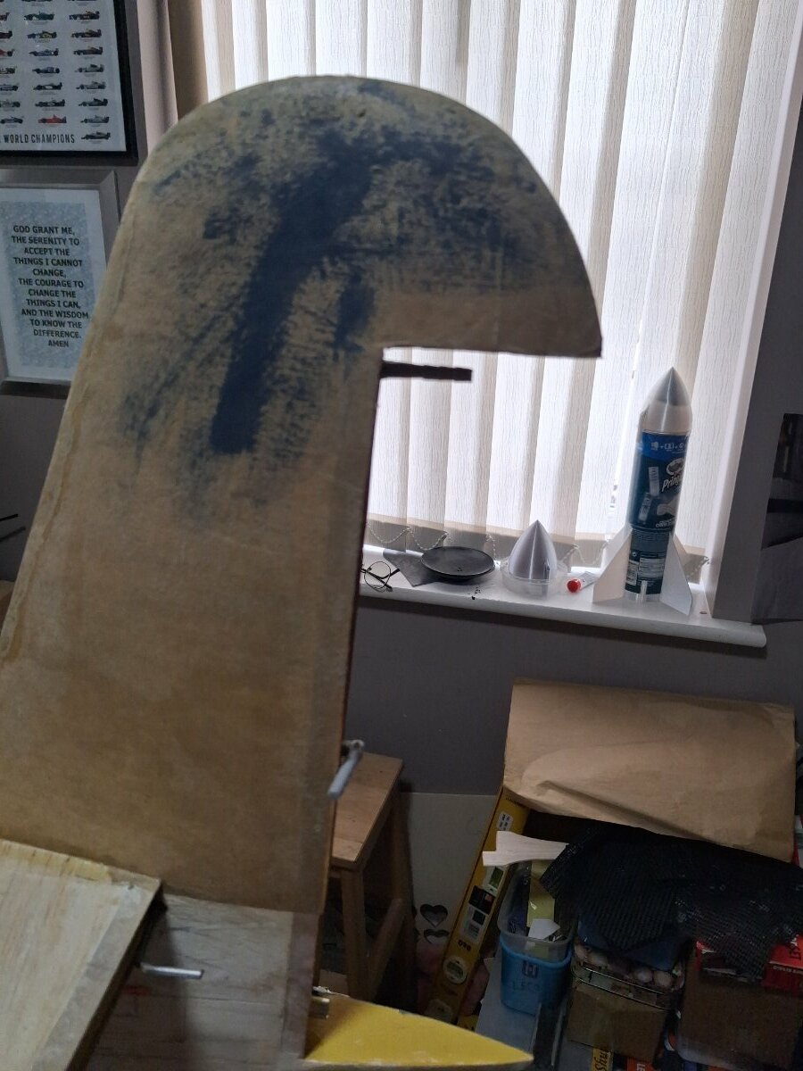

    More or less up to date , been reviving the art of paper mache and glue covered fingers and hands and probably other place, the fuselage is no all covered in brown paper and had a light sand down ready for primer. just finished covering elevators (rudder already done) hopefully fit tonight. there is precious little space in the fus but have managed to squeeze in servo mount and servos, carbon rod for elevator and push pull for rudder. Currently printing pilot ,instrument panel ready for fitting ,pilot seat to make along with armour plate behind pilot. waiting for cockpit green to arrive then I can fit out cockpit. Lots to do still but am picking up pace.

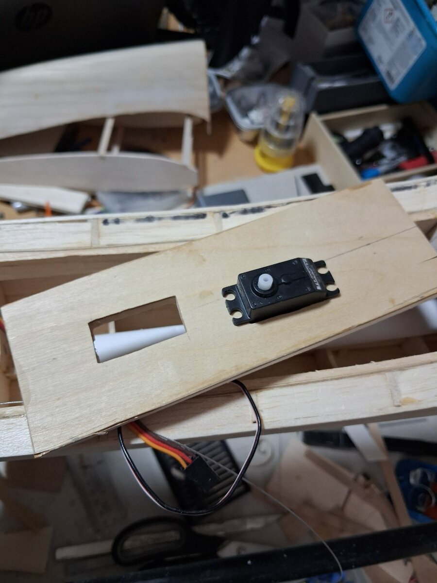

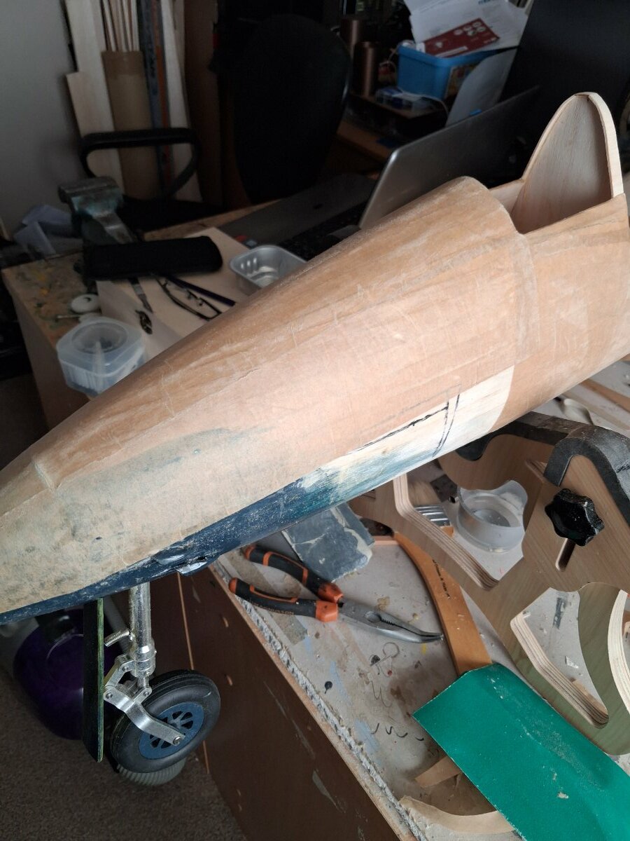

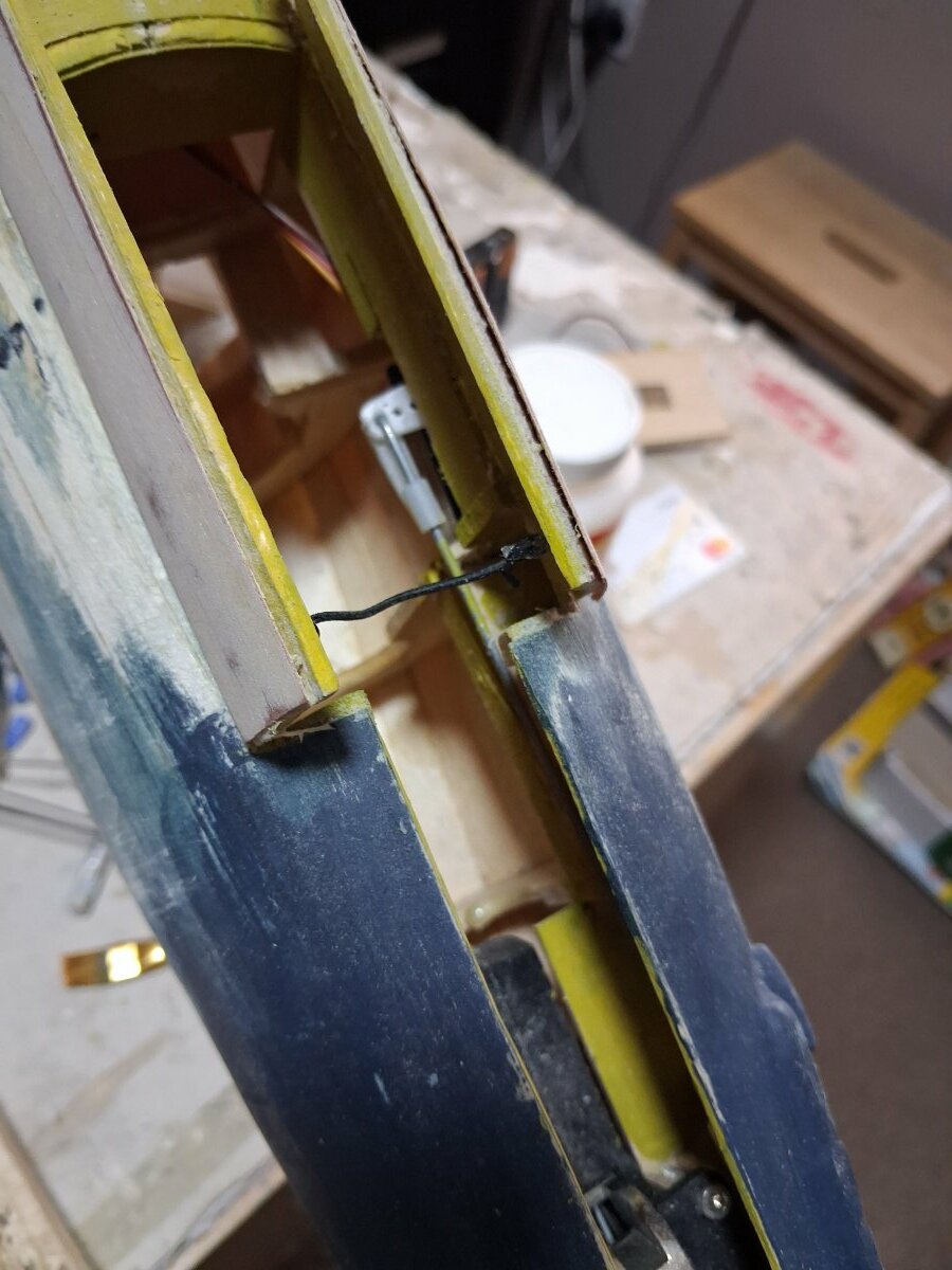

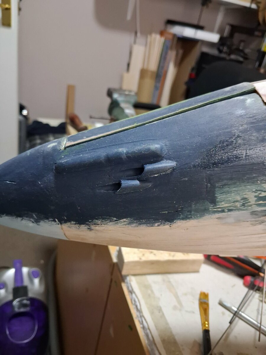

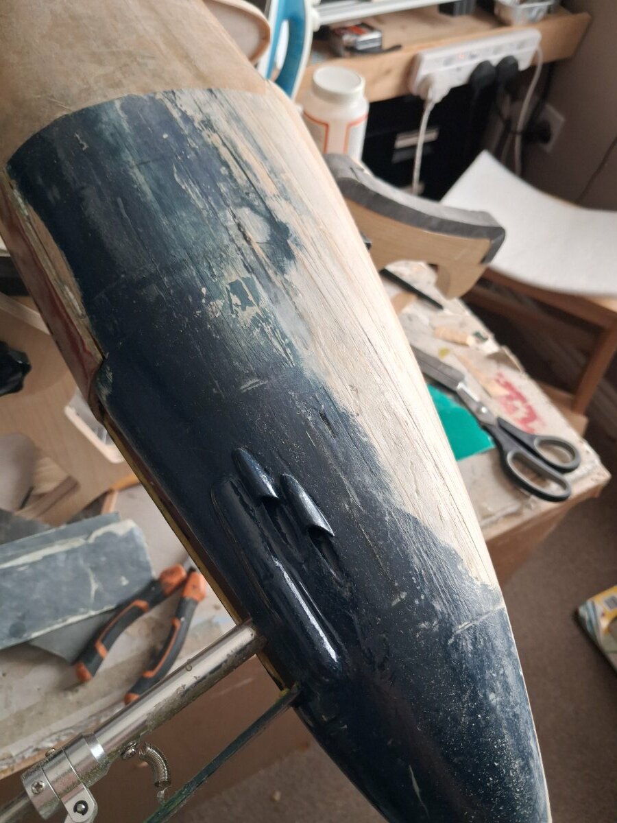

  3. Series of pics from my phone. Fin half covered in brown paper (pleased with that. Servo tray ready for servos I had to cut this out of fuselage no idea why I placed it where I did it may will be shortened, am going to place 2 battens to support tray lower down to clear wing. Still to work out wing retaining . Nose finished apart from fine tuning gear works ok still need to fit light spring to hold doors open when gear down. nose leg steering servo can be seen. Gun ports fitted inner ports made with paper straws.

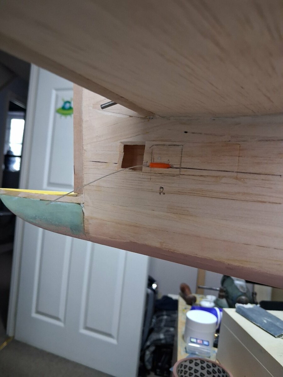

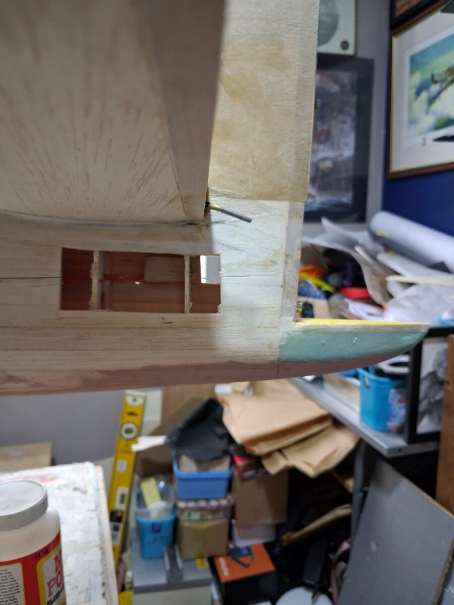

  4. Hello I have been busy this year honest but not always on the Tigercat. I got sick and tired of the 2 wing halves so joined them together only to find I had screwed up on the one nacelle (it was to long by 30mm) what to do start again or ponder for a week ,pondering worked it required delicate surgery (no record of this) making a template to match the correct one turn it over and mark out the shape then very carefully slice into to top sheeting and into the formers removing what was needed and then bringing the two sides together to match other nacelle it took a while but I got there. This will not be the end of mistakes, more later. Anyway, wing has been moved to hanger 2 out of my sight and the fuselage moved in ,its not easy working on it with limited space. The plan called for bespoke noseleg gear but as this is a reduced scale that wouldnt be possible I sourced a noseleg for a flight line Tigercat as I have done for other bits as its the same scale. After careful measuring, I committed to to cutting open the lower nose section down to a hardwood string gradually removing bits until I could fit in nose leg , A ply plate was made to support the retract and nose leg. The nose leg on the Tigercat is canted forward I packed out the retract until I achieved the desired angle that still allowed the nose leg to retract in just below the fuselage skin. Anyway some pics to show the result.
