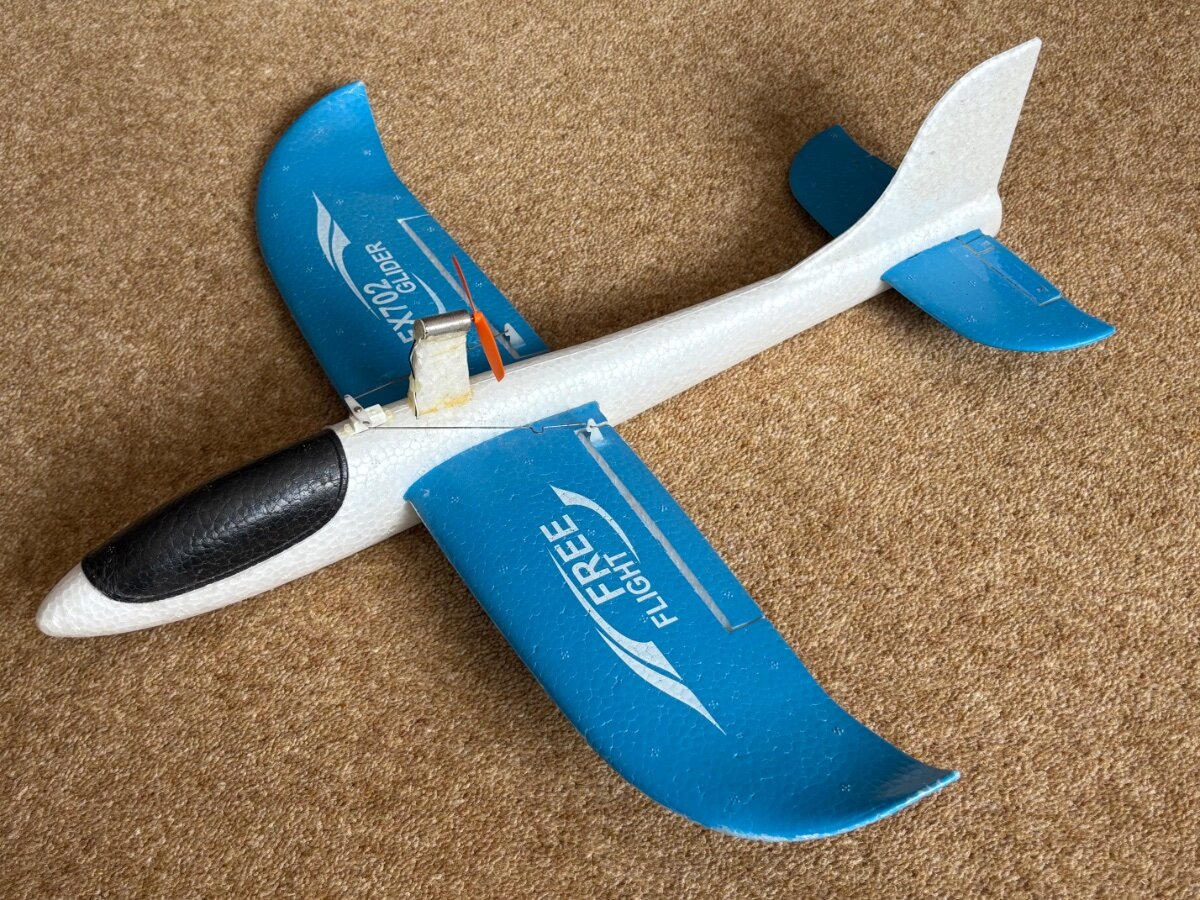

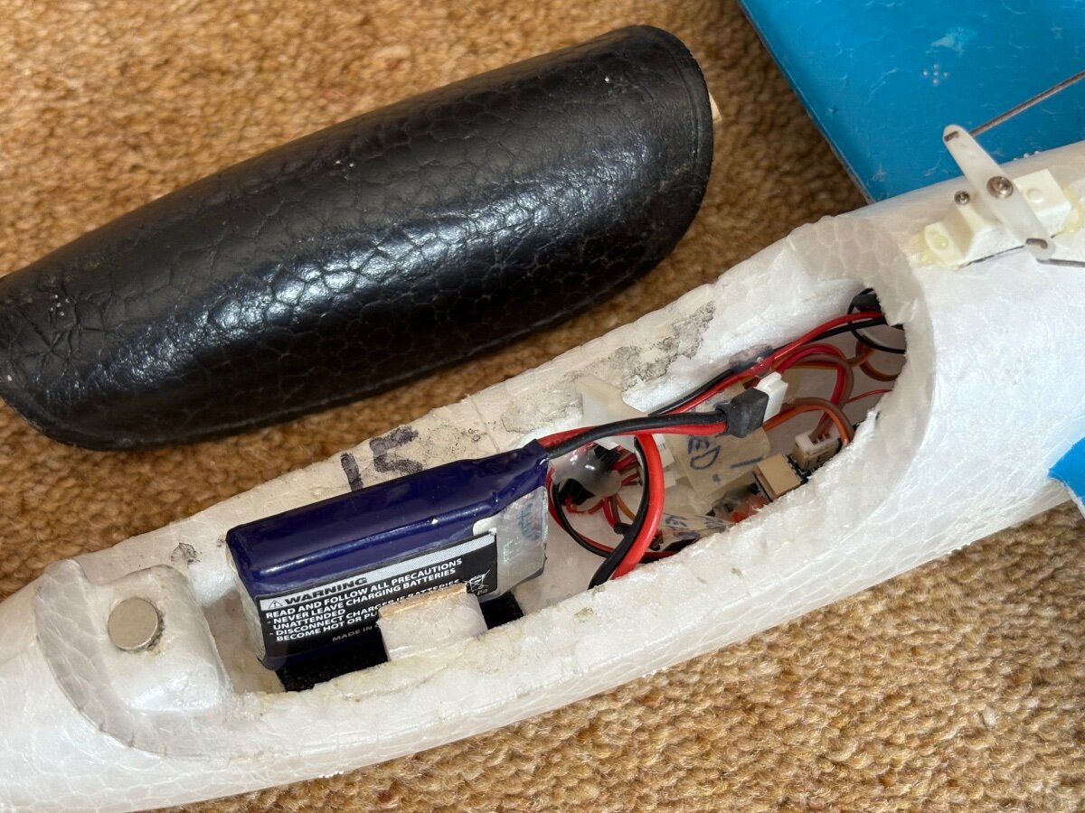

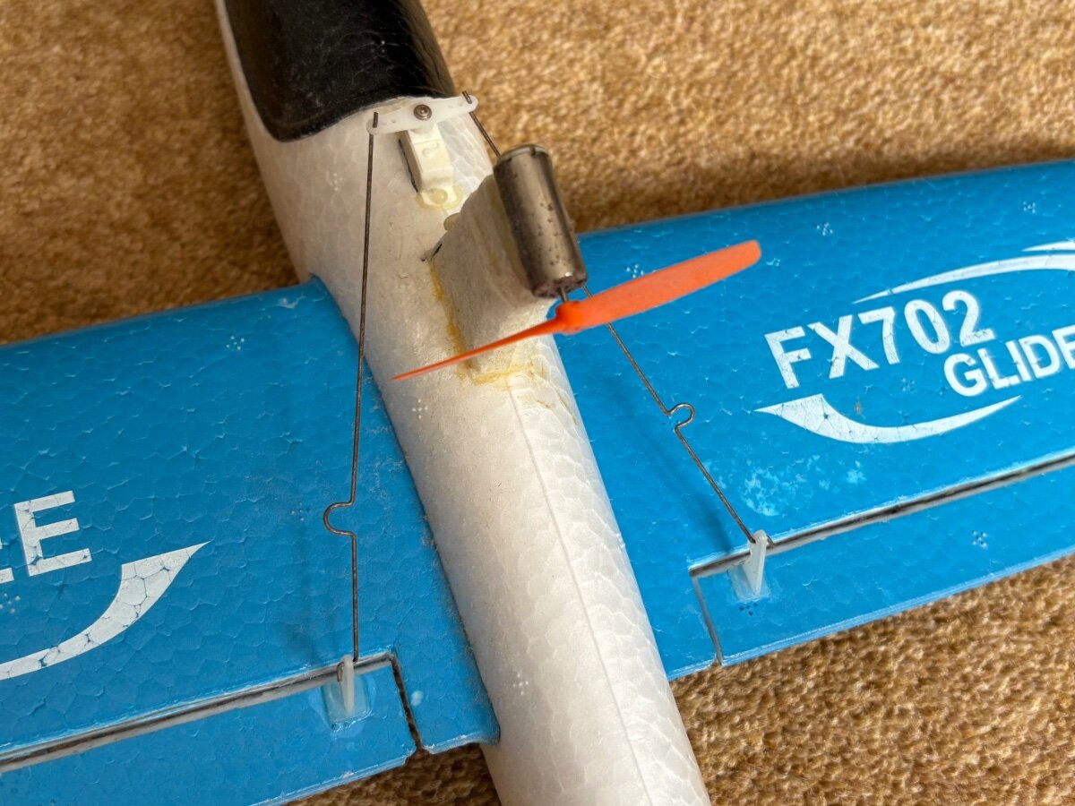

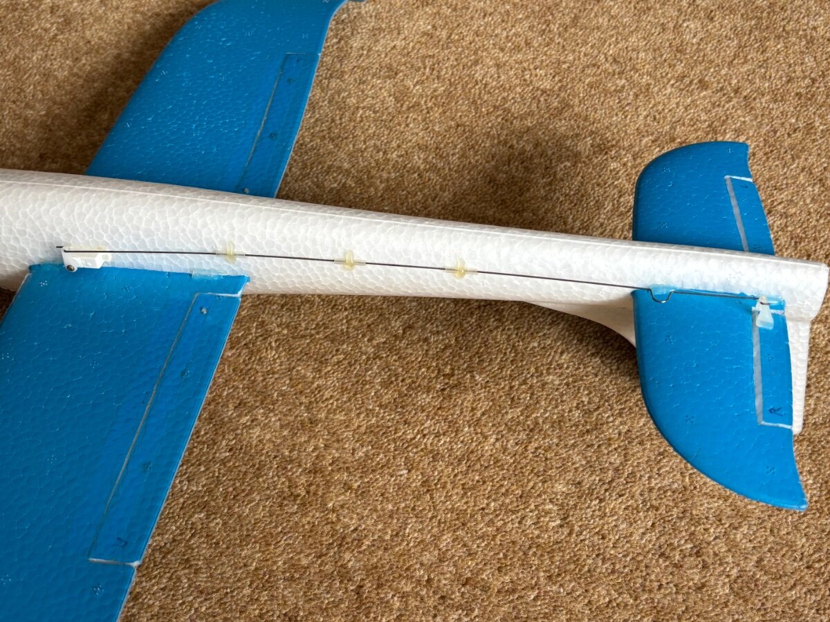

19 hours ago, EvilC57 said:
I built one of these small cheap foamies several years ago now. I’d seen the small FX702 chuck gliders in Lidl among other places, and looking closely at one, came to the conclusion that it ought to be possible to remove the separately moulded canopy and scoop out whatever foam was underneath to create a cavity for the radio gear, battery etc.. And then cut the fixed control surfaces loose to liberate them from the wing and tail mouldings.
A micro receiver/brushed ESC, two micro servos and a small coreless drone motor later, this was the result (see pics). It flies well for about two and a half minutes on a 500mAh 1S lipo.
The challenge was getting the thrust line of the motor correct for neutral handling, but on a calm day now it flies very well outdoors. I tried it a few times at my club’s indoor sessions, but it was a bit too fast and got banned!
Interesting, I've been messing about with a mini Lidl and a rechargeable motor from a foamie biplane free flight cheapie. But only as free flight. As you say, thrust angle is the hard part to get right. I discovered that when I built a pusher version of the standard size Lidl glider. The advice online didn't work and thrust line had to be much higher than suggested. Yours is higher still!

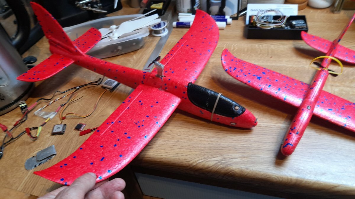

Re the small gliders, I guess you haven't seen my 4 motor version that I have finally sorted? 100g AUW, 200mA 2s and loads of flight time. 3A BEC, 2 brushed ESC's
After failing twice, I finally found a way to get my 4 motor Mini Lidl cheap foamie RC conversion flying properly. One idea was probably a bit obvious, but I hadn't heard of anyone trying the second idea I came up with, but it worked!

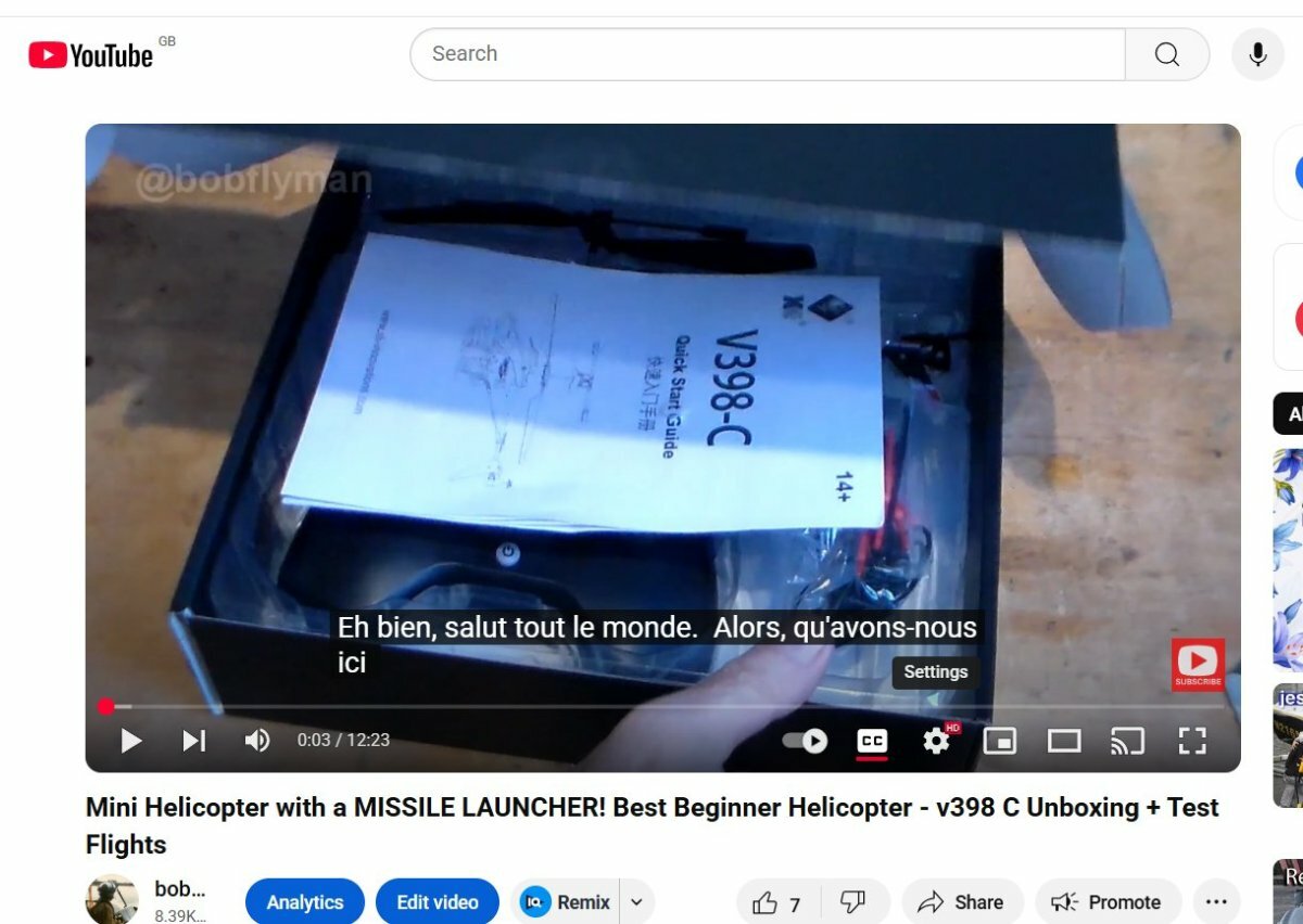

Someone has asked me where you can buy this. Banggood is one source I've seen, about £30 with delivery https://www.banggood.com/custlink/m3G94fRZlS?title=WL V398 chopper
2 hours ago, Ron Gray said:
I'm sorry but aren't all posts on this forum supposed to be in English?
My original post is in English, I was just being courteous replying in French?

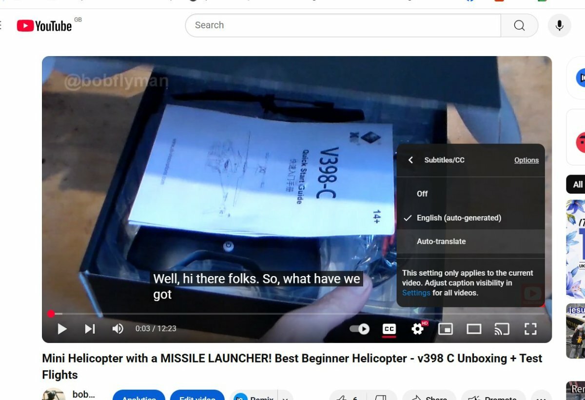

3 hours ago, Paul De Tourtoulon said:
Pub en Anglaise comme la vidéo, mais comment comprend la Française, mon Dieu, sacré bleu, elle vol
Mon français est plutôt bon mais je ne peux pas refaire toute la vidéo en français 😞 MAIS si vous allez dans les paramètres, il y a une traduction automatique pour les sous-titres ? Bonsoir.
Something a bit different from me this time. I was sent this little twin-rotor beginner helicopter for review and it's fun. I've got a few small helis, but I've never seen one with a missile launcher on it before! It's the WL V398-C Missile Aircraft, 6 axis gyro, altitude hold, which works well and it flew nicely, quite stable. It's described as an indoor flyer but I flew it outside on a calm day and it was OK. Could be fun if you had a mate with one, you could have battles shooting missiles at each other. My test flights are at 5m16s including an outdoor test and landing pad challenge! I got it from Razordon who are big helicopter sellers, but seems to be available in a few versions under different badges from £30 to £40.
