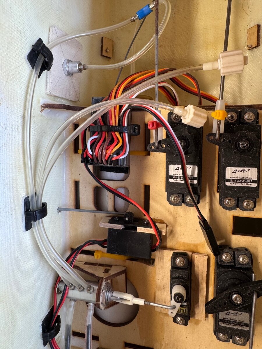

To reiterate, its not a shrader valve, its just the same outside diameter, it has no internal valve whatsoever nor thread to hold one etc. its categorically not a non return valve.
my assumption is the blue t pieces branded “spark” must be non return valves and i wondered if anyone had seen this before?
pumped it up earlier and its holding air and now no air is leaking out of the fill valve now which is odd.
anyway, restrictors have arrived and i plan to fit these ahead of the legs to slow the operation speed and stop the slamming. I will then connect it all up again, pump it up to pressure and go for another test
Its a shrader thread on outside but definitely not a non return valve, just a hole through the middle
I can only assume the blue t pieces contain a one way valve?
Check the wiring, has the connection loosened or dirty/oily
Thanks for all the good advice which is taken. Im still a bit puzzles as to where the dill non return valve is since the fill valve definitely has nothing inside, just an adaptor to allow a shrader valve to attach to the airline?
Anyway, have now ordered a non return fill valve since it cant so any harm.

Finishing an old topgun? Spitfire artf and it came with air retracts which i
dont seem to be getting on with.
Firstly one of the legs was sticking, eventually fixed. Now when i pump air in via the fill valve its slowly leaking out again via the fill valve (can hear it hissing). They slam up and down so have ordered some delay couplings from MSL’s, hopefully they will help
Question, where is the non return valve that stops the air escaping? The fill valve doesnt appear to be non return which is confusing? There is a blue three way adaptor after the fill valve that connects the reservoir to the fill valve and the switch body, im guessing it must be that? If so, surprised its leaking
Think i have the valve switch servo movement correct adjusted, goes to circlip on both ends
all advice welcomed, thks
