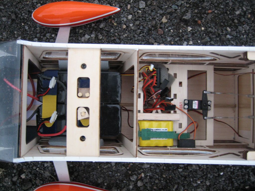

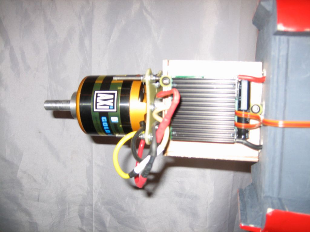

Looking into the multitude of lithium polymer batteries available and determining from the wing loading that weight wasnt important I opted for 2Nr 6S 10,000 maH lipos from Maxamps in the USA, these were competitively priced with a good reputation, they arrived faster than some UK mail order items, upon close inspection they reminded me of my oily days and the 12v battery used for the power panel, with the exception that these were 22V and 100A continuous !

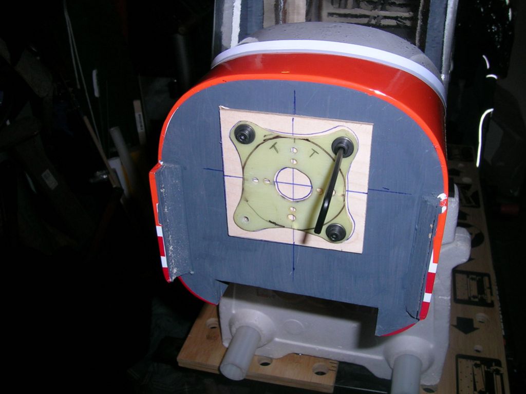

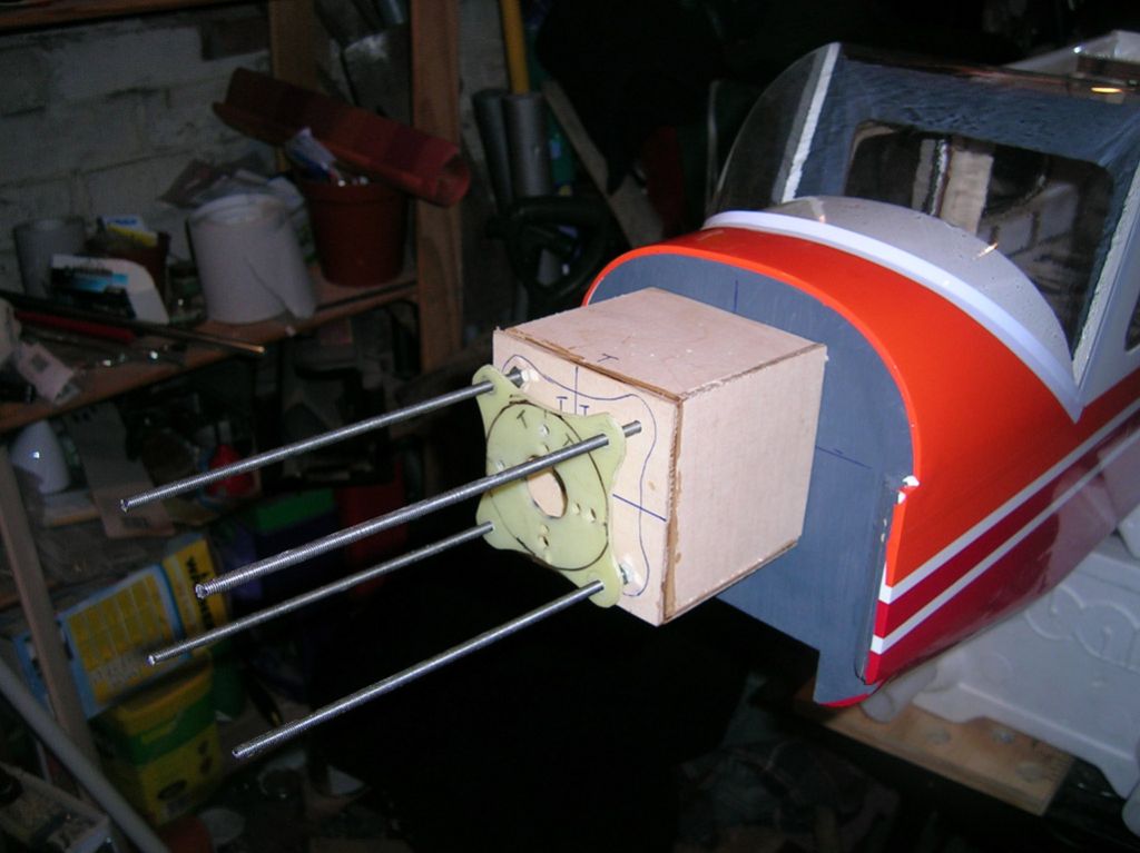

The cowl in the Taxi 2400 is massive and 70 mm of boxing was required to get the correct bit of the motor to poke out !, Ive seen many electric conversions use aluminium spacers to mount electric motors away from the bulkhead but Ive always opted for widely available plywood with 4mm threaded rod bolted through. As with all large AXI motors mo motor mount is supplied so one was knocked up using 1/16 epoxy board from Macgregor industries.Building was completed in a sedate week of evenings, all the parts were exceptionally well cut and apart from the hardware no surprises were found

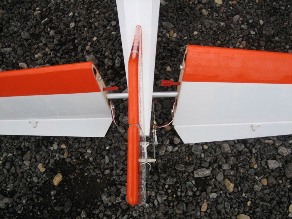

The elevators come in two sections (left and right) and each are controlled by standard servo, connection to the main body is via a aluminium tube kept in place by a robust plastic clamp.>

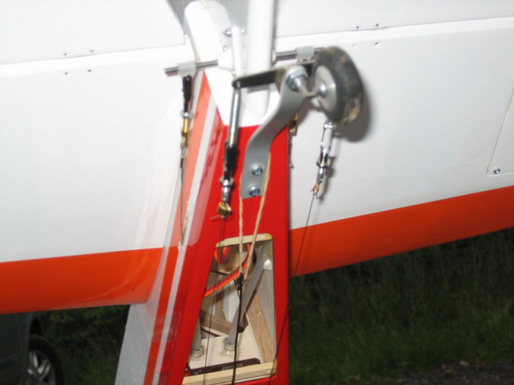

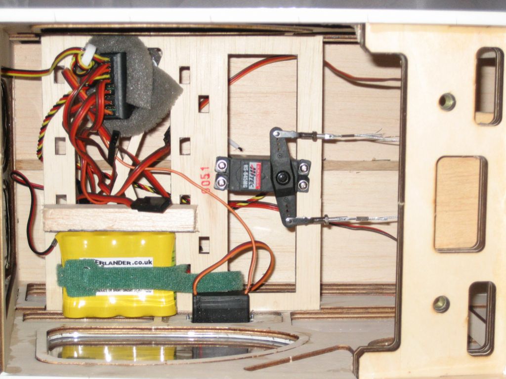

The rudder and a tail wheel are connected through separate closed loops, the tail wheel is joined to the closed loop via 2 springs to prevent stressing of the servo, as I chose this model as a glider tug I opted for a mighty Hitec 645mg as rudder is (from bitter experience) your best friend during take off.> > >

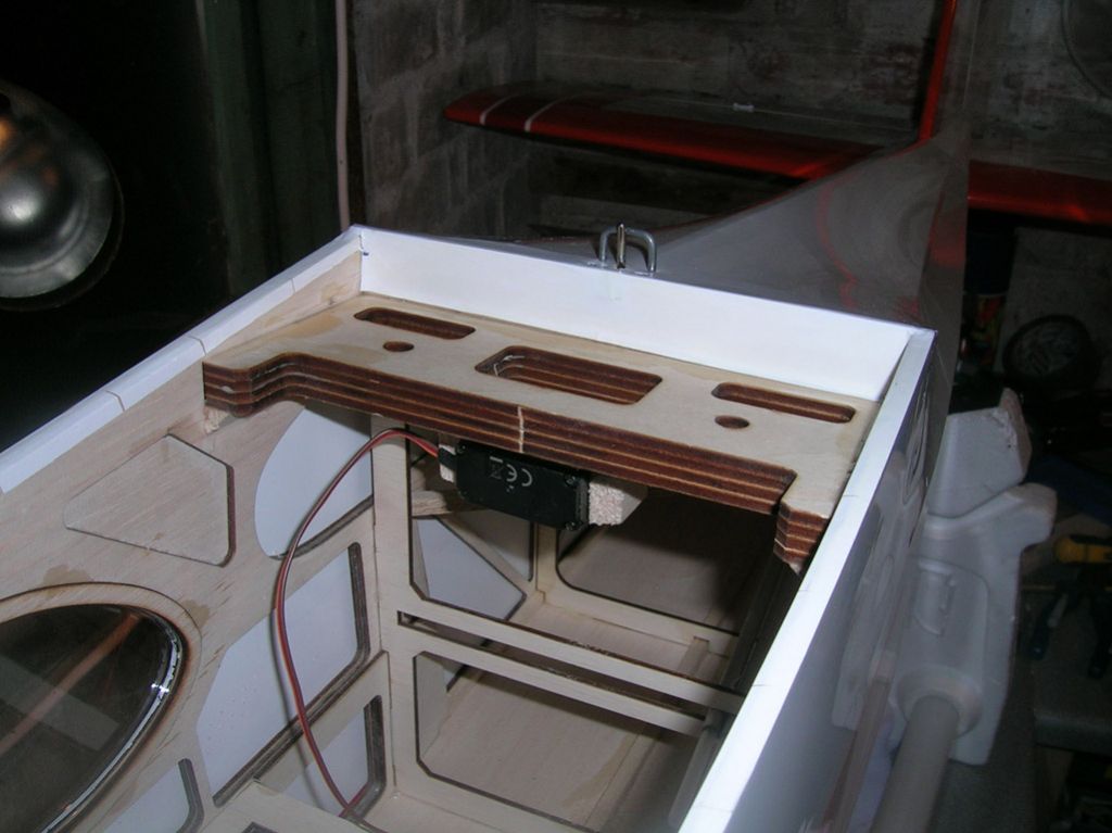

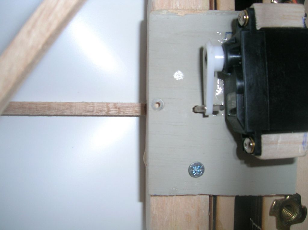

The tow release was a simple piano wire loop mounted on a spruce block behind the wing, it was a bit fiddly to install as I did not want to cut the covering, always remember to use a high torque servo for the tow release !
>The choice of motor was made on the basis that I wanted lots of power and lots of durations, in electric flight terms this isn’t always easy to achieve, I knew from the distant days of school that amps watts and volts were all related in some fashion so decided to opt for a 12S HV setup so I could reduce the amps and increase duration.Determined not to be beaten by the myriad of numbers associated with brushless motors I started ‘googling’ and stumbled across a great formula from Bob Boucher that assists with determining the correct prop size for desired power or amp draw, anyone interested can e-mail me for the spreadsheet I developed. After several days cogitating different setup I opted for an AXI 5345/16 and a Jeti spin 99 all purchased from the ever reliable John Emms at Puffin Models.

Receiver and battery installation is straighforward, there isn't a lot of room but the 2 number 2500mAh 4S packs and AR7000 receiver fitted snugly, I opted to use 4mm bullets to connect the batteries as it fits with my other models but on reflection deans would make more sense. Control surfaces movement was setup in accordance with the instruactions and the C of G moved forward 5mm for safety on the maiden. I was hesitant in using the canards (they are mixed with the elevons) but opted to utilise them for the test flight.

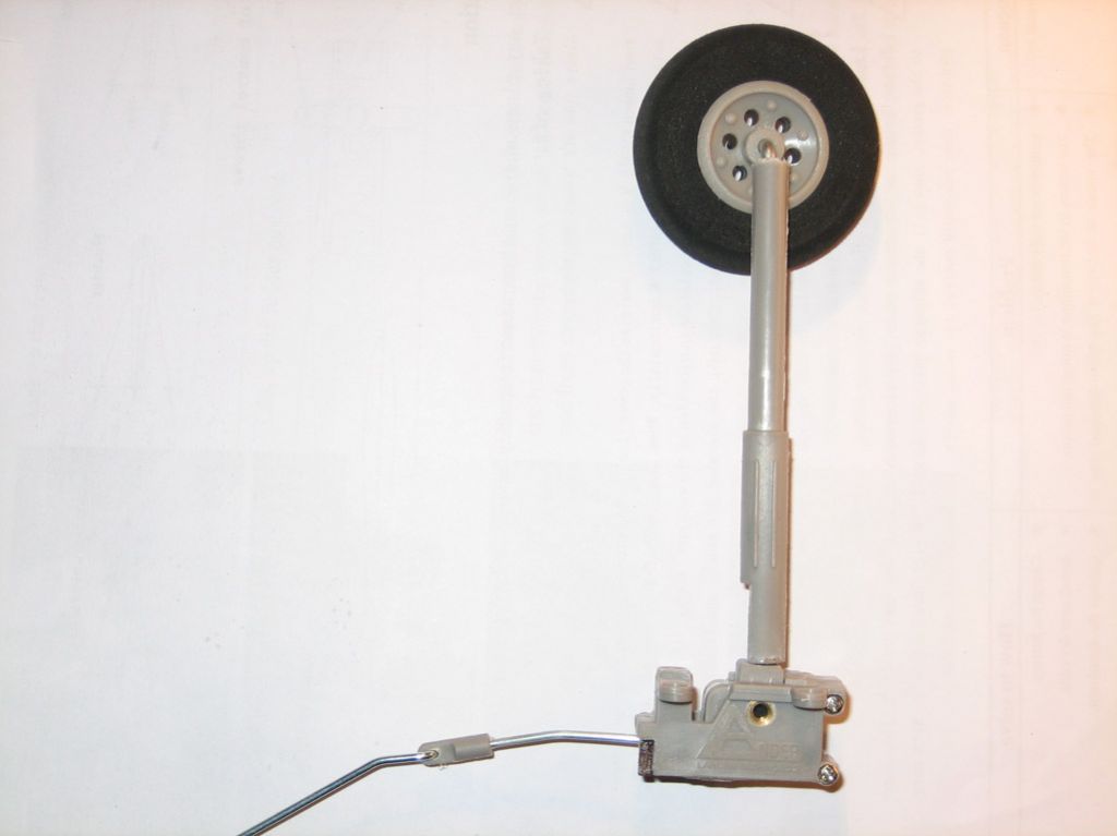

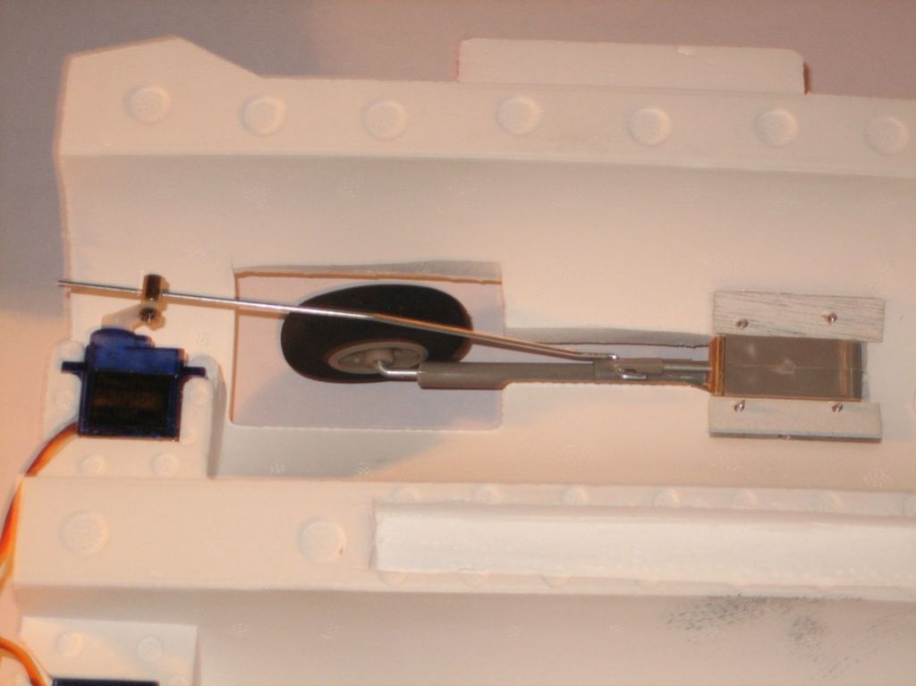

acting on it and my Panther suffered from collapse. Retro fitting the metal plate was easy, just cut out the original wood and epoxy the plate in. The instructions weren't too clear on how to install the steering servo but hopefully my pictures will help you. Although Lander's include a 9g servo for the retract mechanism I opted for a cheap 2.6kg metal gear servo to overcome any stiffness, I read on all the forums about how people have spent days 'working the linkage to operate with optimum smoothness' but I opted for brute force !
The mains were more straighforward to install and I opted to use standard 9g servos as the seemed (see below) to operate quite successufully. Remember though to bend the push rod assembly down to ensure they don't lock when moving. Also note that one of the servos needs to be reversed, this can be done by utlising on of the readily avaialble reversing y leads or as I prefer by swapping the leads to the motor and servo pot (although this method is only suited to those servos where the motor is not fixed to the board).

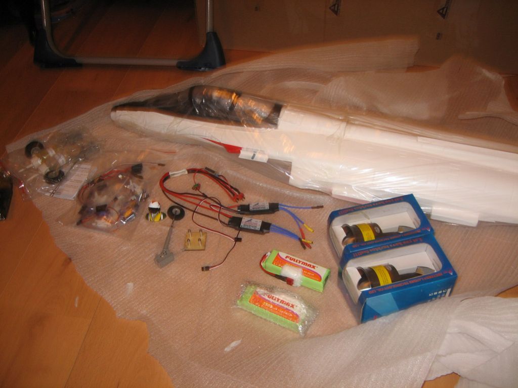

RC Lander (www.rclander.com) followed up thier immensely popular F9F Panther with a Twin EDF version of the Dassault Rafale (English: Squall). The full saize is a French twin-engined delta-wing highly agile multi-role fighter aircraft, it was produced both for land-based use with the French Air Force and for carrier-based naval operations with the French Navy. Although the full size was marketed for foreign sale no orders were ever received, luckily the model has not suffered the same fate and no wonder, its a beaut.

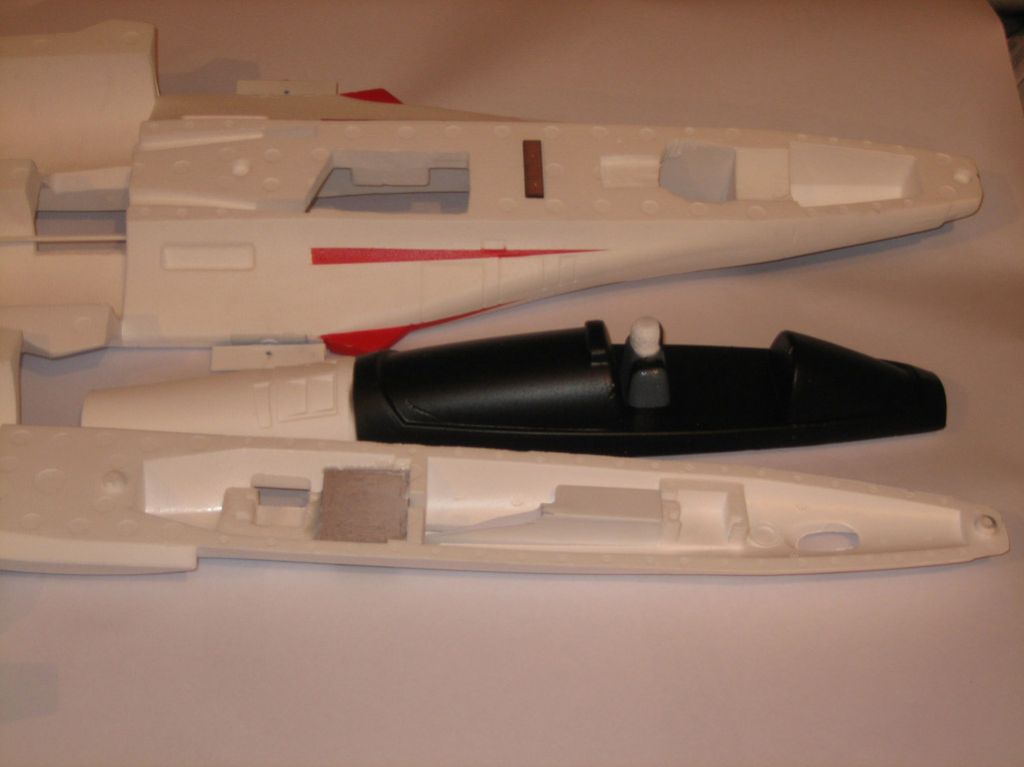

Packaging was very good, double boxed with all foam parts double wrapped. The foam is marketed as SEPO by the manufacturer, it is still EPS but very dense and gives a smooth finish. Happy to report that it is not prone to the 'hangar rash' woohoo ! The accessories are good and the metal 'lander' fan exceptional, the resonance from the metal honestly gives a turbine sound and because its balanced in the factory super smooth .....

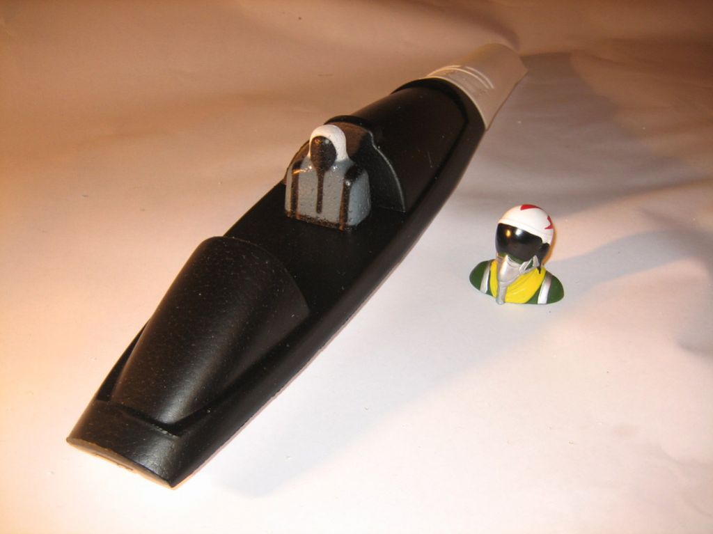

One of the first things that strikes you after checking the parts is the modularisation, the rafale is built in sections with the servos, linkages and retracts assembled on a single module prior to any joining, this allows for thorough checking and less stressful assembly.

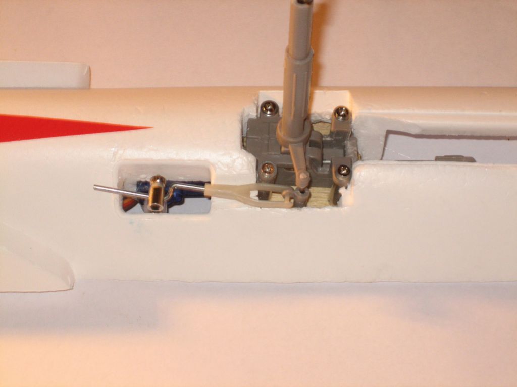

If you read my review of the Panther you may recall that I had a few problems with the front retract that ultimately led me to retro fit pneumatics, the manufacturer Tim Wan has always played a active part on the forums and has developed the retracts, my rafale utilised a metal mounting plate for the front wheel, as the front wheel is smaller and used for steering there are more forces actinTook the wife and kids to Filey (E Yorks) yesterday, we arrived early and while they were playing in the park I flew the Alula over the Brig, the wind was 2-3mph but quite warm which suited her fine, safe to say my Alula is always charged and always in the boot !I love the panther 50+ flights to date and she's still going strong.The setup in my rafale is the twin lander metal fan's 3900KV with 2 60A ESC's 2 2500 25C lipos and a hobbywing UBEC.I began the conversion of my jets to 2.4Ghz just before christmas as interference was always on the cards and this one flies great on the spektrum 7 channell thing.With some mods to the underside hand lauch would be possible as she has a 1:1 thrust ratio, the C of G is on the retracts so no issues about launching her.The retracts I am using will not stand up to grass but the new ones developed by Tim Wan at RC Lander will, I'll hopefully test them out soon.This version of the retracts isn't for grass but the manufacturer has made some metal mechanical retracts that are good for short grass, hopefully I'll try them out soon as they retro fit with no problem....I cannot stress how turbineish(?) the noise is I thought Scott was surffering from tinnitis when he first mentioned it but no it is way better, some of the die hard 'IC till I die' brigade were impressed !Still grinning several hours later .....
