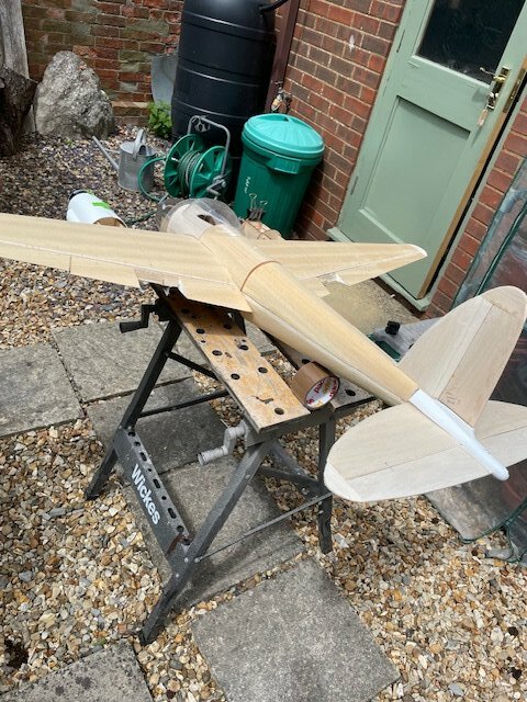

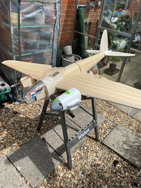

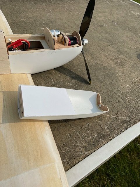

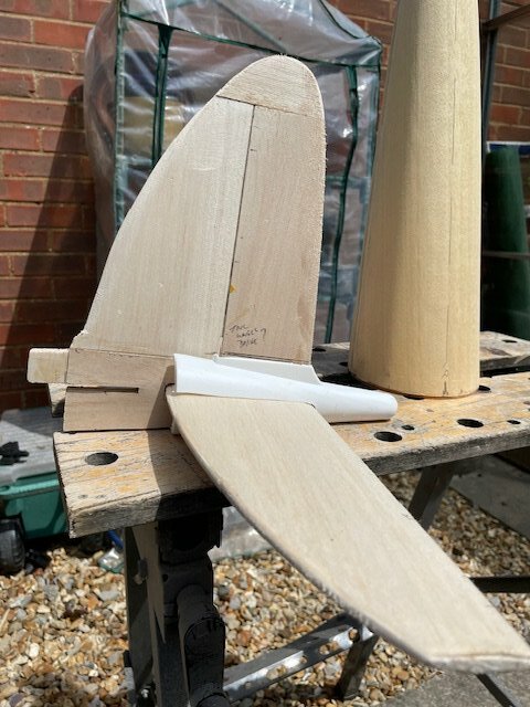

A quick update on the Mossie . Converting the half foam board model into a wooden kit had concerned me in a number of ways .
Firstly , could the weight be kept similar (particularly at the back end ) in order that a 64" model could balance with just one 3300 4s battery ?
Secondly , the joint separation behind the wing being easy be structurally sound .
Thirdly , with the upswept rear fuselage meaning that my usual central crutch would not be horizontal , how did I mount the tail assembly firmly ?
On the mock up shown below you can see that the tail has a long overlap onto the crutch and is at the same time , sandwiched by the foam decks making it nice and stable .
The fuselage joint is nice with the radio aerial being extended through the model to pin it in place .
There will be a magnet at the bottom of the aerial tube , so no screws or fasteners to lose at the field .
The best result is that even with one pack and no props it balances pretty much on the money . Also note the little tail moulding which saves both work and weight at the rear end (well done Paul ) Out of interest , we found the quickest route was for me to make a wooden one , send it to Paul who then creates the same in 3D for a male mould .
It compares well with the foam board variant in the last shot .

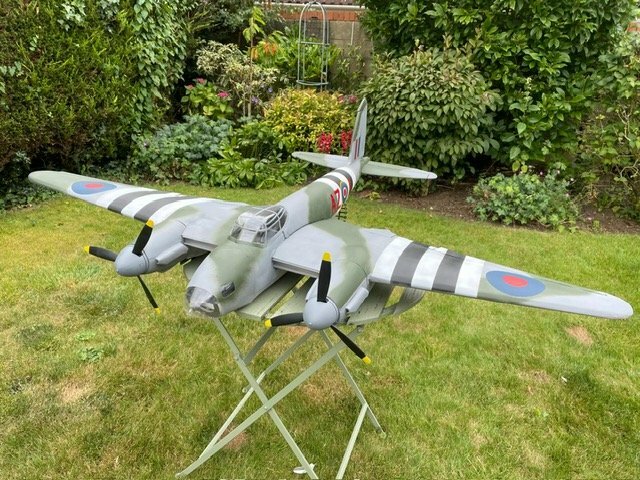

Looks great so far LM . U/c mount is your next challenge 😬
Is that a Braeburn , or Cox's Pippin ?
Ive been away Gordon , so missed the pictures. Your 190 looks fabulous (so does your grass!)
I dont worry too much about the underside of my models . Ive never had anyone pick one up off the grass and inspect it .😬
I particularly like the choice of colours on yours . Can you fill us all in so that others might copy ?

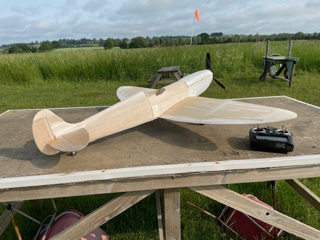

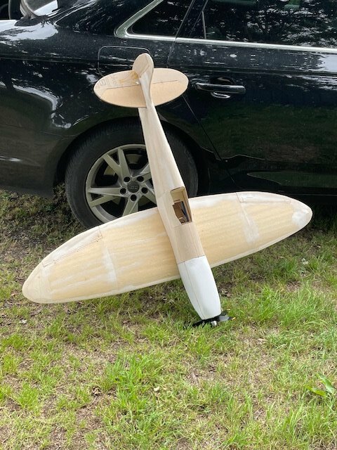

So, with all of that in mind , my intention is to create an early mark Spitfire which will be tough and light so that it can stand both belly landing and retracts . The build must be quick and straightforward for those with limited experience . (I sort of assess it by thinking , that if you have made a Chris Foss "Whatever" you can do this ) .
I have switched back to a four piece foam veneer wing . They are tough, light and accurate . They also take retracts better than a built up wing .
There will be a new top hatch for the battery . The tail has been tweaked to give a slightly leaner look at the back end . The wind shape is very accurate in plan form and also generates a lot of lift at low speeds which means it will stall very late and even when savagely provoked just does a lazy wing over .
The model below lacks any detail yet but only weighs 5lb . Hand on heart , it handles beautifully .
