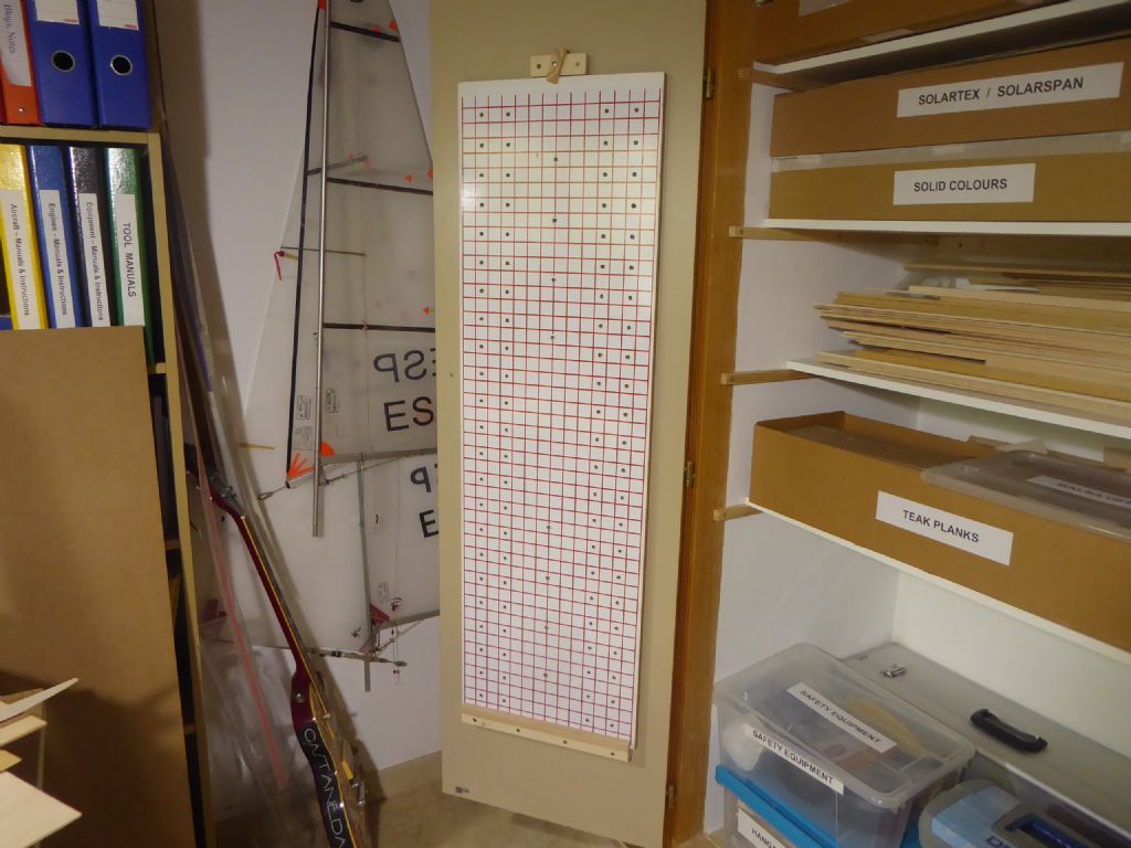

Double layer of cork tiles on 19mm multiply and five boards of varying sizes.
My boards get plenty of abuse and plasterboard would not stand up to it.
This is my biggest board stored and clipped vertical on the back of a cupboard door to stop warping. This side is the SLEC fuselage jig and the other is cork covered.
Six years old and going strong.
