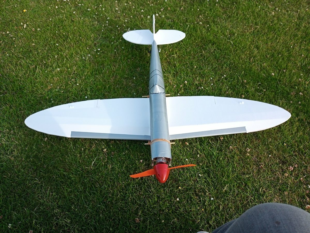

Number 10 has had three flights so far - the first was not great due to severe trim issues, which I boiled down to either side-thrust or wing angle, or possibly both. After adding side-thrust, the second flight was better, but still needed a lot of trim. The third flight went so much better - only a slight tendency to drop the wing, but I reckon it's now just down to the angle of the wing, so I've put a coffee stirrer in the slot to see if that helps change the angle (it does), so just need to try it out in better weather! On the plus side, the third flight was a little aerobatic in nature - and it was fine!

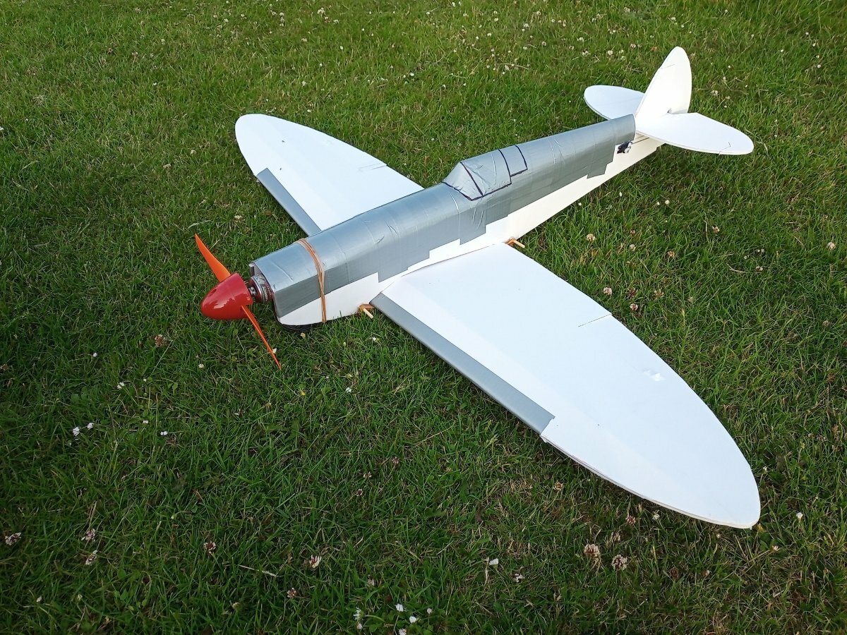

Managed three flights with two FT Spits. Spitfire No.4 (BT-K) went up first, so I could blow off the cobwebs. BT-K behaved nicely, although my attempts at aerobatics weren't great, so I didn't try much!

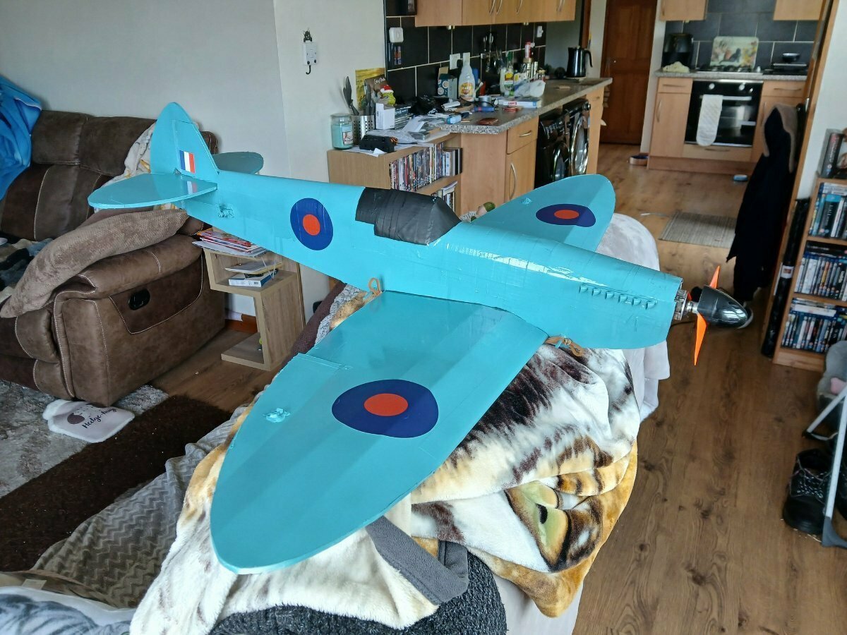

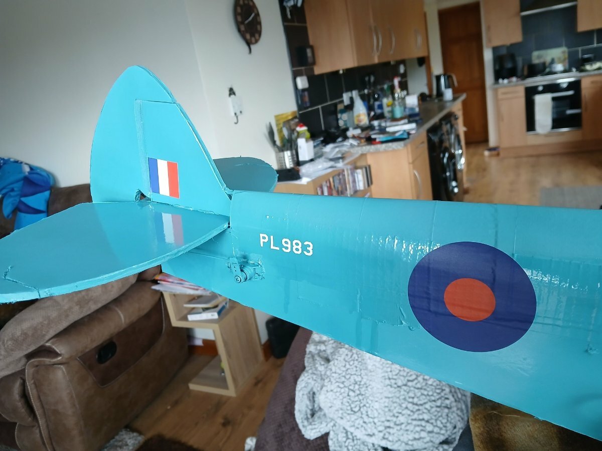

Flite Test Spitfire
in Foam models

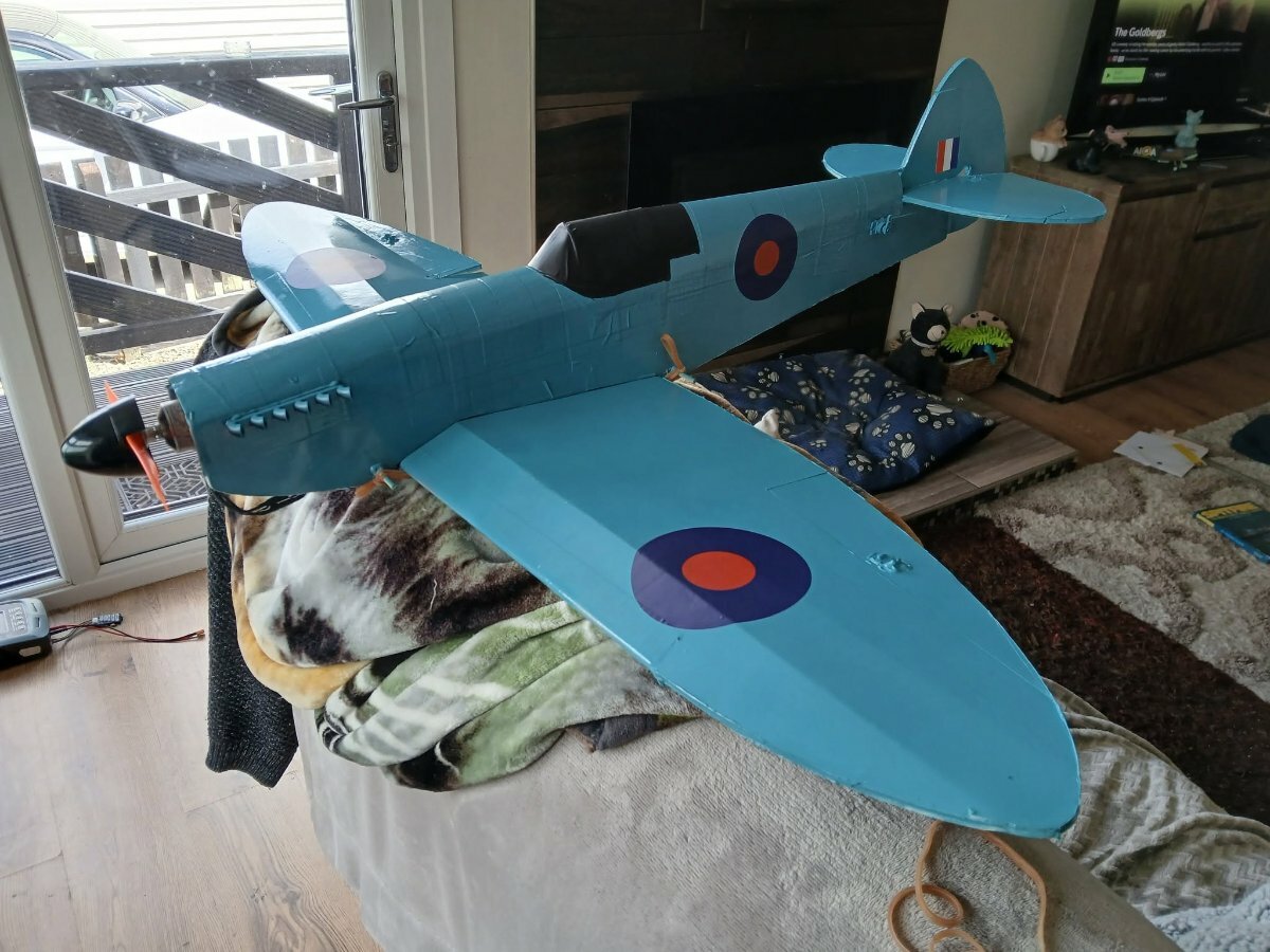

Aaaand done!
Paint scheme is based on that of Spitfire Pr.XI PL983, currently based at Duxford.
