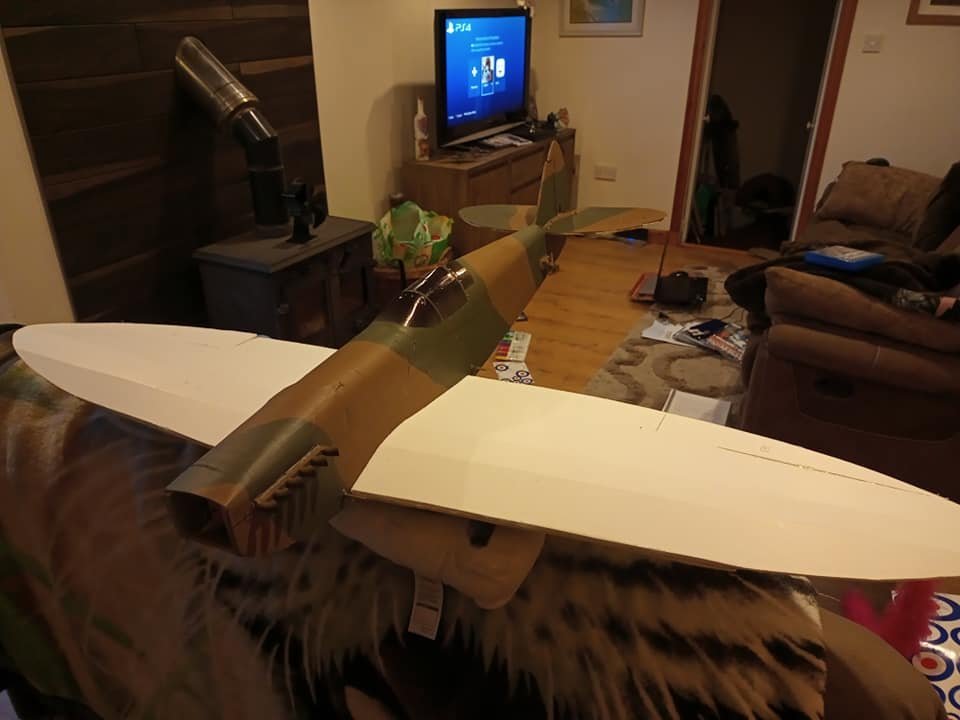

  3. Flite Test Spitfires breed like rabbits around here....!
    Haven't got to fly the camouflaged Spit yet due to the weather, but hoping that will change soon!  Had to remove the spinner as it was off-balance when I ran the motor.
    The white airframe (empty) weighs in around 353g.  The camo version is 858g fully loaded.
    • Like 1
  4. So, with the ESC, receiver and battery in it, we're looking at an AUW of 837g.
    At the moment, the plane balances on the second crease in the wing - roughly 85mm back from the leading edge.
    According to the plan, it should be something like 68.5mm.

    Anyway, here's the finished paint job.  I still need to put on the fin flashes.  Like I keep telling myself, this one is meant to be practical, not pretty....
