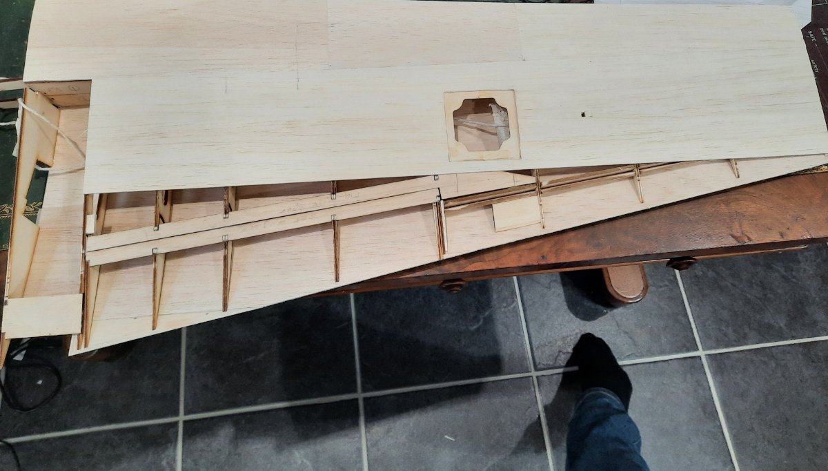

Yes Jon, you do need to trim it .If you look at the tip end and follow the profile you will see where the top sheet should end, take an off cut f 1/16" balsa about 3mm wide hold it on the edge of the top sheet and you will see approx. how much to trim off.
Hi Jon, flap area looks fine aileron ribs see to be a bit further in from the edge. don't take anything off the trailing edge if it is in a straight line from flaps to tip, sand the trailing edge lower sheet to a taper following the angle of the ribs the top should then fit neatly on .

Thanks Ron, I loaded it up from my phone to lap top then turned it on the laptop I did not save changes that is possibly where I went wrong. In the gloom there is a foot just to avoid a rubbish picture.

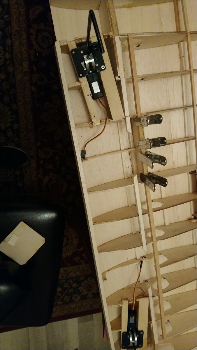

After much chopping and changing I have the Retracts where I want them. I had planned to put the rails in a line with the spar as the Seafury but that would limit the rake forward and as the Seafury is mainly depron it will be about half the weight of the Tempest. the wheels now are forward of the leading edge of the wing. I built the wing as per the plan making sure it was sitting on the jig tabs then left it over night next day I cut the notches out for the new main spar 14 mm behind the original. after that was firmly in place I cut through the original spar to create the wheel well. I am leaving the original spar in as well as the new one I think the extra weight will be ok and as only a small portion has been removed I can still put most of the vertical webbing where it should be. Now just got to make some 1/16" ply reinforcing plates for the ribs and try to get the other side to match.
