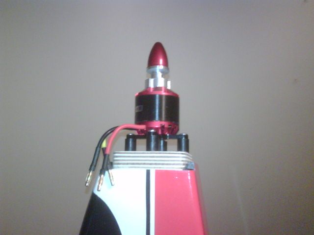

kal wise Posted February 14, 2012 Share Posted February 14, 2012 a year a go i converted wot4 to electric, the setup was XYH50-55 580kv Brushless Outrunner £24 ESC 60a === £16 5000mah 4s you can use 5s or 6s for this motor 4 std servo still flys very good, if you need help pls let me know. Quote Link to comment Share on other sites More sharing options...
Bob Moore Posted February 14, 2012 Share Posted February 14, 2012 Thanks for that Kal. I've pretty much finished my Wot4 conversion now with the gear as listed in this thread here Smaller motor and only 3300 mA 4s but it seems to shift a lot of air. I'm just working out how to push some air through the fusi to keep the 80 amp esc cool. I've seen the scoop on Chris Foss's design so will do similar. With luck I may be at the flight test stage soon Quote Link to comment Share on other sites More sharing options...

kal wise Posted February 15, 2012 Share Posted February 15, 2012 Hi Bob,I did not need any air slot as the esc and the motor barely got warm. I decided not to make any hatch/opening for the battery, instead access it through the top after removing the wings, I installed a switch to arm the plane from outside. How did you balance the plane with the 3300mah 4s? when I tried 3350mah 4s I needed 90g of weight to balance it so i went for 5000mah 4s Kal Quote Link to comment Share on other sites More sharing options...

Bob Moore Posted February 15, 2012 Share Posted February 15, 2012 Hi Kal I wish I'd made a similar access for the battery rather than done it the way Chris Foss suggests. Very awkward getting the battery in and out his way. And a bit late now having cut a hole in the bottom of the fusi. With my battery as far forward as it will go the model is just about level balanced. It's listed weight is 380 gms. Maybe I put my motor a bit more forward than yours. I've mounted it so the prop will be in the same place relative to the cowl. The rear of the mount is 43 mm from the original engine bulkhead. I'll add just a little bit of lead to make the model slightly nose heavy as I believe it's recommended? My esc does get a bit warm so I have made a cooling slot. Will possibly add a couple of small ones to the side as well for more ventilation too. I'm not sure how warm they should get? Quote Link to comment Share on other sites More sharing options...
Bob Moore Posted February 16, 2012 Share Posted February 16, 2012 Kal , you mentioned you fitted a switch to arm the motor. Because of the high currents involved I didn't think switches could be fitted. What type did you use? Quote Link to comment Share on other sites More sharing options...
Steve Hargreaves - Moderator Posted February 17, 2012 Share Posted February 17, 2012 Bob a Wot 4 is usually pretty tolerant of the CoG position so you may be OK with it as it is.....if you are doubtful in any way then add some weight....remember the saying..."Nose heavy, flies badly.....tail heavy....flies once"!!! Like a motor an ESC will always get warm in use.....how warm? Well if I couldn't touch it after a flight because it was too hot I'd be concerned.... Some people use a fuselage mounted Deans connector to break the battery to ESC connection & then just before flying insert a shorted Deans plug to bridge the connection.....might this be an idea....? Quote Link to comment Share on other sites More sharing options...
